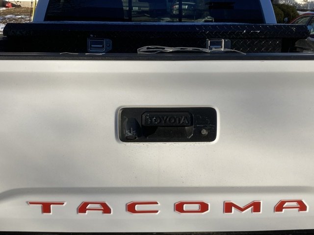

    But I did get this today.
    Red letters because I'm cool :D

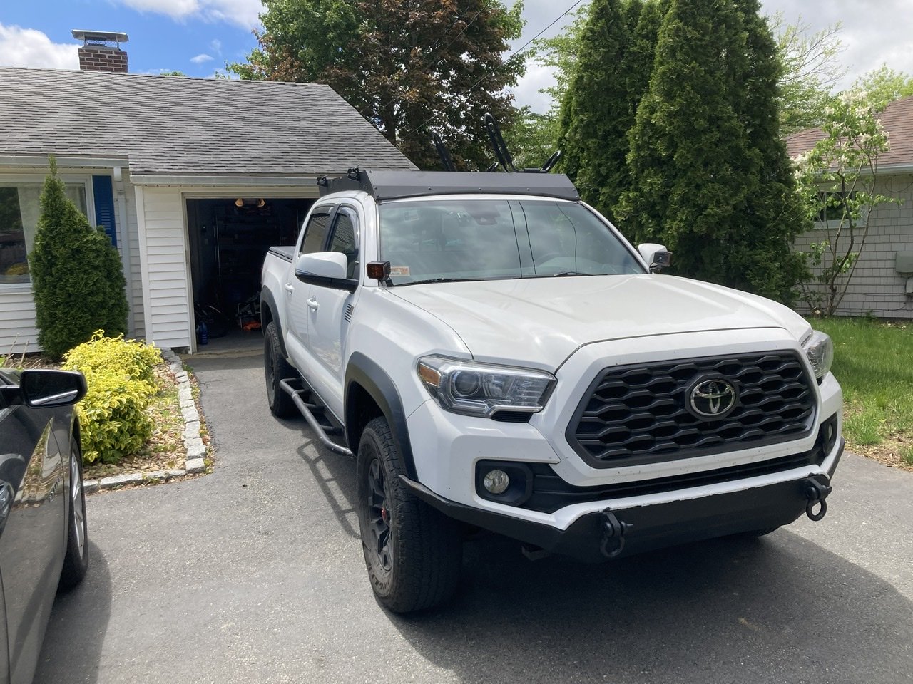

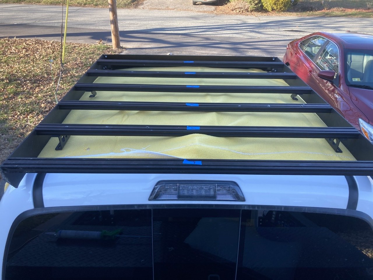

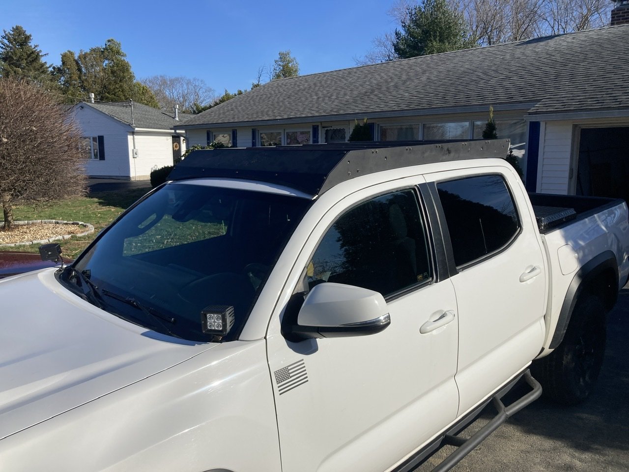

    Installed Cali raised roof rack.
    I was solo. So I put down an old blanket over the roof first, closed it into the doors to hold it down. I installed the bolts and stand offs with about 2-3 rotations, and then removed the blanket and positioned the rack. Silicone one at a time, shove it down into the threads and tighten down.
    Then tighten up all the other bolts holding it together.

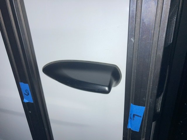

    The last picture is for us pre-february built 2020 guys. Shows the Cali raised positioning on the shark fin. This is why OEM rack won't work. Cali raised works. I'm sure prinsu etc are all similar and all work too. Plenty of wiggle room.

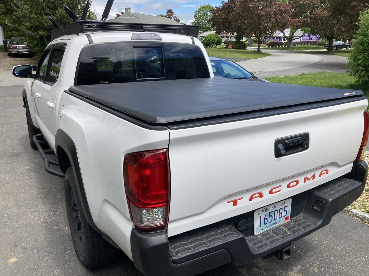

    • Tonneau - scored a soft tri-fold tonneau. Tool box wasn’t deep enough to store the coolers and dog food, unfortunately. So that went (actually, to the guy who did my bumper). Doesn’t work well with the bike fork mounts on the front rails, so it will probably be modular - only takes a few seconds to take on and off.

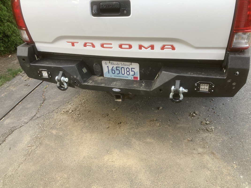

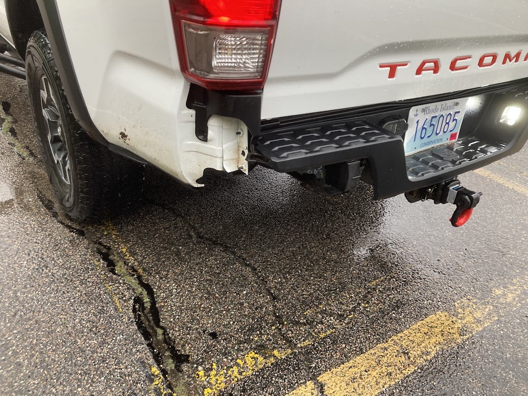

    Ripped off the rear bumper turning around in the woods.....
    The whole weekend I was bouncing off trees and rocks, etc etc. Nothing happened. I go up the trail to take a leak, turn around, fine the dirt, and ripped it off. Ooops.
    Chinesium Amazon bumper came in 2 days later. 500$ but "scratch and dent" it was something like 425$ delivered to my door. They touched up the "scratches" and can't even tell that there was an issue. Especially since I know what it will be used for, I wasn't that concerned anyway.

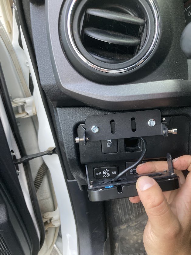

    Wired in as normal. Plenty of How-Tos everywhere. My only input - run the power wire into the cab, don't try to do it in the engine bay fuse box.
    8 Gang - it was cheap enough, and it was one of those "Why would I not spend 20$ more to have 2 more in the future just in case, when I can just do it now?" ... at the moment only 2 switches are occupied with definite plan for 1 more (just lights), and ideas for 2 more (Rear camera, horn relay so I can have an air horn on the highway, that one will take some thinkin' to get to, but it's an idea).
    Mounting it - I am not that fussed about this truck anymore. 50k on the clock, dented front steel bumper, etc. - it's a woods truck with character already.
    So, rather than deal with the BS of moving the TC switch - I left it there. Slapped some 3M zip tie mounts as stand offs. Self tapped it into the cubby panel (not the "main" dash"). From the picture you can see how I can still access the TC switch when the panel is on, and it can rotate to flip down so the lights aren't in my eyes (More on that in a second).
    I like the setup. Works well. I haven't bashed my knee off it yet.
    The Backlight
    So. There's a white wire that comes with it as well. My genius decided - that must be ground. So I grounded it. Turns out, that's the "Dimmer selection". Hit it with a momentary and it will dim the panel through something like 4 different light levels. So, that's my next move. I THINK I can just add it into the switch panel itself.

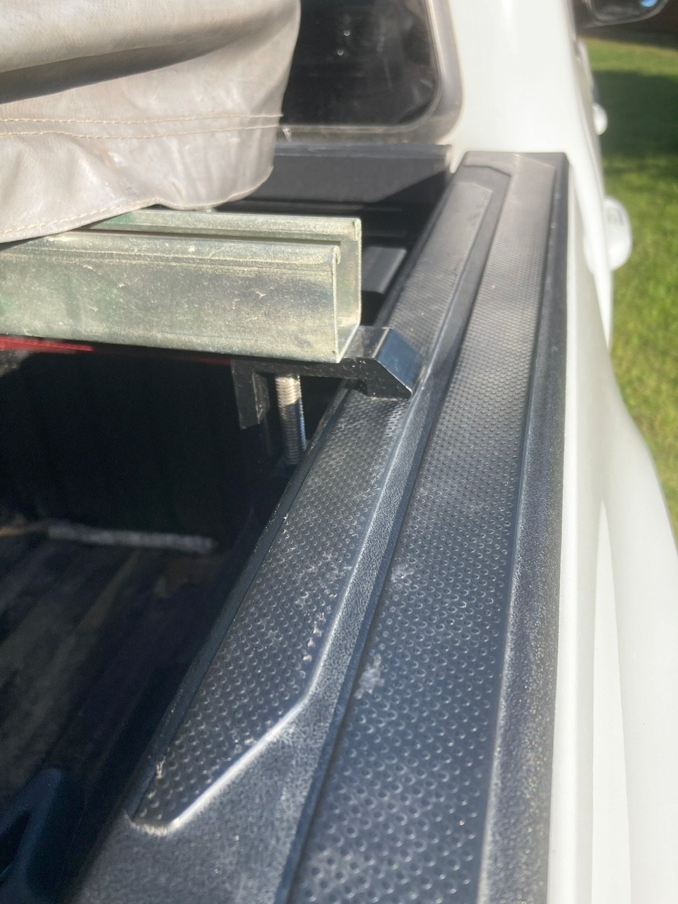

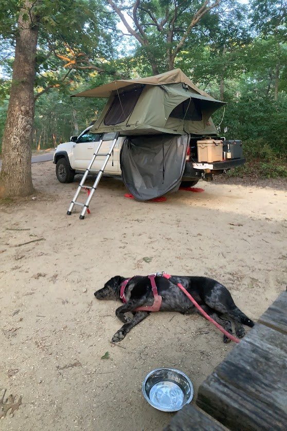

    So.....it happened......I have a rooftop tent.....
    RIJtT-C7_tTESeRWTmz9abOzBujpjiYttX3qhg3N_74c05a483dedd0357799737117466787485c9c74.jpg
    The cab setup is still there for when it's me, or me and the dog. However, when it's me, my wife, and the dog....there's just not enough space. My friend got this tent (actually from a user here!), didn't want to use it compared to a pop up, so I bought it from him.

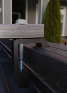

    Bed rack - I used some unistrut, clamped it down using these from Amazon.
    This is a picture from the amazon reviews.
    (I seem to be unable to find a picture of mine at the moment).
    It works. It's on there for when my wife wants to come camping. Chances are it will not be on there for the whole season, only the times she's with me. The cab setup is so much easier, AND I can see out the back window!

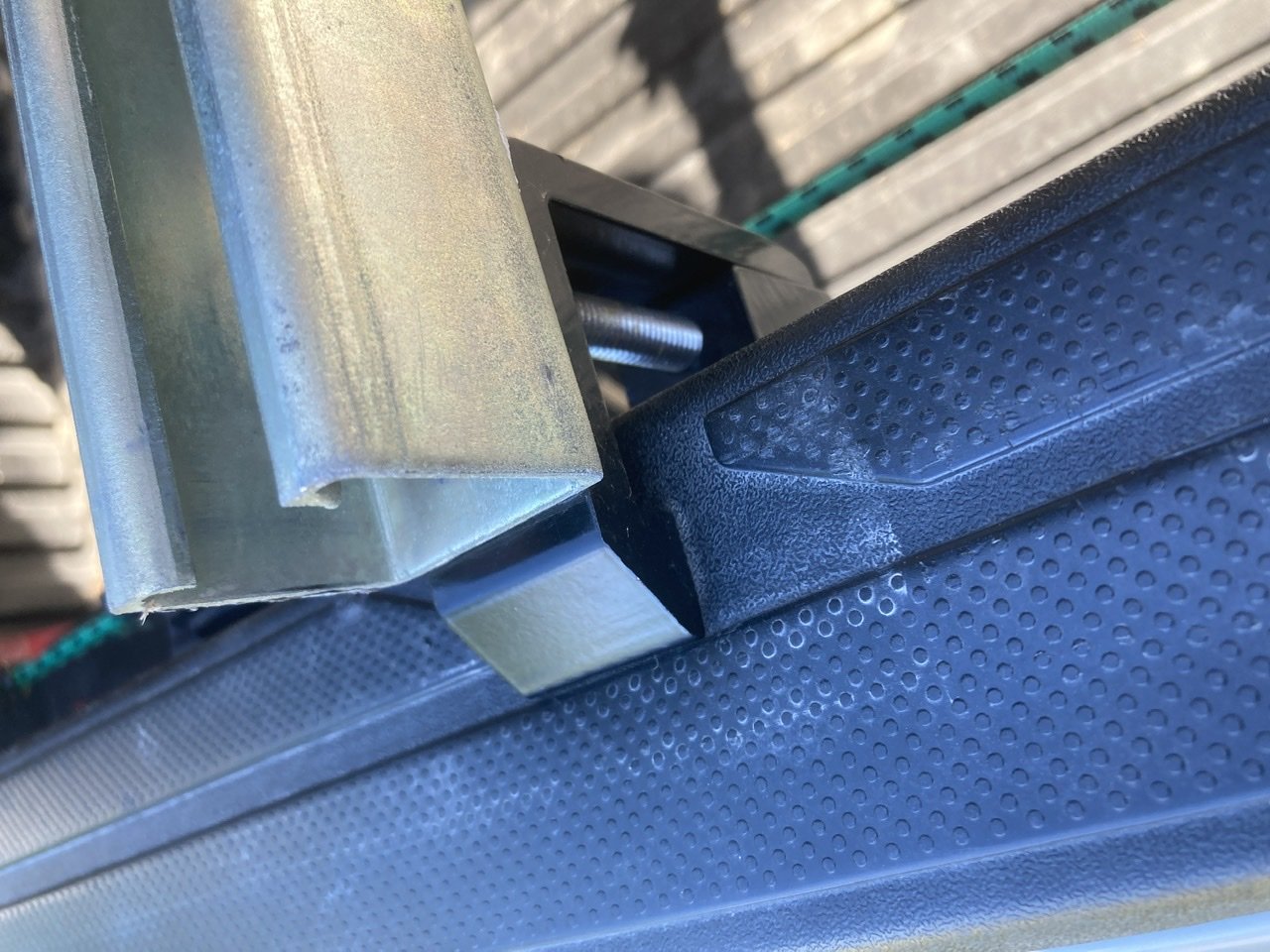

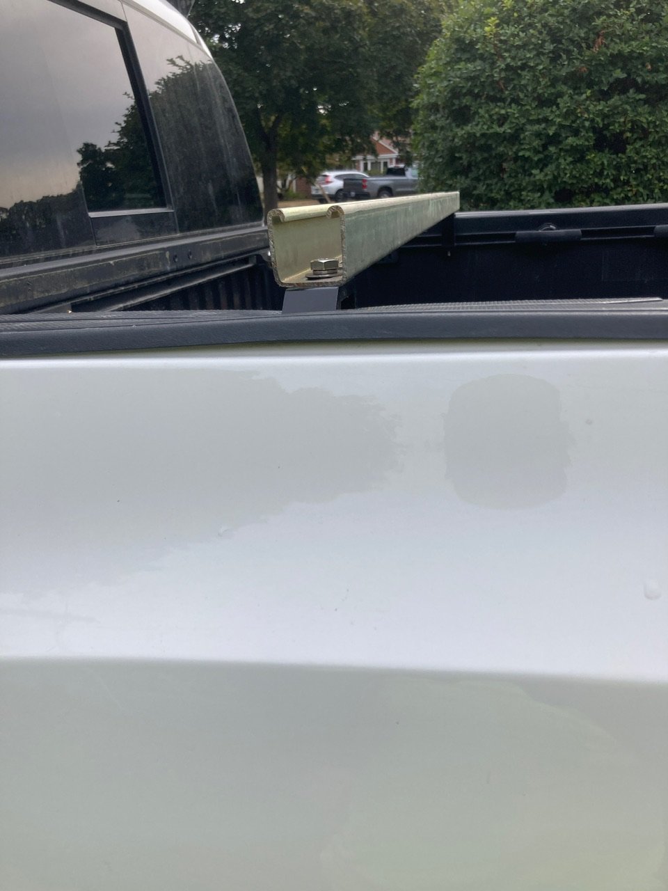

    My bed cross bars do kind of concentrate the load. I never felt unstable at all, but they push on the plastic. It's really important to know where the metal is on your bed sides for these.
    I've seen (and used) tool box tie downs that sit on the bed rail and grip onto the bed tracks, those might be better and have the unistrut sit directly on the plastic bed rails.
    Once they come off the bed rails go back to their normal shape no problem, but it was noticed.
