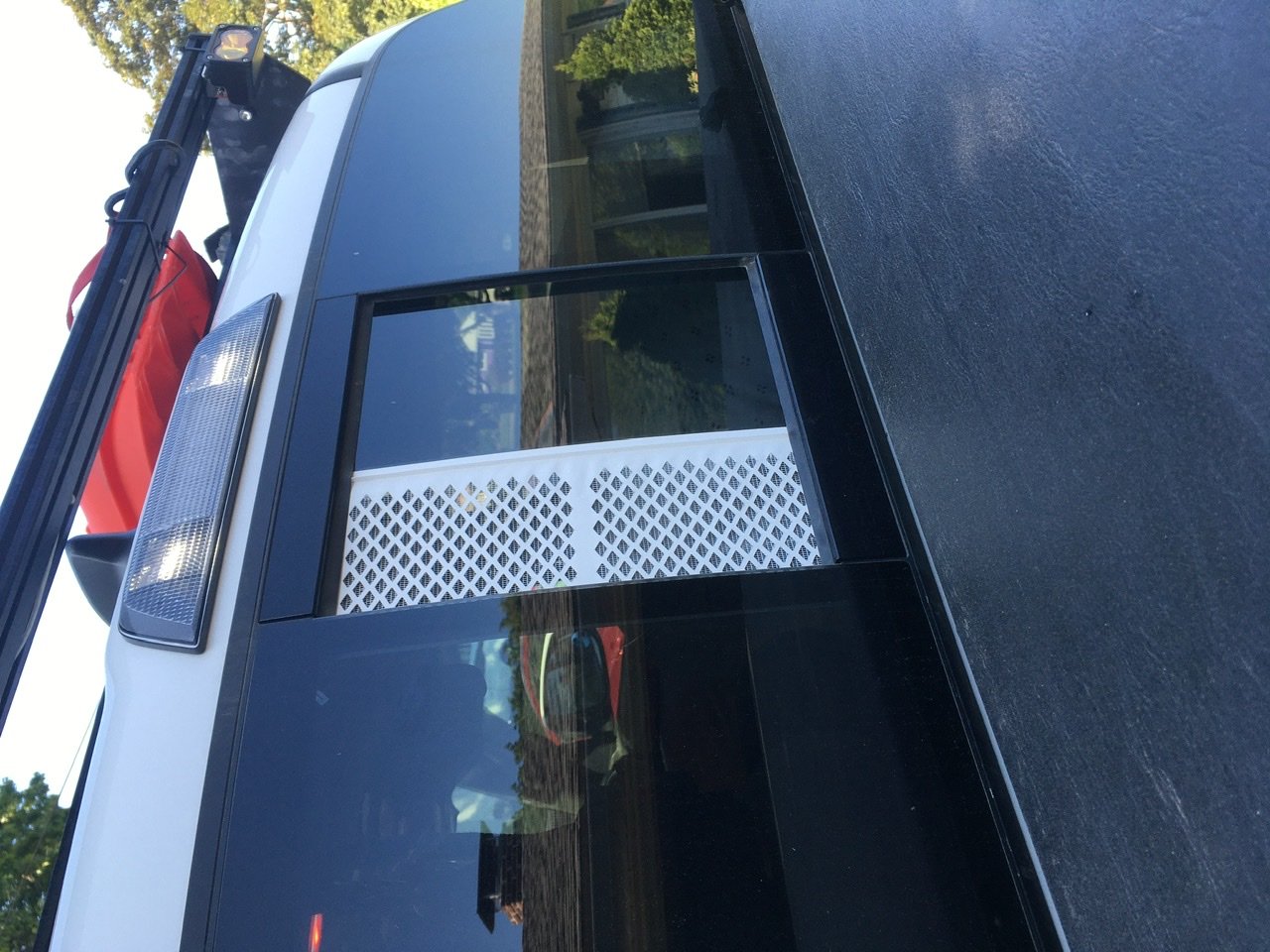

    Clip in gutter guard for rear window screen. Can leave window open without bugs coming in - should help with air flow for overnights! TBD on the rain protection but I'm also considering a pop up to put up over the whole shebang if I can find one cheap enough.

    Did you make it or
    Where did you find it?

    I wanted to give a "review"/tip on THESE things. They're great, they're actually kind of tight-knit and actually can be "restrictive" for airflow. I have a fan but without the fan they can heat things up in the cab if it's hot out. But they're pretty great for cab sleepers, cover the doors, drop the windows, wide open tent window!
    What I learned this weekend: they're a leak path in the rain. I've had them on in mist, light rain, etc before. This weekend the rain was dumping down on us Friday night, I had these on and the windows cracked (I have rain guards on), to get some air flowing. I learned - these will let water seep into the cab. :| it wasn't a lot of water, but it was definitely there.
