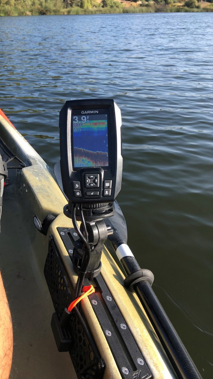

    total success!
    just went out on the water for 15 minutes and played with the buttons. got a small bass on a Ned Rig.

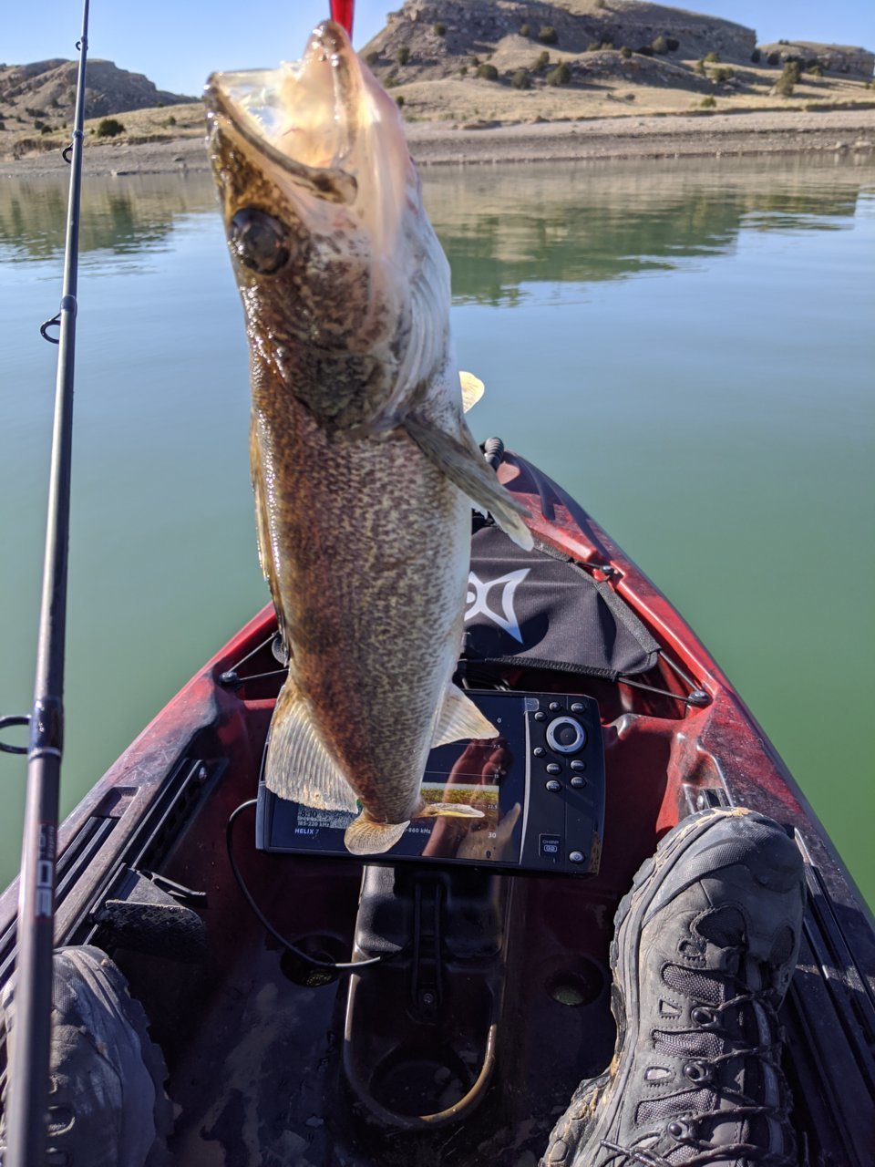

    I thought I had a picture on my phone of it but apparently not. My Humminbird Helix 7 will map the lake as you move around. It's a pretty cool feature and builds a full topographic map but is a slow process in a kayak.
