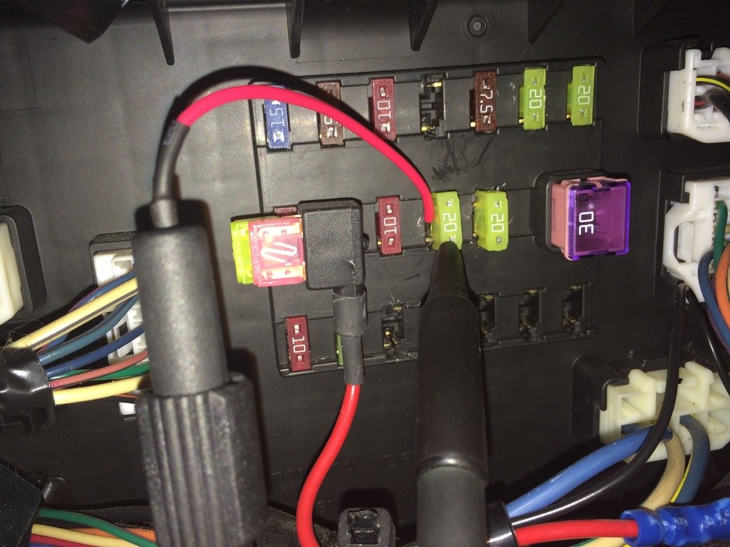

    I use the suction mount by the drivers A-pillar. Down at the fuse box I added in a "Add a circuit fuse tap" and added a cigarette plug down there. Ran the stock cable up behind the dash and out the A-pillar by the GPS. I had to use my stock wire as that contains the receiver for traffic updates.
    It is very easy to see here, no wires running all over the dash, very easy to remove for storage, and a quick install.

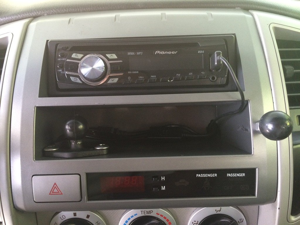

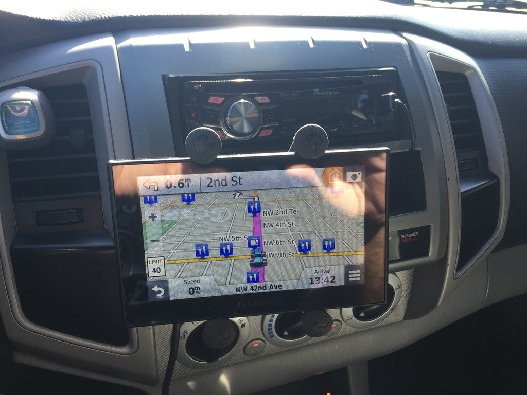

    Well I just bought my Garmin 2589LMT. I decided on the 5" screen since it fits well with my set-up now.
    When I hooked it up to my laptop it showed 1.50GB free of 7.02GB total. Is that normal? Seems awfully full. Do I need to delete anything> Will this slow down the GPS's reaction time?
    Also, Can I upload a pic & use it as an Icon? Right now I chose the blue pick-up in the menu.
    Still not sure if I will permanently mount it up or not. I may just use it in the location pictured on this post. I will definitely hardwire it though. I'll route the cable to come out of where my GoPro cable comes out of now.

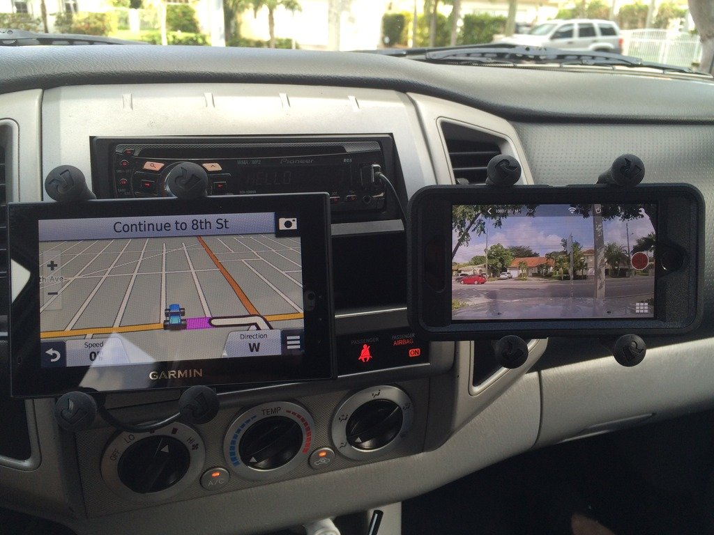

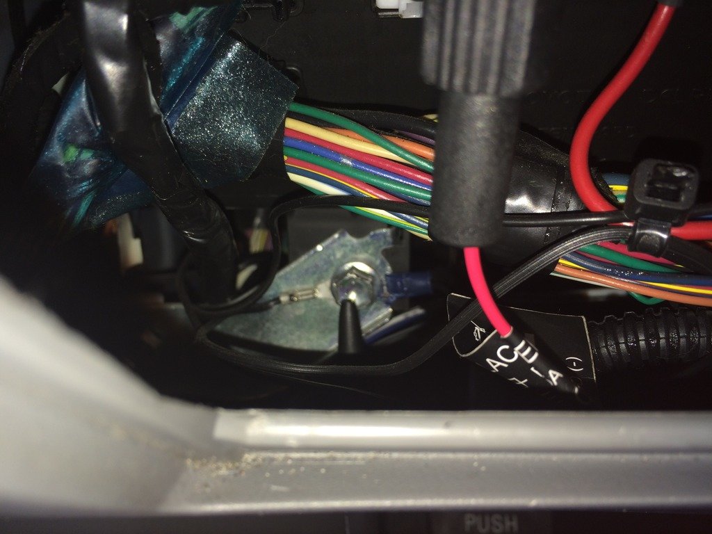

    Merry Christmas TW!
    Here's the final set-up:
    The cable going in front of my AC controls is power for my Go Pro
    The hardwire cables (according to the message on the GPS screen) isn't compatible with my device. I find that odd. It is a Garmin hardwire kit.
    All the other feutures work and I don't use the traffic option anyways so it's ok.
