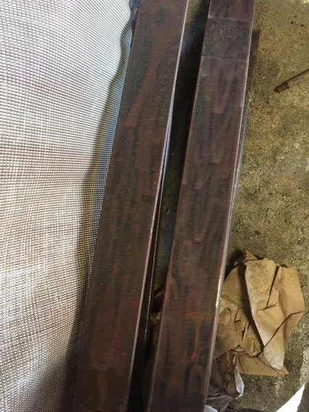

    Also put another coat on the leafs I had done. Need to start on the other two.
    Going to try the drum sander to sand out the eyes

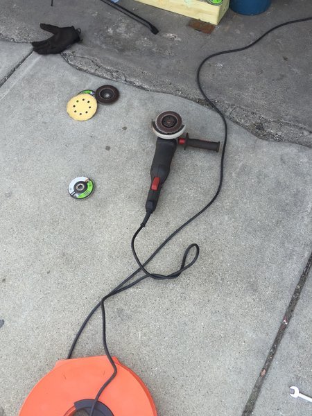

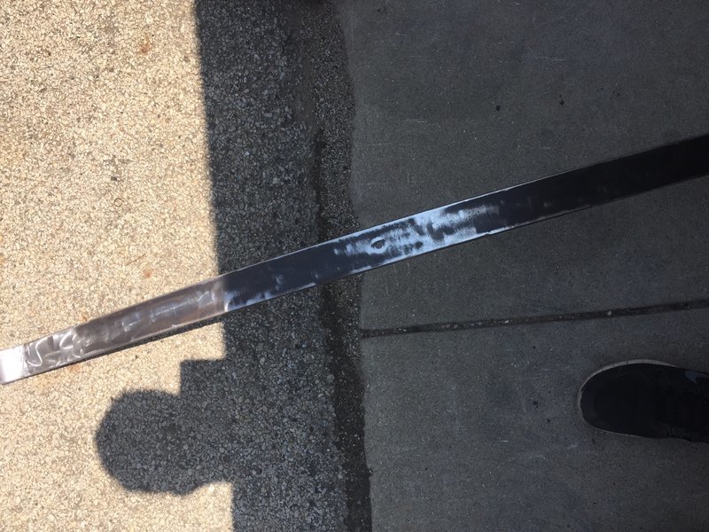

    Did some work to he big leafs today

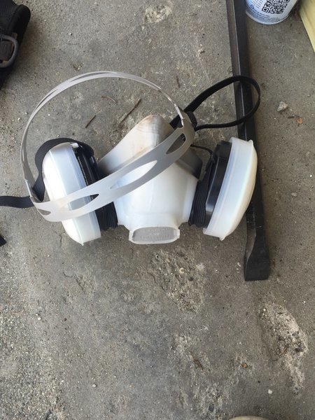

    Also if you want to do this I'm going to suggest a small hand sander. Got mine for $40 and an angle grinder with plenty of flap discs. I went through about 15 or so. Also get a mask

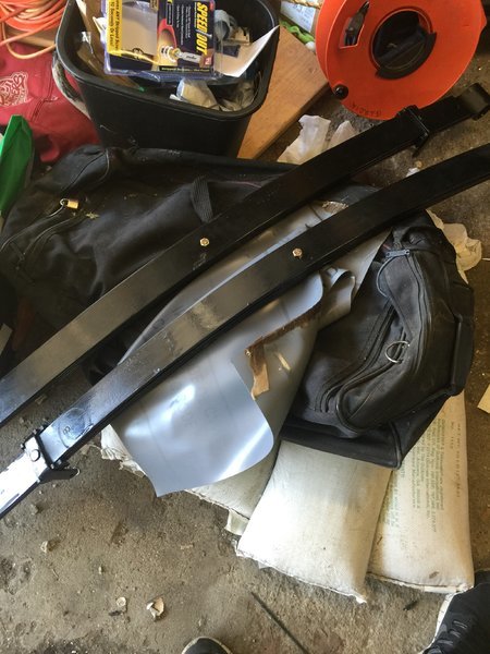

    This was the before. The top was in the middle then after painting.

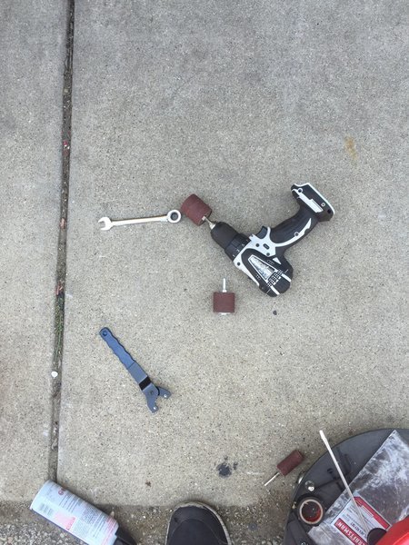

    Been getting quite a bit done. I've been painting as much as I can to get everything covered in the paint. Using more than I expected but it doesn't bother me.
    This worked great for sanding the inside "eyes". Make sure to get different sizes in order to cover a larger area and get the rust off.
    Like I said. A lot of painting haha

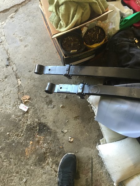

    Well after a lot of trial and error with different products and techniques.
    They are finished
    I decided to use grade 8 bolts and nuts. May throw a locking on on there as well to be safe or a different but. But they are done and the swap will be happening July 2nd.
