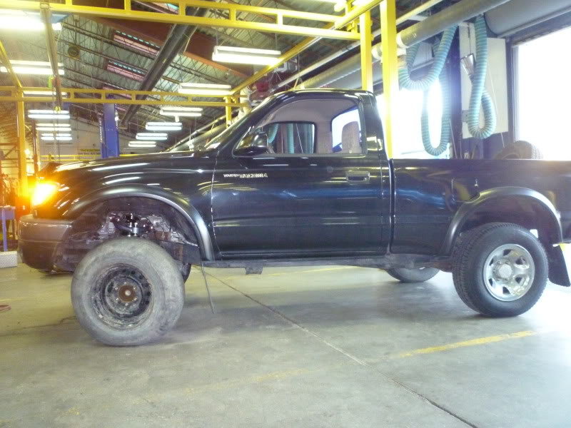

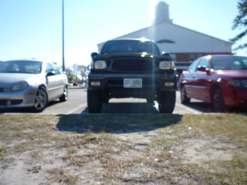

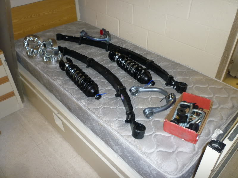

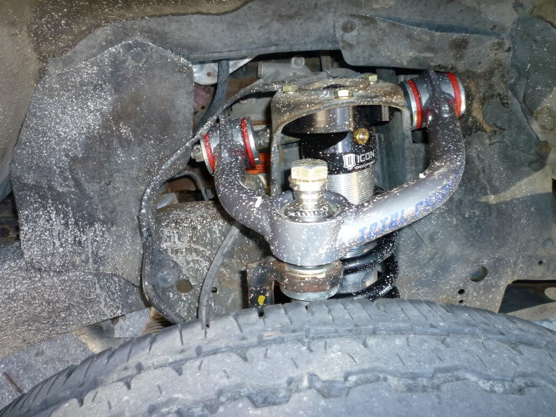

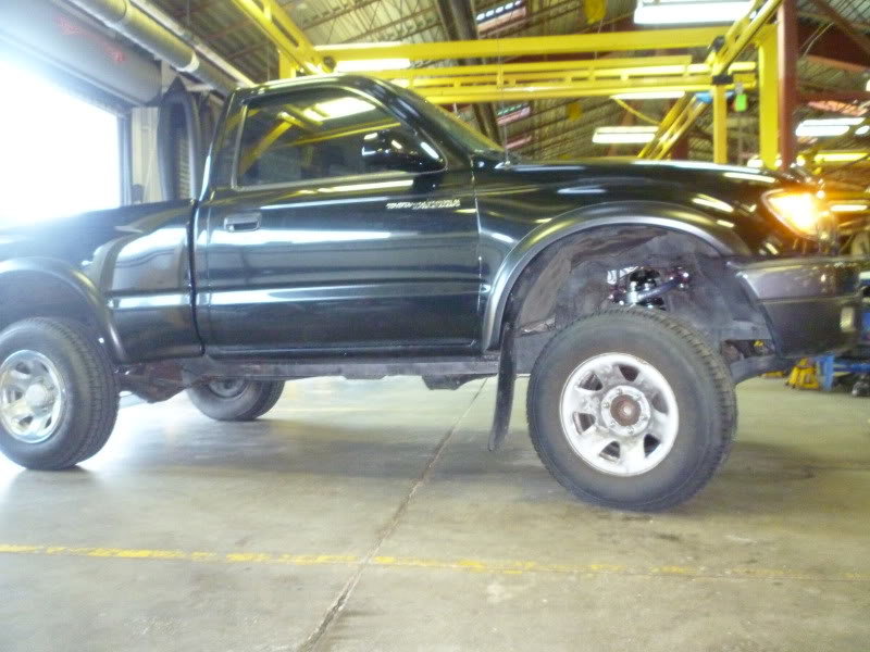

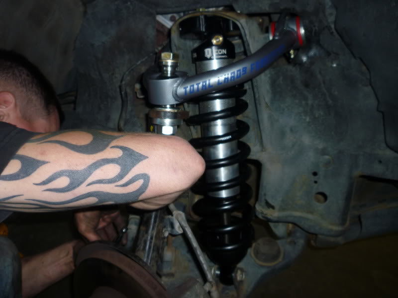

    Alright more detailed thread to come in the near future, but just put my UCAs and Coil-overs on today, and I want to share some pics.
    Woke up this morning to find my front drivers tire was flat, and the spare had no air in it. I was forced to drive about a mile to the auto hobby shop, and ruined the tire. So excuse the shitty bald spare in the pictures.

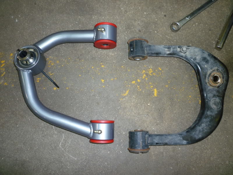

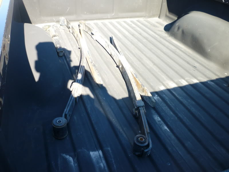

    Deavers leaf packs, TC UCAs, ICON coilovers, 1.5" wheel spacers.

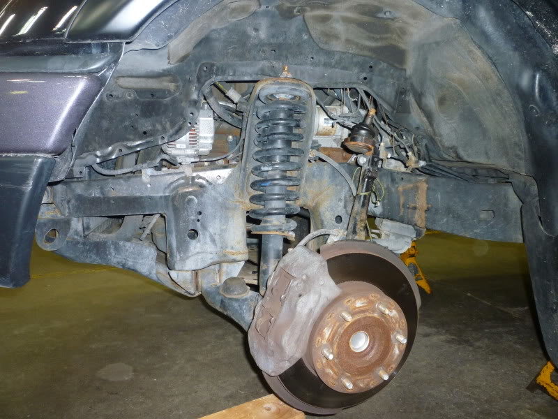

    Stock Components
    New vs Old

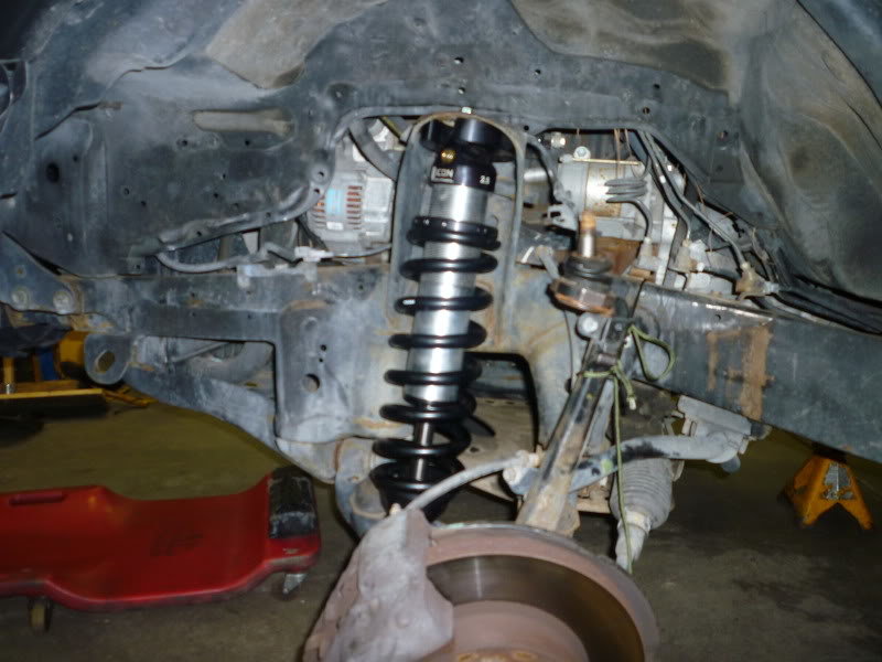

    New CO's on. Piece of cake.
    Drivers side assembled. I didnt have to bend the fender to remove the long UCA bolt, it just popped straight out. The Pass. side required some work to take out, but not that tough. The problem we ran into on the drivers side was removing the ball joint from the spindle. We ended up disconnecting the tie rod ends and lower ball joint, and putting the whole assembly in a vice, but realized what we were doing wrong. Spent around 3 hours on the drivers side, and 45 minutes on the passenger side. It was a shitload easier once we knew what to do.
    We bent the dust cover up a bit on the drivers side, so it currently is rubbing on the rotor, and making a horrible grinding noise. Im going to pop the tire off tomorrow and fix it, and maybe take a look at my back brakes. I cant imagine they are too bad with only 62xxx miles on em, but since they are squeeking and i just replaced the front pads about 3xxx ago, I might as well. Getting paid Tuesday night, so Wednesday will finally see my rims get tires put on, and I dont gotta drive around with the shitty stock rims. Trying to decide between 265s and 285s, because I have a 4 banger and dont want to regear or adjust my speedo if i can help it.

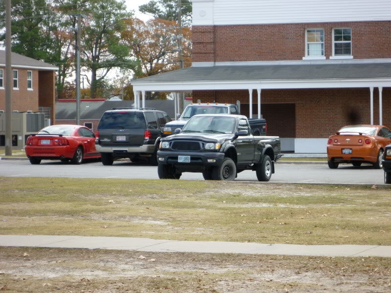

    My truck is sooo much higher in the front now though, and the coilovers can still go up another inch, plus if i got 285s they would be roughly 4.5 inches larger over all than my stock 225s. So I can still go up 3 more inches...
    Only took 2 and a half months, but its starting to come together.

    nice truck i like the bumper where did you get it?
  9. Nov 28, 2010 at 5:59 PM
    tacomazach
    tacomazach Well-Known Member
    Jul 31, 2010
    #41045
    782
    Zach
    Mississippi
    01 doublecab 4x4
    looks to be an allpro bumper
    OP great looking setup

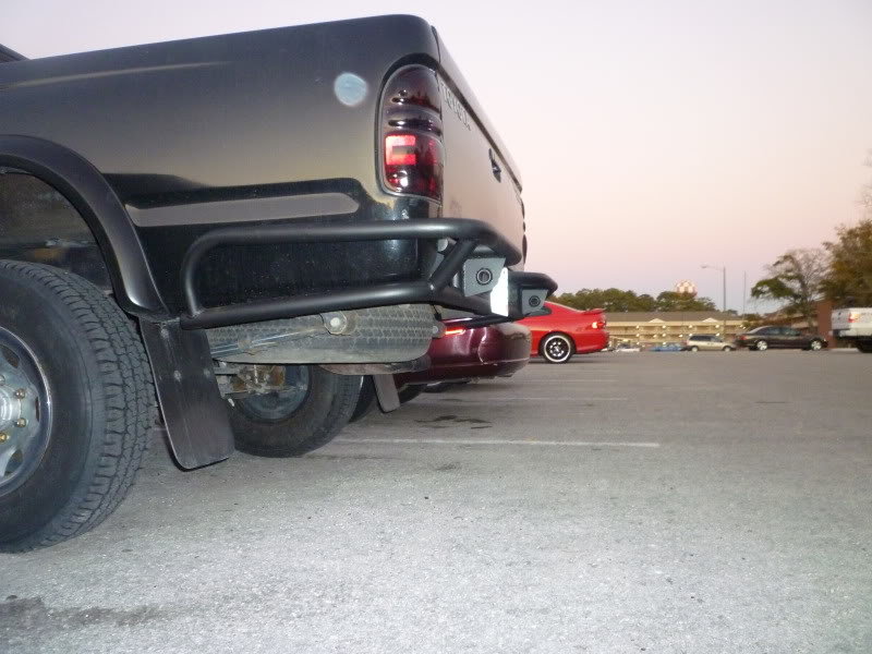

    Yes that is an All Pro bumper i got from the group buy a little while ago. I painted it with Rustoleum Spray on Bed Liner, and i am quite pleased with the result. You just gotta be careful and go SUPER light on the coats till you build it up, because it will run like crazy on even a medium thickness (which happened to me). I also have the Rough Country 1.5" fender flares on, and a K&N CAI kit.

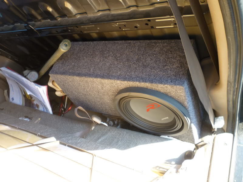

    Also have an Alpine Type R 10" behind the seat, and the doors are saw-zalled out to hold 6x9 speakers instead of the shitty 6.5s or whatever size comes stock.

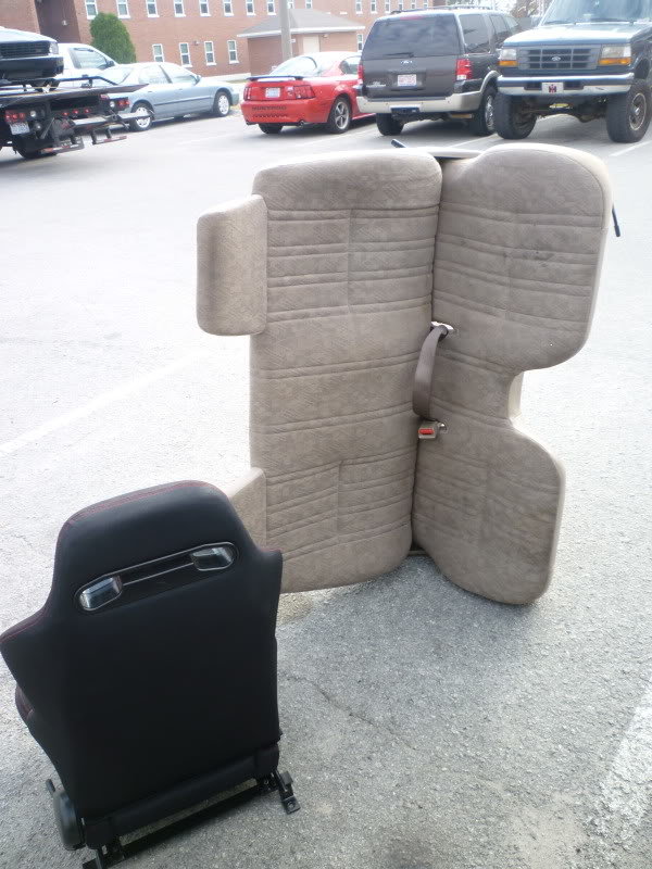

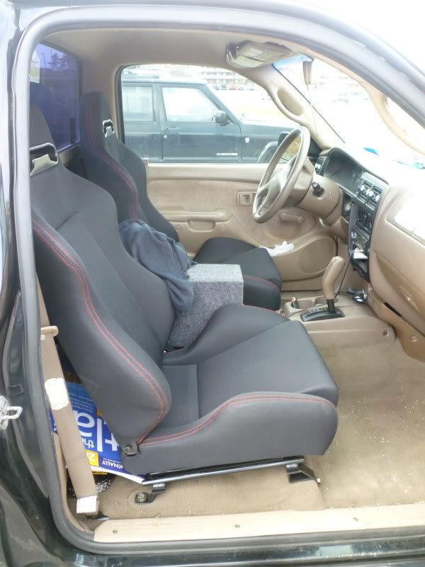

    Progress for the day:

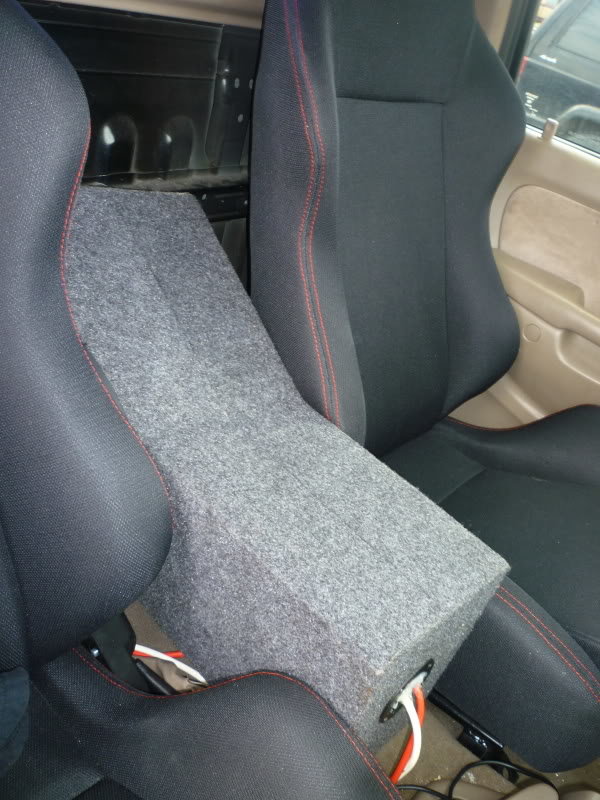

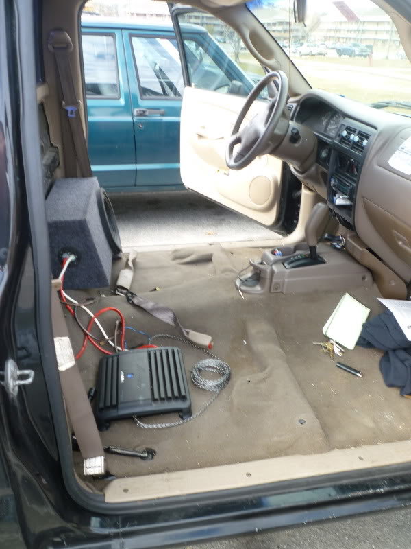

    Put the racing seats in today. Took about a good 2 hours, because the brackets were confusing to put on the seats. The heads of the bolts are too long, so it wont cycle forward and back the full length of the sliders... I debated cutting em down with my little baby hack saw, but decided to just put em on as is.

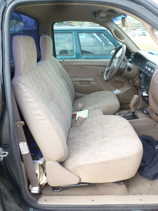

    Before:
    Bench seat taken out:
    (In the upper left corner you can see a 45,000$ Salen Mustang getting repo-ed while i was working... hahaha!)
    Sub sitting between the seats as an arm rest:

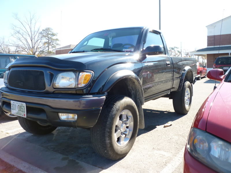

    And took some pics of the badgeless grill:
    Forgive the spare semi-flat tire on the front drivers side.... No money till wed. for new ones.

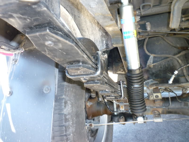

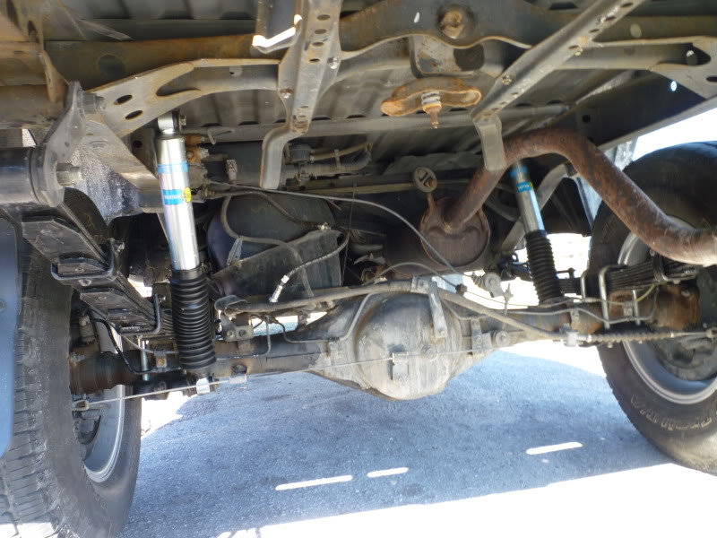

    And finally after about 2 and a half months of waiting, my rear shocks i ordered from demello offroad arrived. However, they were not the 5100's as advertised. They are the 5125's. Anybody know the difference? I have limited internet access right now and dont have the time to look it all up. And my steel braided brake line never came from DO, which is irritating, because i dropped 2 grand with them a long time ago, and i never recieved it. Also, even though it was not in the description of the ICON stage 2 kit, you would think that for 2 grand it would include a BPV, but again, no such luck. Anybody know exactly how far i need to drop it down? Ill just fashion something out of sheet metal.
    Enough of the ranting and raving. Im just happy that i finally got the shocks. Most likely the rear end components will get installed on saturday.

    Doesn't look like you are going anywhere with those seats in :thumbsup:
    The 5125's are longer length shocks so you got an upgrade as long as they mount up properly. I'm not sure about the 1st gens. Look at how it mounts to the axle and frame and make sure it matches the stock ones. If not you either need to return them or get an adapter. You may also need new rear brake lines with the extended shocks.

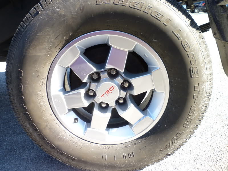

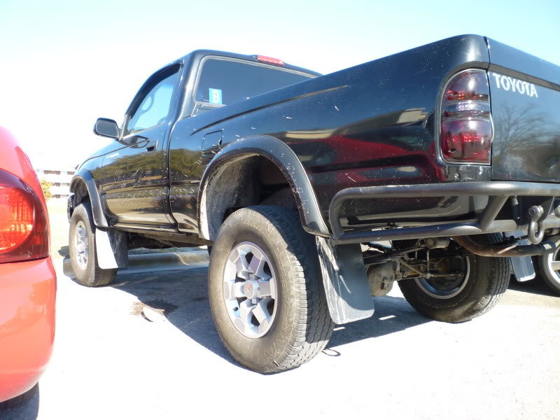

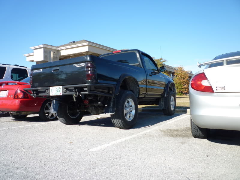

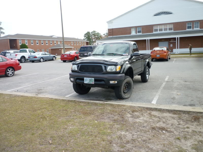

    Update. Tires, Rims, Leaf Springs, and Shocks have been finally put on!
    Overall probably 5 or 6 inches higher with the new suspension and tires. Finally the truck looks good. All i need is a new front bumper now... and maybe those 3" spindles.... and a 4WD conversion.... I guess its not nearly done.

    maybe i missed it but what kind of seats are those? mount to stock location? how comfortable?
