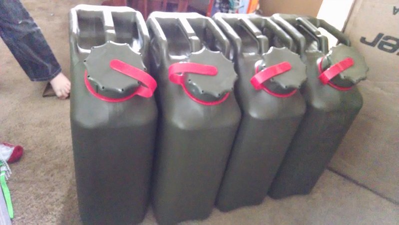

    I have a mowing business and go through alot of gas through cans. I HATE all the new no spill gas cans. They piss fuel all over the place, and take forever to pour out the spout. I have thrown away many of these shitty tanks.
    I see alot of the MotoCross guys with tanks like this...
    They advertise as a 5 gallon, but easily hold 6 gallons each. They do not leak at all! I can drain the entire tank in a minute, vs 8 mins with the other styles I had.
    I bought mine a few yrs ago, I believe I paid $60 for 2. Now I see them for $75 a pair, but I didn't search much.
    DustStorm4x4 and IronPeak like this.

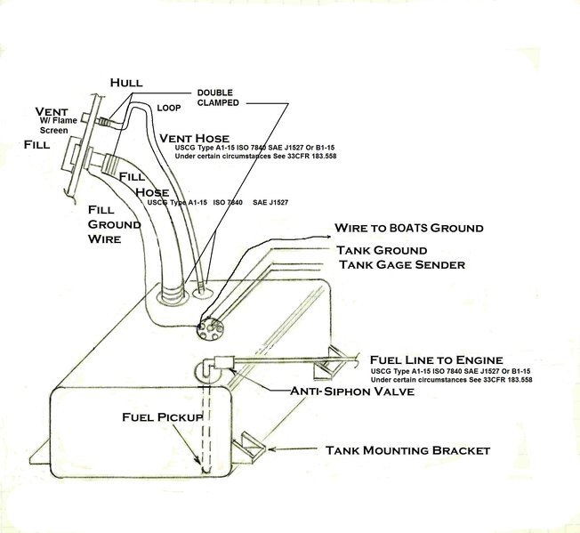

    For the plastic boat tank, I'd fill it on the ground. If that weren't possible, I'd have it hard mounted with metal straps to the bed and then, on the underside, run a ground wire from one of the fasteners to the frame of the truck. Granted, that's my opinion after getting bitten pretty hard by static built up in a plastic hose that we were transferring lube oil with on the ship. It arced a good inch or so, made a nice popping sound and hurt like a mofo. I solved the problem with a ground wire and clip that I connected to one of the hose fittings and a bare spot on the hull.
    Oh, almost forgot. For gas cans, I like the metal NATO style. I've used the CARB style plastic cans and I've given them all away or thrown them out. Haven't had a chance to check out the Scepter ones but that's the likely direction I'll go if for some reason the NATO cans stop working for me.

    So here is the diagram I found that best shows the boat ground scheme. The US Coast Guard basically requires each METAL part connected to the plastic tank and filler tubes - to be connected to ground.
    On a boat the USCG considers an outboard motor to be "ground" - Moeller's stuff says use the starting battery ground (and it would usually be connected to the boat engine). Some diagrams also show the ground to be routed under the double screw clamps of the filler hose. In order to be "two separate clamps" on each end the USCG says they can't touch each other.......?
