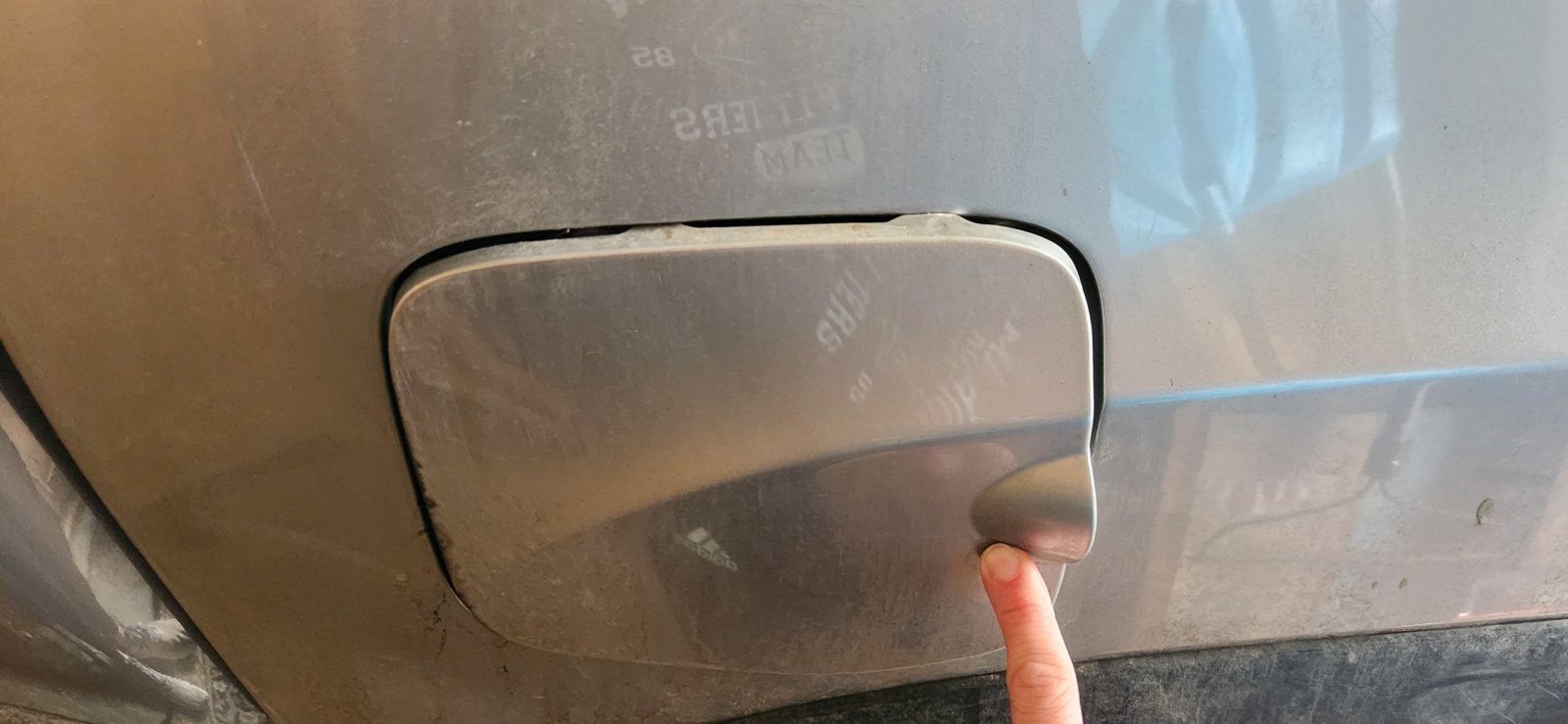

    Has anyone has this issue happen? I opened the Gas Cover to put gas in it, then when I went to close the cap, it was misaligned and really hard to close and springy. I tried spraying it with lubricant, but nothing has changed. It's also rubbing on the top inside where the cap meets the body. I didn't do anything abnormal to it or anything, it just happened and I'm not sure how to fix it.

    Looks like it bent those fairy-fragile tabs. Top one looks stretched out. I’d probably use a slat of soft flat wood to gently try to lever it back in position. These shitty doors! I hope the fourth gen’s is as shitty. Heritage.

    Door hinge is bent; common problem, silicon spray helps. You'll need to bend it back in place or replace parts.

    It’s a common result of neglect.
    If the hinge isn’t lubricated, it rusts, binds & the misalignment happens.

    Happened to my 2017 also. Tried to live with it, but the vertical pin broke, so I need a new door. I have it, just need to get the tools to install it.

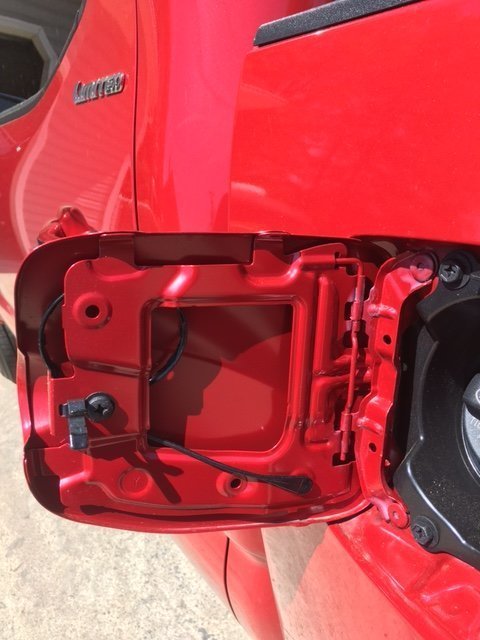

    Those cap holders can cause problems.They can cause warping the door and hinges.I disconnected mine.They do make cap holders for the door.
