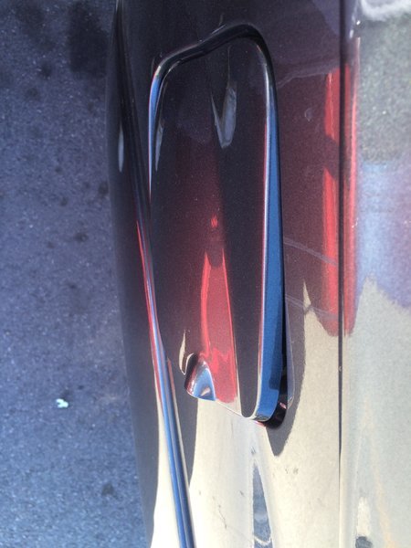

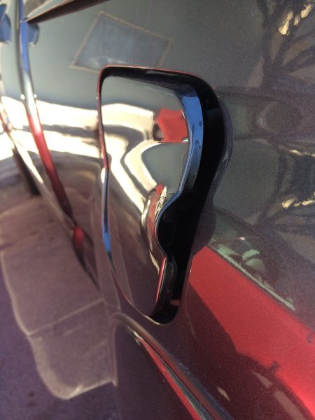

    Does anyone know how to fix this? If I press hard enough, the door sits flush, but then just pops out again after a bit.

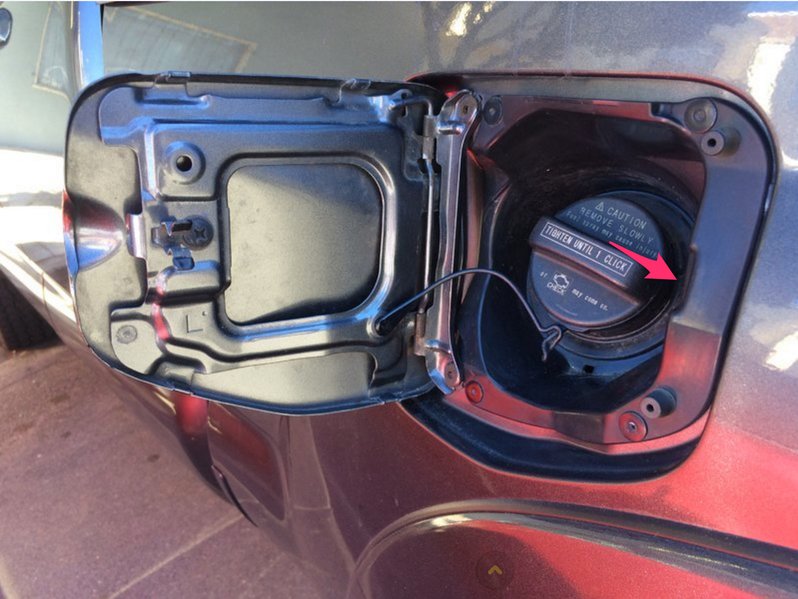

    @GHOST SHIP - I can check now.
    Would it be on the inside here? (see below)

    That's exactly where it should be. Small plastic piece. Since you're '11, it is possible that it broke after slamming the door over time. It really is a small fragile nub.

    @GHOST SHIP - Yep, there's an empty square hole there. Good call.
    Any idea if I can replace it?

    Been down that route.... Most likely what has happened is you have over extended the swing of the door with a gas nozzle at a station and bent the super cheesy gas door hinge. I had to bend mine back on my '06 but one day months later it broke off. For those of us who have fuel perks at Giant Eagle and regularly fill fuel cans to get every bit of that 30 gallons, the gas cans can easily over extend the door.
    FYI, if you do have to replace it, it's 2 parts .... Door in primer with the hinge, and the rivets, everything is separate. By the time you buy the door, that is if you lose it, get it painted, and put it on, you're at $100.

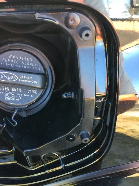

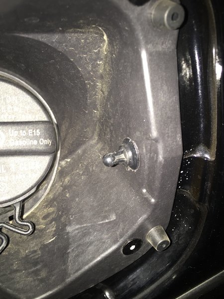

    Interesting. Would anyone be willing to snap a picture of the little piece? I'm wondering if I can jerry rig it...

    I have a spare gas door assembly

    I should be able to get you that part
