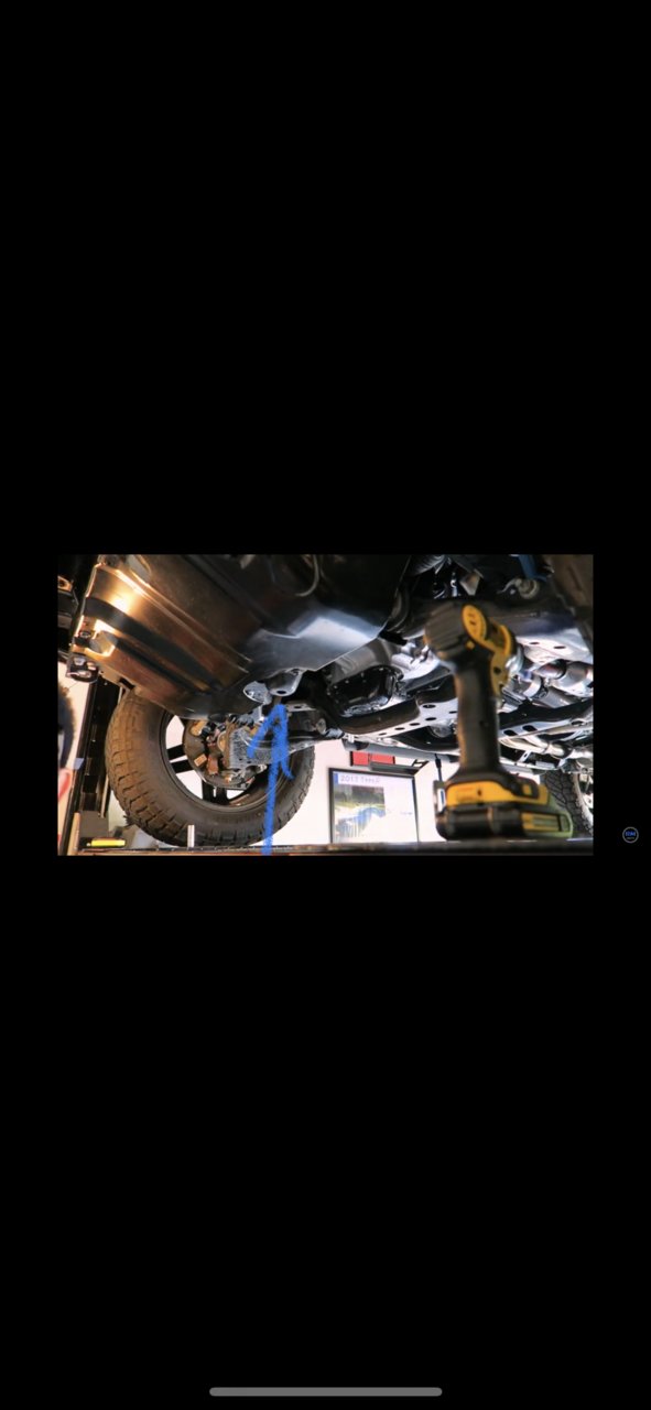

    I also dented the shit out of this little metal part under the truck. Anybody know what this part is?
    The road really wasn’t that bumpy but my truck was bouncing around like it was falling apart.. I’ve been off-roading plenty times before this felt definitely rougher than normal.

    Lol, the picture is another Tacoma. Was my failed attempt at drawing out the part of my Truck I dented. That round metal piece right under the skid plate. No idea what it is. I have stock tires btw :bananadance: need to change them out
