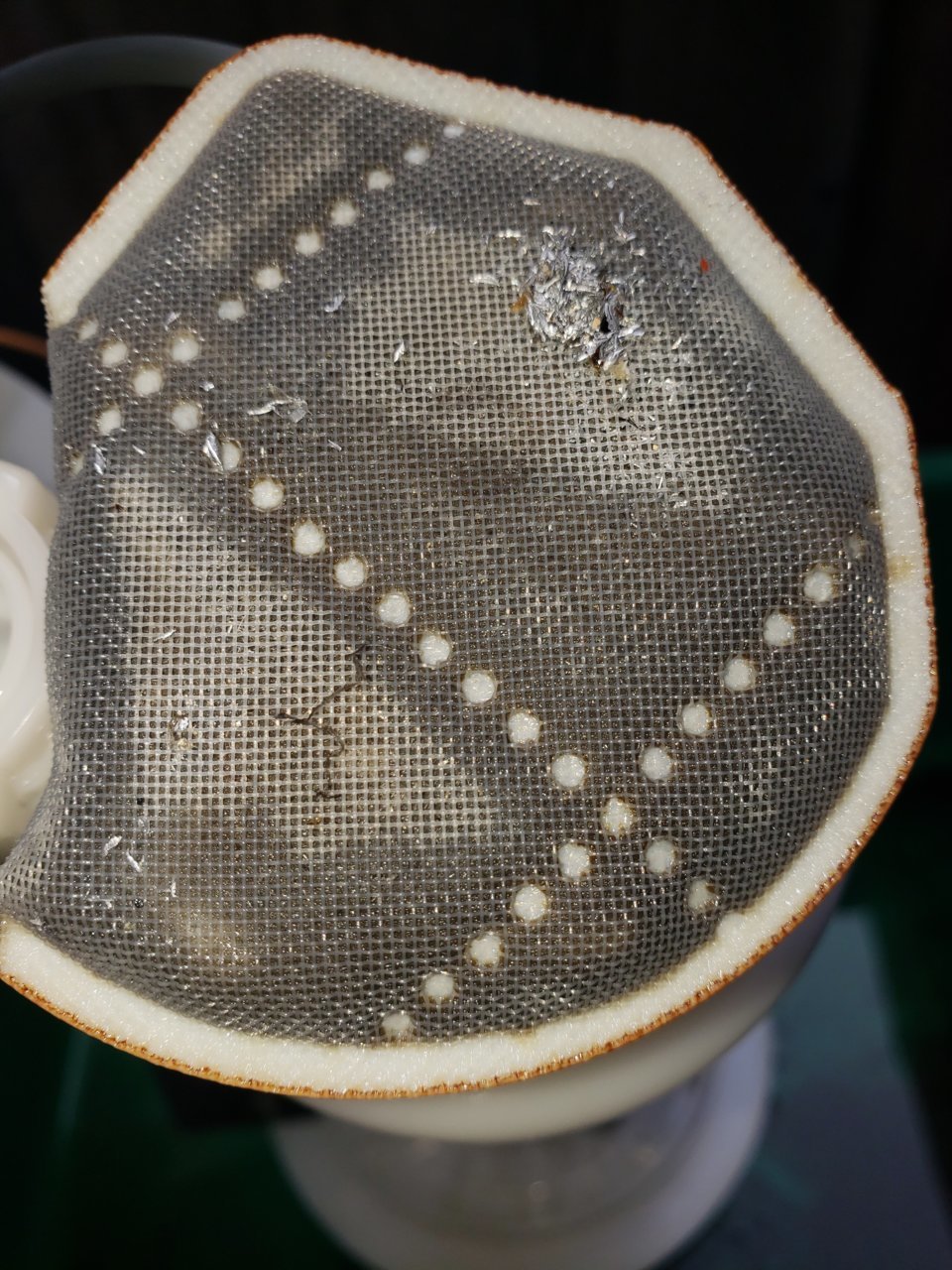

    #31
    1largemouth
    1largemouth Well-Known Member
    Mar 21, 2016
    #181964
    175
    Martinez CA
    06 Tacoma
    My issue was intermittent mostly going uphill it would feel like it was "cutting out" this is what I found.20181117_131108.jpg
  12. Apr 17, 2019 at 2:42 AM
    #32
    Newfiebruh
    Newfiebruh Well-Known Member
    Feb 7, 2018
    #243750
    945
    Tom
    2010 Black sand pearl access cab Base
    LED's, Tonneau cover, Fog lights, Front mud flaps, Cooper discoverer a/t3 tires, Tailgate reinforce, Cruise control, LED ditch lights, Bluedriver, 8-ball shift knob, Hitch, SR5 grille.
    What’s that?

  14. Apr 17, 2019 at 6:40 AM
    #34
    will.i.was
    will.i.was Well-Known Member
    May 6, 2018
    #252688
    1,711
    Will
    Houston, Texas
    SC 2.5
    Looks like the integrated fuel filter on the fuel pump assembly.
  15. Apr 17, 2019 at 7:30 AM
    #35
    1largemouth
    Mar 21, 2016
    #181964
    175
    Martinez CA
    06 Tacoma
    Yea that's the filter, I was happy to see that as I knew what the problem was.
    Newfiebruh[QUOTED] likes this.

    NONE YET
    This the filter in the gas tank?
  18. Apr 17, 2019 at 12:03 PM
    #38
    TireFire
    TireFire Superunknown Member
    Feb 6, 2016
    #177349
    7,666
    Olympic Peninsula
    The “filter” is just a sock around the pump, made of mesh. As seen in the pic above
    b_r_o and ROBBS-COMA[QUOTED][OP] like this.
