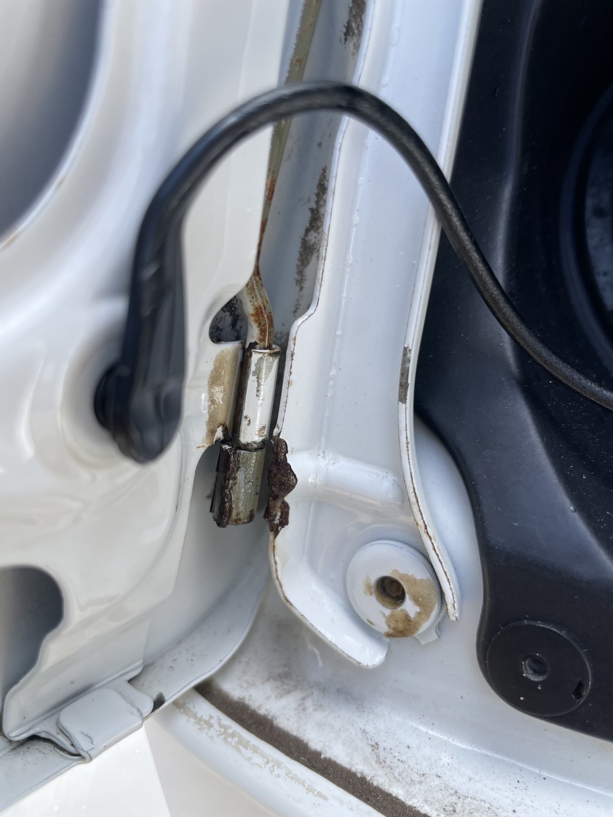

    My lower hinge of my gas door rusted and broke. I was thinking about trying to JB weld it back together and just let it set in place. Any other ideas on how to fix it? Thanks IMG_4654.jpg

  2. May 26, 2024 at 5:25 PM
    Tacoma Mike
    Aug 6, 2011
    #61230
    31,317
    Southern Maine
    Replace it. Will never hold.

  3. May 27, 2024 at 9:10 AM
    Macbugs23
    Macbugs23 Active Member
    Nov 8, 2014
    #141906
    40
    Ephrata, PA
    2006 Toyota Tacoma SR5 4x4
    Agreed. Mine did the same thing. Just replace and Fluid film it at least once a year.

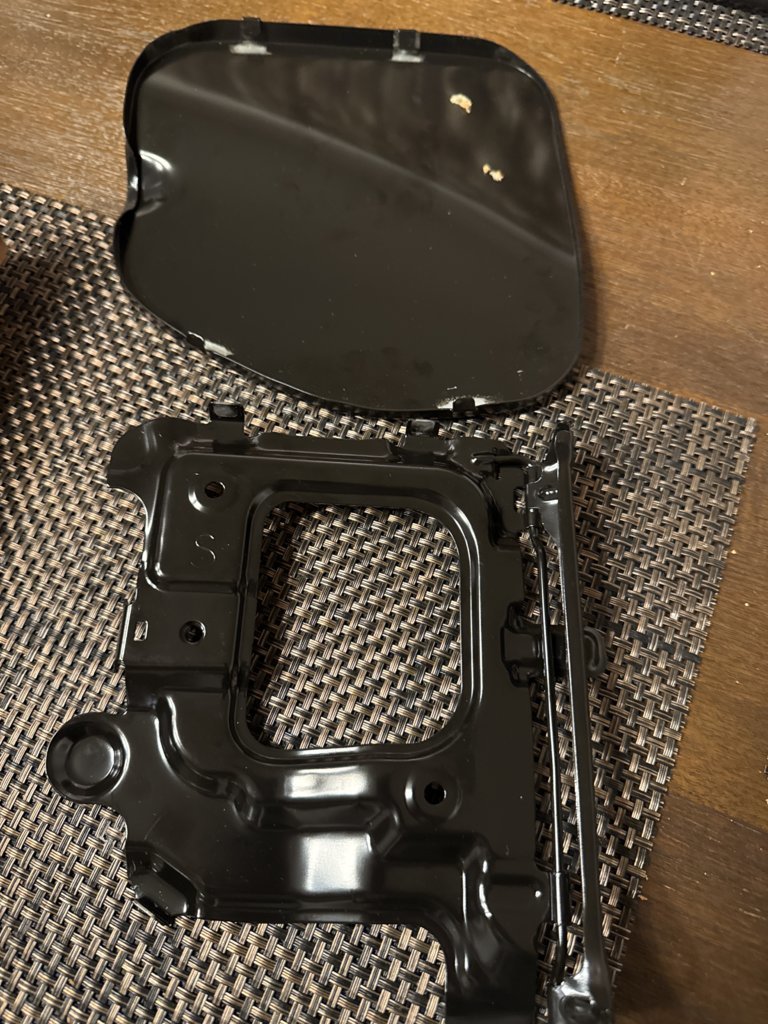

    Reviving old thread. My bottom hinge just broke.I kinda did it while cleaning behind it. Has anyone tried to remove the wire part of the hinge to separate the two pieces? My door is like brand new had the side of the truck resprayed after some moron decided to run a shopping cart down the side.was hoping to salvage the door and just replace the hinge
  5. May 26, 2025 at 3:56 PM
    Darty03
    Darty03 •‿•
    Jan 4, 2020
    #315159
    145
    2021 Tacoma TRD Off-Road V6 AT
    I think you would have to bend the door hinge enough to get it off of the pin. If you are able to do it carefully it might work out fine and swap over

  6. May 31, 2025 at 5:26 PM
    TACOMA2NDGEN
    TACOMA2NDGEN Well-Known Member
    Jan 24, 2018
    #242230
    1,994
    ROLAND
    new jersey
    2010 dcsb silver sport trd
    baja squadron pros
    Ok I successfully bent the tabs on the new one and got it into two pieces.now just have to do it again with the one on the truck

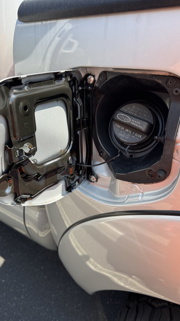

    I’ve lubed mine and paint matched it to hide the rust but it still rubs really bad on the bottom like the door is slightly bent. I want to replace it but it looks like such a herculean task
  11. Jun 3, 2025 at 7:45 AM
    Shawner1974
    Shawner1974 Well-Known Member
    Aug 22, 2020
    #338434
    86
    Shawn
    CNY
    2012 Base Tacoma 2.7. 5 spd Regular Cab
    It's not hard. I bolted mine on by removing the little cubby inside the bed and reaching through there. They sent rivets but I didn't have a rivet gun at the time.
