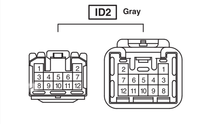

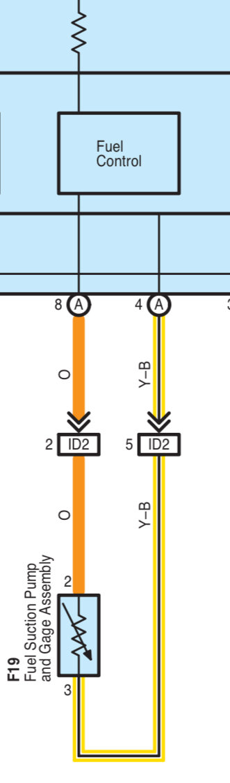

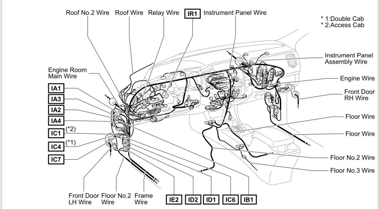

    @Dm93
    I see, I thought it was OP that figured it out.
    I guess I need to make myself useful here.
    I’ll add this in hopes it helps.
    It beats fooling around on top of the tank. And might be easier to get to.
    Find the the ID2 connector.
    Then do as @Dm93 said to diagnose the sending unit.
    Use pins 2(Orange wire) and 5 (Yellow/Black)
    701DC02C-712B-4303-A0D2-5D2AD38976EE.jpg 76820F55-E300-463F-A5B6-1BA1CE6CC7CB.jpg
