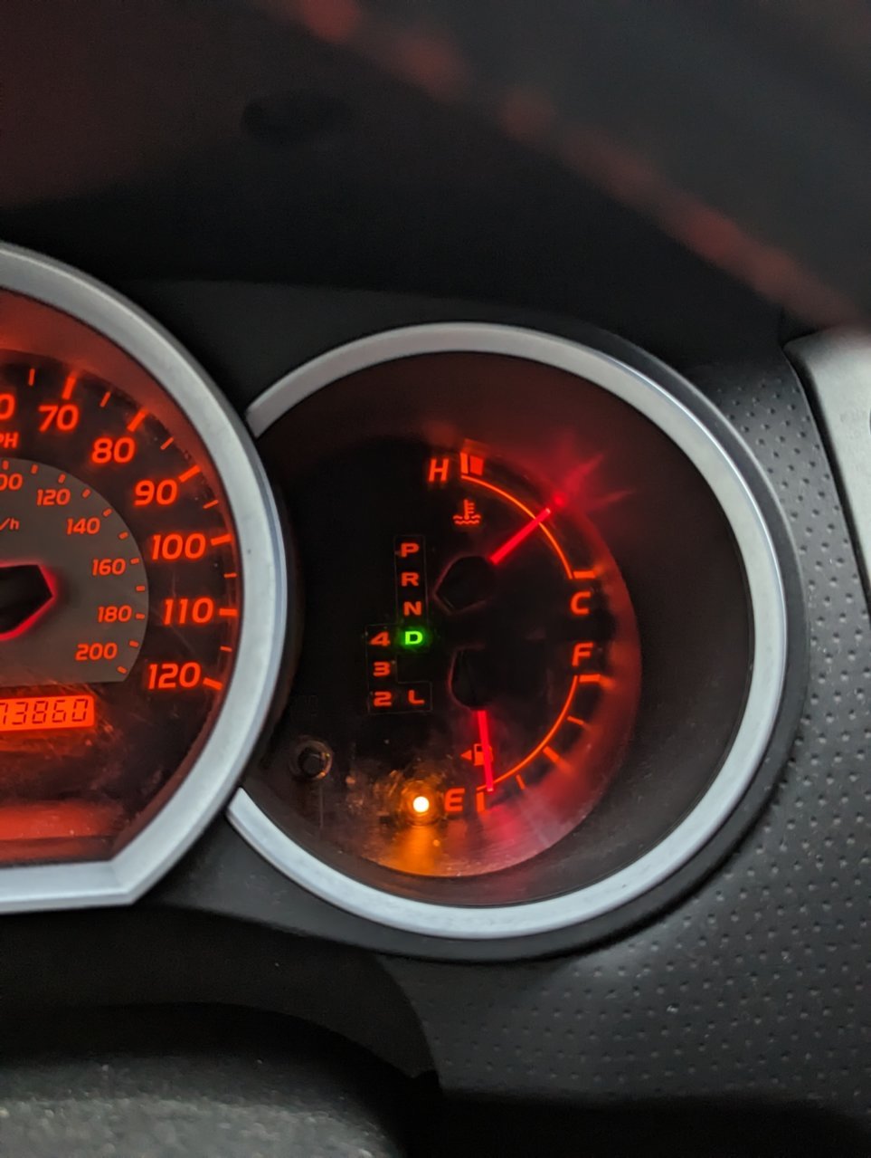

  18. Nov 27, 2024 at 2:49 AM
    #38
    Alittleofeverything
    Alittleofeverything New Member
    Nov 26, 2024
    #461305
    Just sharing my experience.
    Problem: Son's 2006 tacoma running out of gas due to inaccurate 1/4 Fuel gauge reading.
    Background: This first happened after replacing the fuel pump with an aftermarket pump/sending unit combo. We replaced the pump due to falling fuel pressure. This replacement resolved the fuel delivery issue. Since faulty fuel level reading happened sometime after replacing the pump, I figured it was a faulty pump/sending unit assembly. We then Replaced the pump/sending unit under warranty with same make and type. Fuel Gauge still not going below 1/4 of a tank.
    Current: Fast forward to week ago.. We noticed a fuel leak on top of the tank when tank was full. We suspected bad seal between pump and tank.. We were correct. So we bit the bullet and bought OEM pump.
    Results: The OEM replacement fixed our fuel leak, but fuel gauge reading is still at 1/4 tank. We tested resistance of sending unit prior to inserting new tank. All values at Empty, 1/2 and Full were within spec. ( The previous pump was also within spec ). When we connected it all back up, the tank was empty and fuel gauge still read 1/4. This is so deflating. We poured in about 4.5 gallons.. still at 1/4 tank. We put in another 5 gallons... tank reading at 1/2 tank.
    Key Takeaways:
    1. Always go OEM with fuel pump/sending unit assembly. Buy the fuel lines also if this is an old truck and this is the firs time.
    2. Be careful when taking the evap hose the top of the tank. It's difficult to get to and if you force it, you may break a 50 cent retaining clip. You can't buy the rings. I did rig up ring and it works. I would recommend taking the hose off from the charcoal canister. More accessible by dropping spare, unclipping a harness, temporary remove a hose and you can reach the evap hose.
    3. Be careful with the electrical plug on top of the tank. We accidentally dislodged a pin on the top when plugging it back in and didn't notice it. This was weird. We could hear the pump turn on, fuel gauge reading ( still inaccurately of course ), but the truck would not start. We checked fuel lines and no fuel was coming out.. even though pump was running. So we dropped the tank and saw a dislodged pin in the plug adapter. Secured it and buttoned everything backup and voila.. truck started.
    4. Fuel Gauge misreading not always the sending unit.
    Next Steps:
    1. Drive truck down to 1/8 of tank (estimate) based on mileage used. Check resistance of fuel sending unit via a wire diagram.
    2. Check Resistance at Fuel Gauge Cluster (It's not likely, but possible ).
