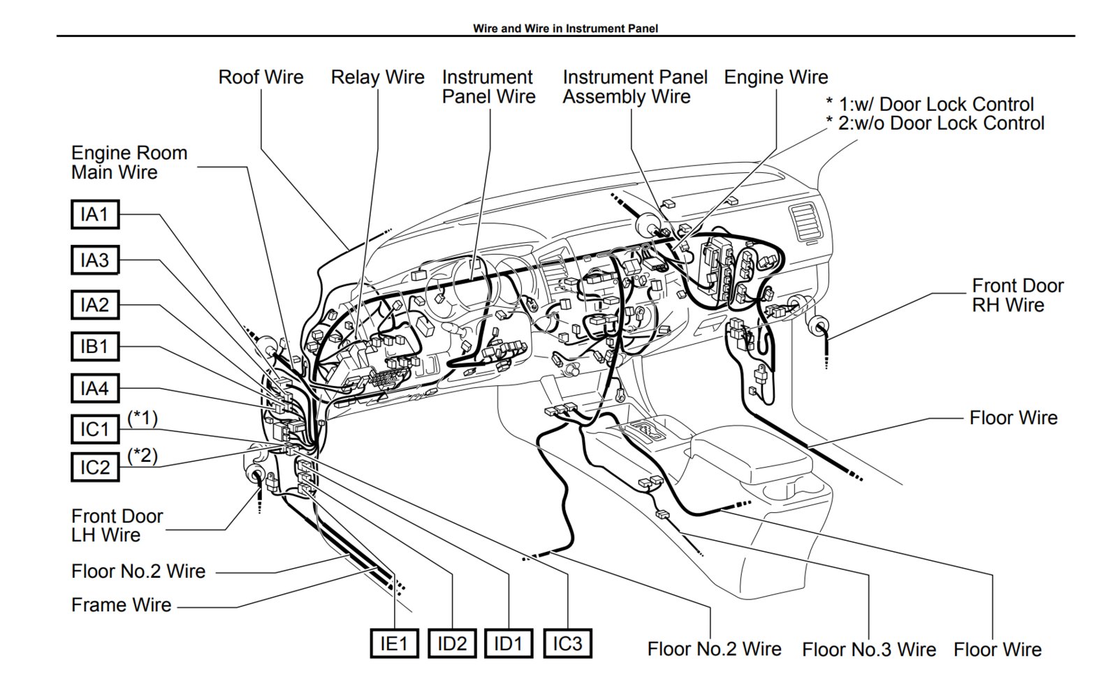

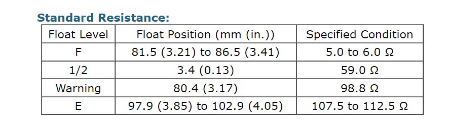

    Looks like you replaced a lot of parts.
    I'd be checking resistance at the gauge cluster (pins 8 and 4) or ID2 connector. (pins 2 and 5)
    Fill the truck up with fuel, check the resistances.
    ID2 Connector
    Gauge Cluster Connector

    In that case, run it until it on 1/2 an do the resistance checks above.

    Have you verified the resistance of the sending unit is correct as @TnShooter posted above?
