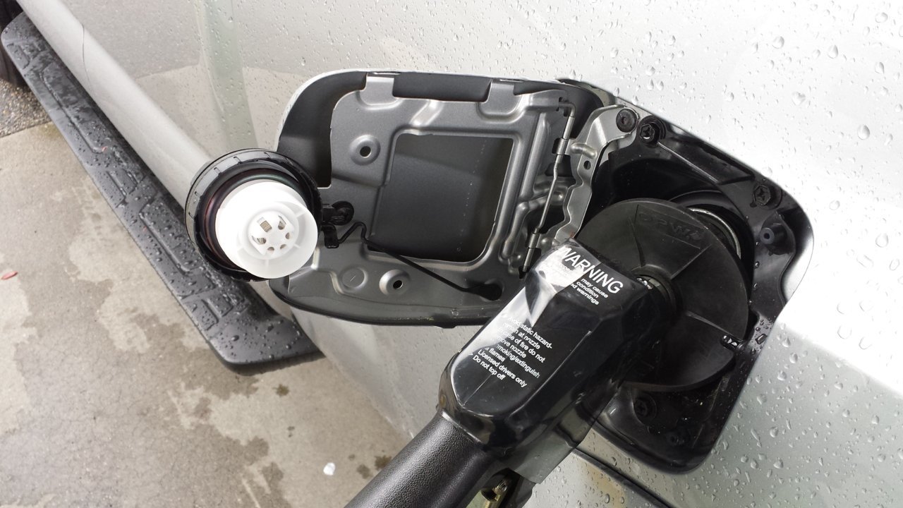

    I'm not saying I won't ever buy a gas-hole, but they have limited availability. For now I'll keep doing this:

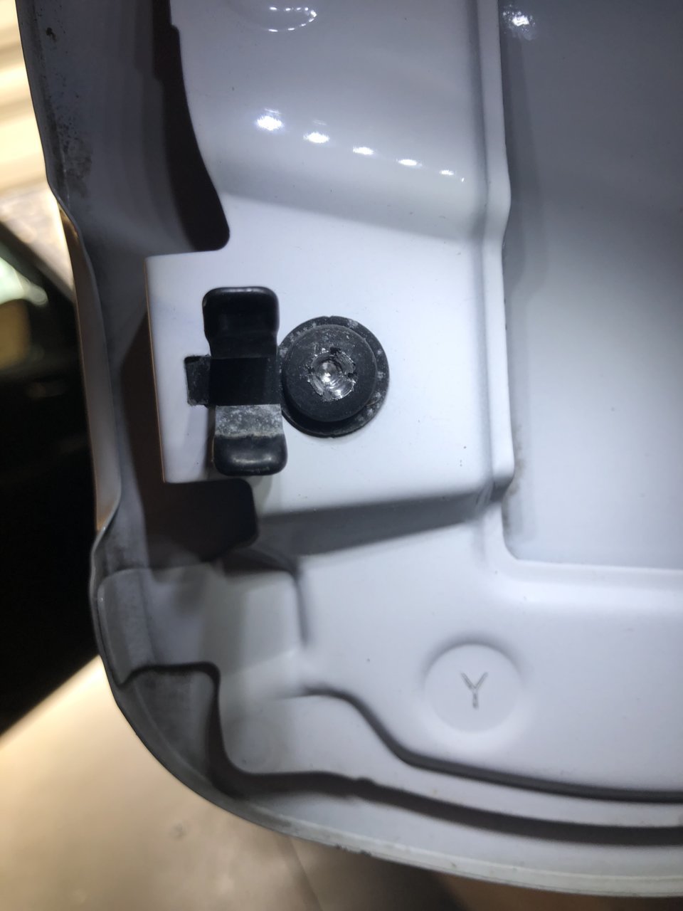

    Looking for suggestions on how to get this bolt out. Previous owner manhandled this bolt at some point and I cannot get this bolt out for my new @MESO gashole holder. Any ideas? I tried an extractor (as you can see) but I think it was already so jacked that this probably made it worse.

    I would drill it out. Or grind the head off. You could also grind a slot across the head (using a dremel) and use a flat tip screw driver. I have used all of these techniques over the years.

    Yeah- use a dremel to cut a slot into the head and then use a flat head screwdriver to extract. Should come out pretty quick and easy after that.
    You may consider using an impact with a flat head bit to break it loose, but YMMV.

    4 inch vice grips might snap on there too .

    Those first two I was thinking of myself. However that second idea Is a great one I didn’t think of!

    This is my recommendation as well
