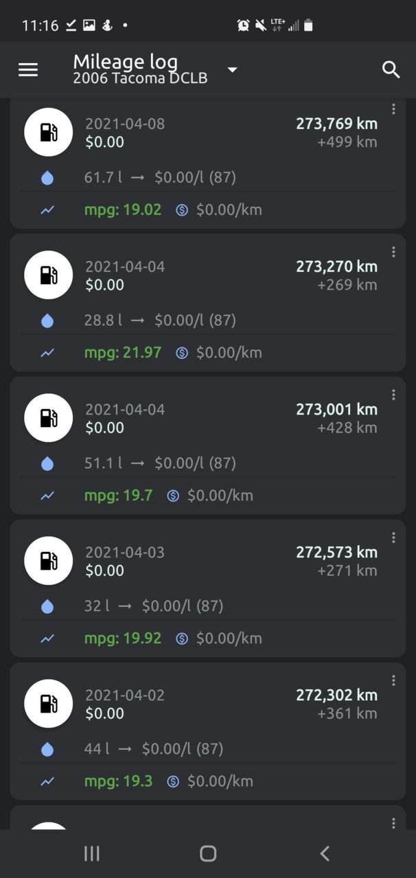

    I routinely get about 310 miles bone stock without a gas light and that's only about 18 mpg. 350 would be on a road trip.

    It's definitely real. But I only see it if I'm on a road trip, see below for some numbers. At 20mpg with a 20 gal tank you should get 400 til you're dry.
