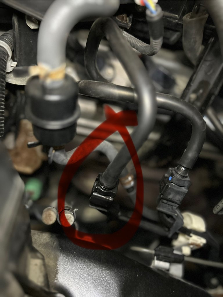

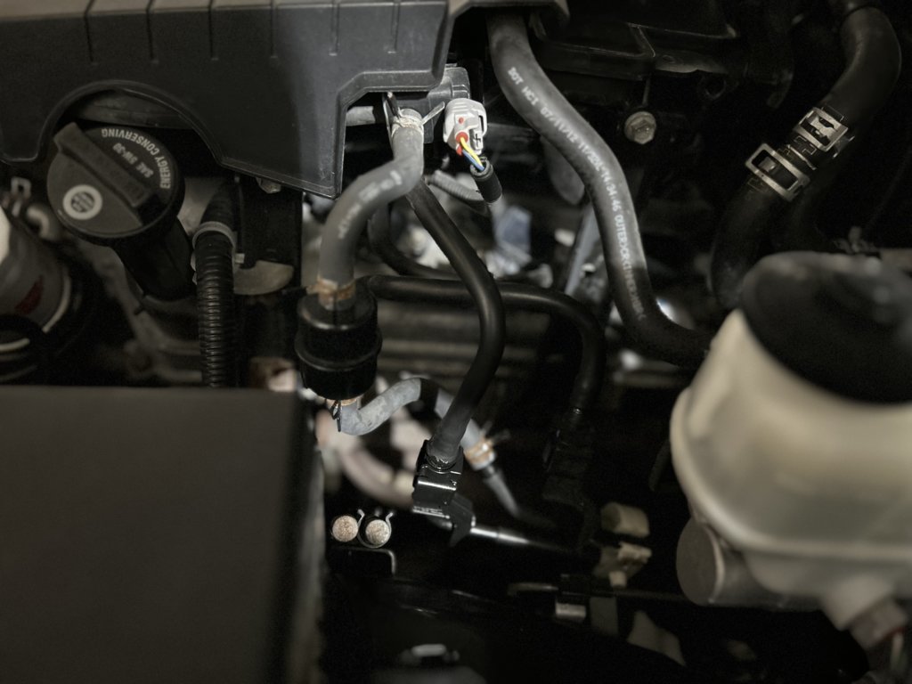

    This line started to leak. Let sit over night stopped few days later smelled gas and well here we are leaking again
    Replace? Or just put a clamp on it call it a day?
    Can not seem to find replacement part of it also. Anybody got some ideas?

    The plastic coating on the fuel line is likely peeling.
    Did you have any recent work done? Any fuel injection services?
    The only solution is to disconnect the line and razor off the plastic coating so it seals better. Otherwise you'll be looking at replacing the engine side line.

    Is there supposed to be a hose clamp on that line?
