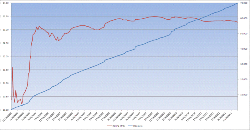

  13. Jan 30, 2012 at 8:08 PM
    #33
    81shark
    81shark Well-Known Member
    Nov 7, 2008
    #10567
    4,102
    2006 Base Access CP1

  17. Feb 3, 2012 at 5:05 PM
    #37
    iroh
    iroh Well-Known Member
    Oct 18, 2011
    #65439
    1,390
    michigander
    07 AC SR5 2.7 5MT 4x4
    tonneau
    I totally missed 81shark's graph... that's a LOT of tanks to keep a record of!!!
  18. Feb 4, 2012 at 6:41 AM
    #38
    81shark
    Nov 7, 2008
    #10567
    4,102
    177 data points to date
