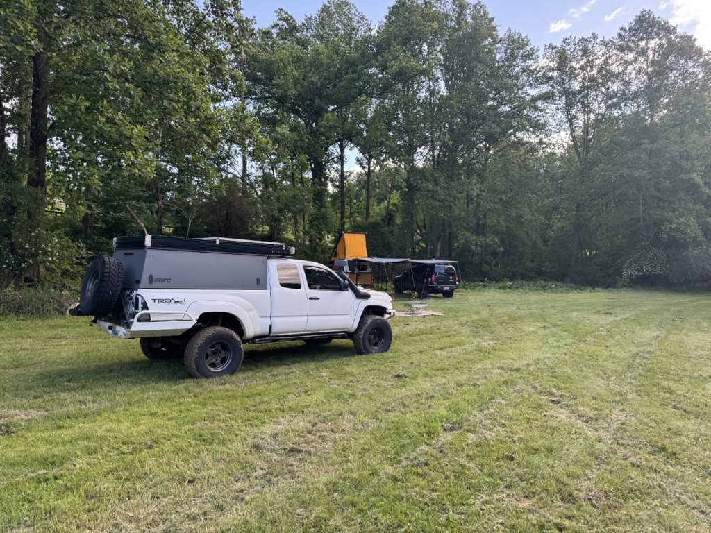

    I have a co-worker with a 2013 SR5 running LT275/70R18 tires and what looks like a 2.5 to 3" lift. He says he is only getting about 12 miles per gallon. Is this correct for this? If not, what could be causing such poor mileage. upload_2025-6-19_16-48-55.jpg

    Yeah that's not unheard of. Those tires are heavy af, 2 sizes larger than stock and also wider. And it looks like there is a bit of a rear squat going on which is about the worst thing you can do from an aerodynamic standpoint.

    His aftermarket wheels are probably quite heavy and that topper doesn't help either

    That cap might not be helping either (I know my Softopper dings mine almost 3 MPG). Also, are you (is he) correcting for the speedometer (odometer) error from those tires?

    Rotating - So those tires and wheels weigh in at probably around 65lbs each. Stock is probably about 10 to 15lbs lighter. that's 15 less pounds to swing around with every rotation and the larger the wheel is, the further away from center the mass is. If two wheels weigh 10lbs each and one is 31" in Diameter and the other is 35" in Diameter, the 35" tire will take more fuel to spin.
    Weight - I see he has a camper on the back. That weighs about 175 to 200lbs. And then what does he have in there? Think there is a conservative 100lbs of "truck guy stuff" in there? Maybe he's carrying 300lbs between the gear and the topper? Pounds and horsepower are directly related. Horsepower and fuel are directly related.
    Wind Drag - With that truck up in the air there is more turbulence under it. And lets face it, that's not the most aerodynamic vehicle out there to begin with. Then add on the topper and the added resistance of the tires which are wider and taller. The wind has a lot to bite on to.
    Age - That truck probably has 150,000 miles on it? Maybe? Nothing wrong with that! And it will probably do another 150,000 too. But like my knees, everything gets a little looser with age. And that truck was only rated for 20MPG in the beginning.
    If everything mentioned above shaved off just 2MPG each, then you are looking right at 12ish MPG.
    Purely bar napkin math but yeah. That's about right.
    Miles per gallon is usually a story of a death by a thousand paper-cuts.
    One thing he can do - make sure that speedometer is calibrated for the larger tires. If not those tires are 9% bigger than stock and will show 9% less MPG than he is actually really getting. That's worth 1.8 MPG and could turn his 12 into a 13.8 which ain't much but it's better than a poke in the eye with a sharp stick for sure.
