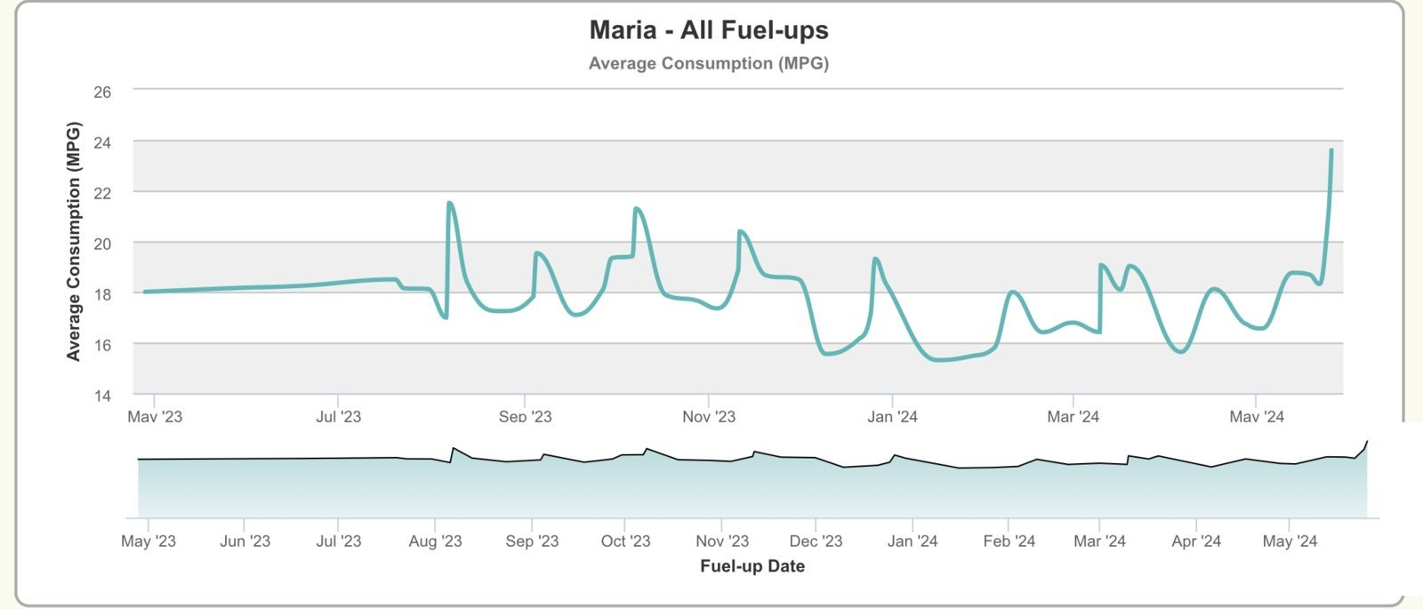

    OK, so 13K miles on the truck. Gas mileage has been disappointing. I can usually get published mileage or better, but this Taco eats the sauce. (Results are on Fuelly - avg 17.9)

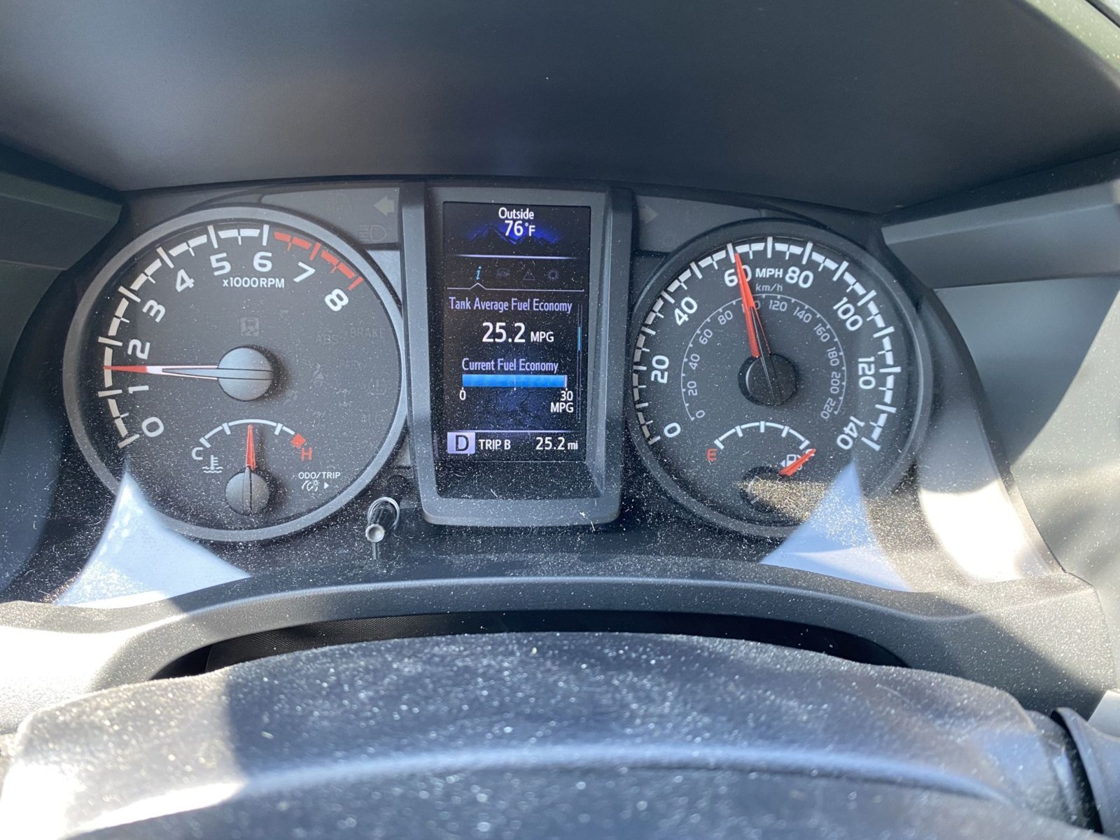

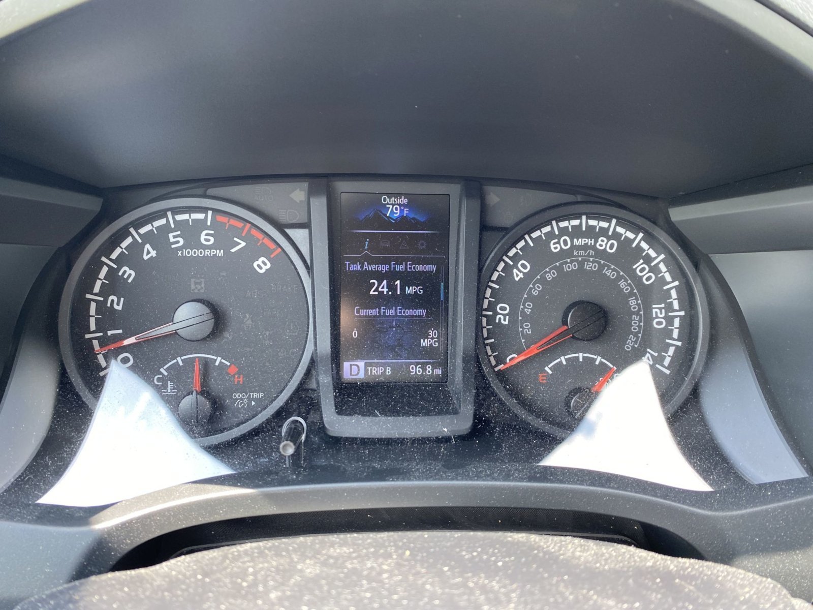

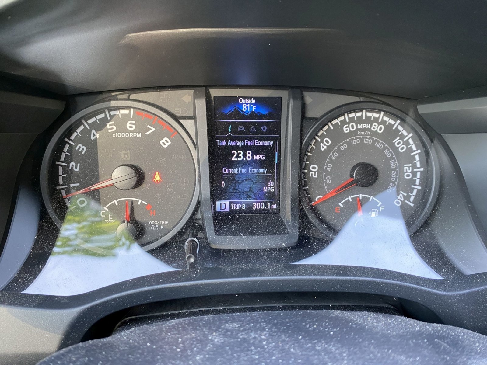

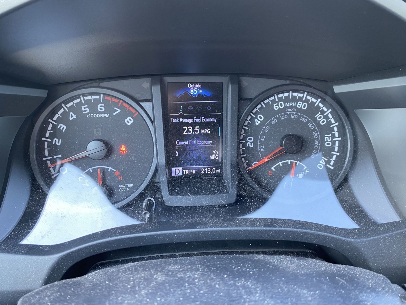

    I was reading about Top Tier gasolines, but the local stations around here look like holdouts from the 80's. On my regular trip to visit M&D, I decided to give Shell a try. I could not find the usual "may contain up to 10% ethanol" sticker on the pump. I get back on the highway and shazam - I'm getting 25mpg. Managed to eek out 24mpg for the first hundred miles. After my visit and in-town traffic, I'm only down to 23.5mpg at the 200 mile mark, and managed to gain a bit over the last 100 miles, ending at 23.8mpg at 300 miles. And I was only just below a -half tank- at that point.
    Anyone else notice a difference between the ethanol and non-ethanol blends? (I know this was just the one trip, but I will try the same gas station again and check the results.)
    [Normal gas is 87 octane from Sheetz, Shell was also 87 octane.]

    Non-ethanol is better but not 6mpg better. A gallon of E10 fuel has 2.2% less energy contained in than a gallon of non-ethanol.

    Your 5 MPG increase is likely due to driving conditions. Ethanol blended gasoline will cause a MPG hit but not that much.

    Could be a combination of things. Winter blend vs summer blend. Warmer weather increases fuel economy. If traffic was heavy, your average speed may have decreased.
    Ethanol free definitely has potential to increase fuel economy. I just don't see it causing such a huge difference on its own.
