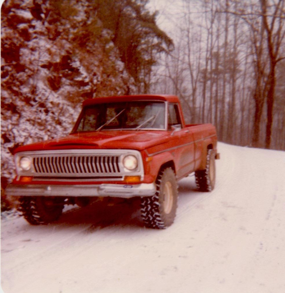

    16.2 MPG city driving is above normal. I don't do any true city driving. Most of my daily driving is a mix of small town and rural 2 lane. I usually get right around 17 mpg. On long road trips on an interstate hwy at about 70 mph I will get 20 mpg or just under that. Under ideal conditions I've gotten 22.
    Everything is relative. My 1st truck. 6-8 mpg city, 11 mpg hwy. Getting 17/20 from my Tacoma is like heaven. And relative to income gas is cheaper today than in the 1970's.
