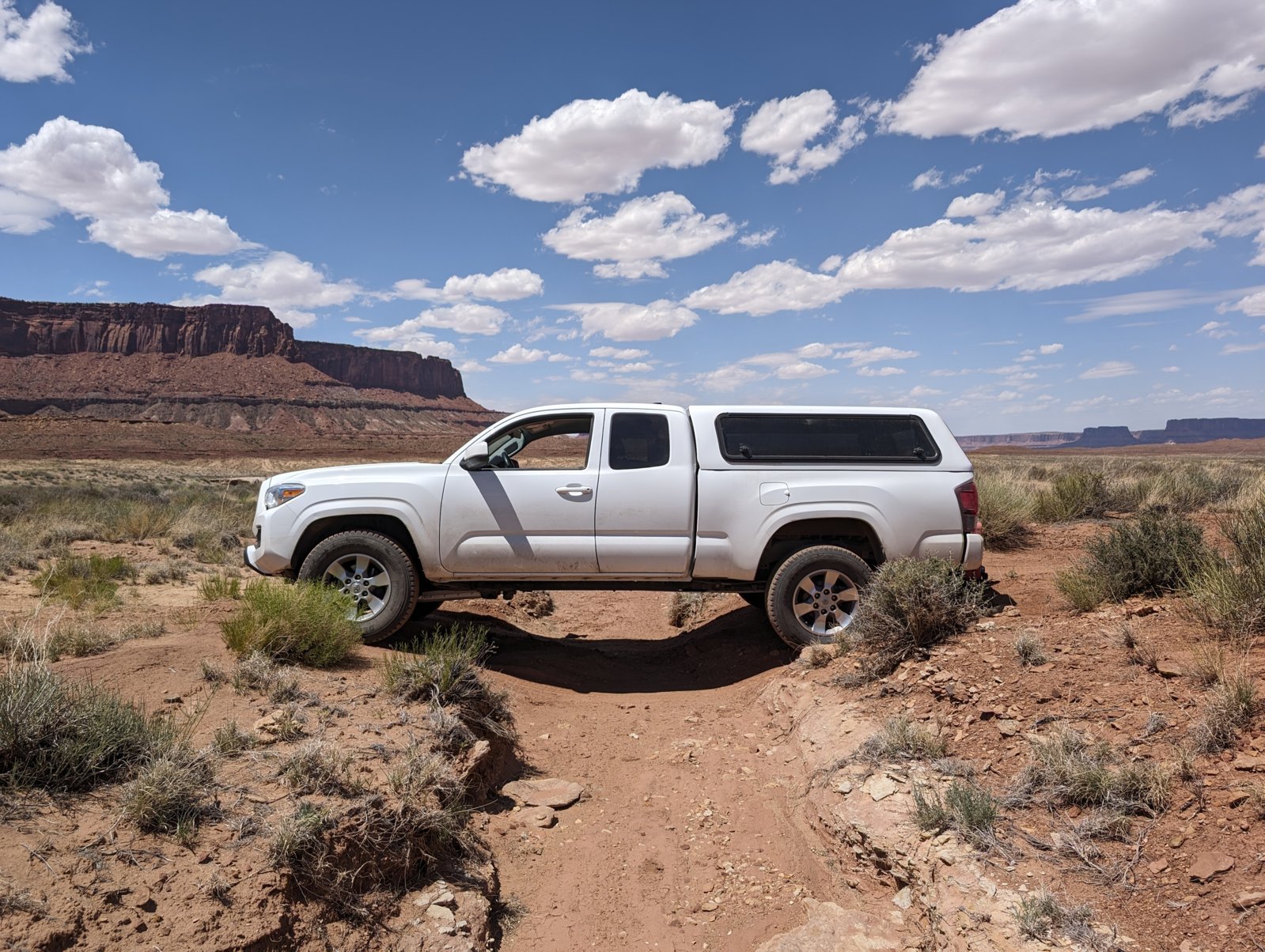

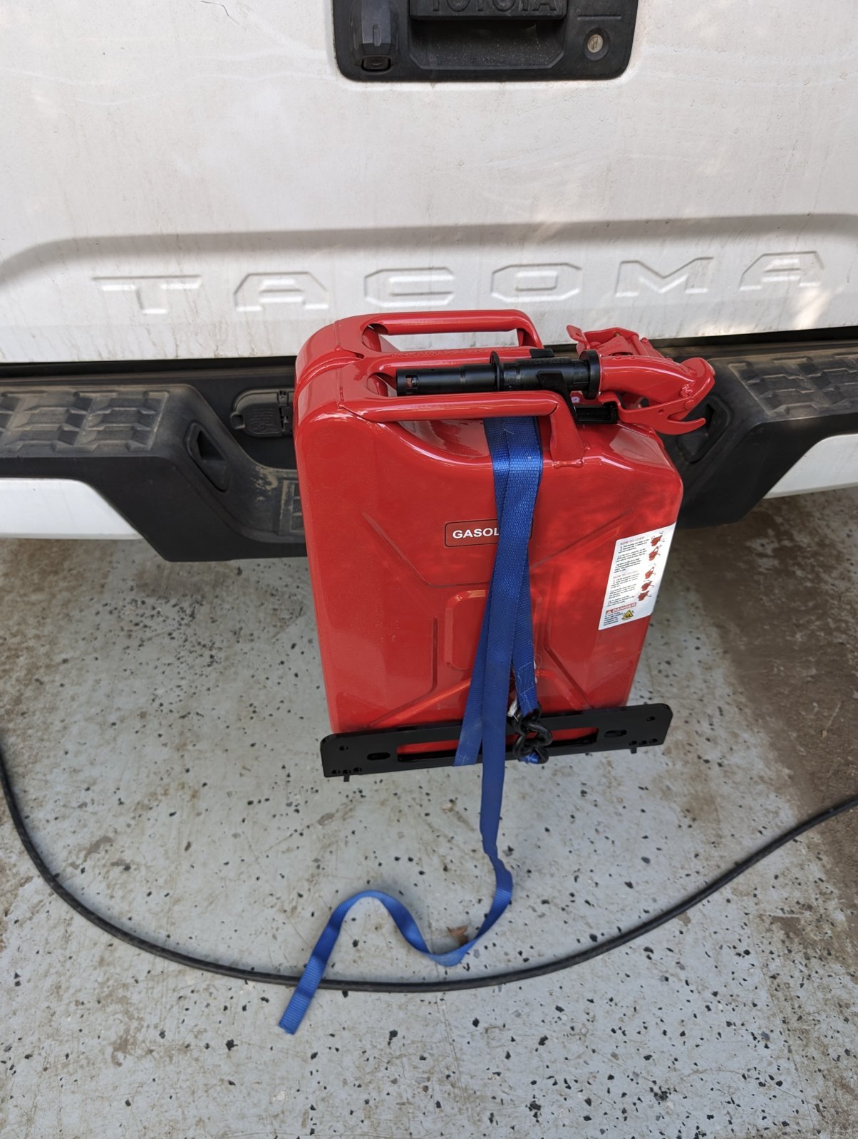

  19. Jun 8, 2024 at 10:20 AM
    #19
    M85
    M85 [OP] Well-Known Member
    Apr 3, 2024
    #447252
    333
    Colorado
    2019 SR ACLB
    Just an update. I went 291.7 miles and used 22 gallons. The dirt road in and out of the area I visited was smoother than some highways, so I was doing 45mph averaging over 20mpg for the 150 miles on the way in and out (about half dirt half highway). Most of the off road segments I averaged around 10mpg. For the rock crawling that took me two hours to go two miles I got around 2mpg. Or in other words 1 gallon burned there, mostly idling while I jumped on to look at the next obstacle.
    EPA gas cans are really awful. I spilled gas a couple times thanks to these stupid things. The first time was sort of my fault. I forgot to vent pressure from the lawnmower has can before attempting to fill the truck. It sprayed gas forcefully, and only a little made it into the tank. Thankfully that was at home before the trip, so I could clean everything up. On the trip the lawnmower gas can started leaking somewhere around the spout as I was fueling the truck. The brand new spout for the brand new Wavian Jerry can was awful too. It bound up, requiring extreme force to open. I broke part of the plastic off trying to press it against the filler neck. I didn't spill much, but it took me probably 10 minutes to refuel. The truck does not like to take gas poured in from a portable can, and it spills if I go any faster than extremely slow.
    I'm thinking if I take the spring out of the Jerry can spout, it might be usable. Or maybe I should use a siphon or funnel instead of just the spout.
    My idea of using a hitch mounted winch carrier for the Jerry can worked okay, but it scraped on a lot of stuff. I underestimated how much it would get in the way. I need a better way to mount the can somewhere. Maybe a roof rack.PXL_20240529_004114883.jpg PXL_20240602_202930118.jpg
