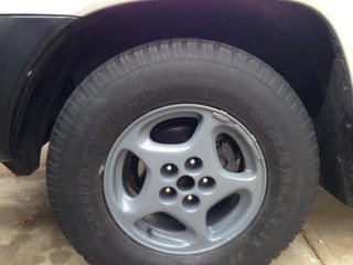

    I swapped the steel stock ones for a set of 16s off a 1991 nissan 300zx turbo. Two sets of rears. They are the same patttern and I run hub rings.

    Funny, I thought of that this AM. Someone posted Mustang wheels fit, so I knew Z wheels would, as I was a 3x Z owner.
    But the TT wheels were wider in the rear, where the NA cars had the same size all around..........
    So are you running the same size tires on different width wheels?
    Regardless, I'd love to see a picture of them on your truck. I had mine polished. A lot of work on a sand cast wheel like that, but they sure perked up the red car..........

  14. Dec 21, 2014 at 8:06 PM
    Artruck
    Artruck Well-Known Member
    Jun 27, 2013
    #107173
    1,687
    Lawrence, KS
    '09 Super Basic
    They are two sets of the turbo rears
    EC7BC402-A0B0-4E6D-A193-803CD0CFB4A2_zps_4de2aa5e92538e10534e13a5678a30180006762c.jpg

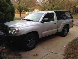

  15. Dec 22, 2014 at 8:22 AM
    Clearwater Bill
    Clearwater Bill Never answer an anonymous letter
    Oct 11, 2014
    #140097
    24,739
    Billy
    Largo Florida
    '13 5 lug AC w/convenience package
    A few OE parts from fancy trucks
    Gotcha. Very cool. Got a shot that shows the whole truck? Looks like its white like mine, so now I'm really curious!
  16. Dec 22, 2014 at 4:44 PM
    #16
    Artruck
    Jun 27, 2013
    #107173
    1,687
    Lawrence, KS
    '09 Super Basic
    19A1EFA0-C239-447D-B046-EFE19F6765D6_zps_8483b9262fcb88814924eba8d1d58b0b9fabc5f0.jpg
    Its silver streak mica....
  17. Dec 22, 2014 at 5:16 PM
    #17
    Clearwater Bill
    Oct 11, 2014
    #140097
    24,739
    Billy
    Largo Florida
    Thanks. Very cool. Bet you get lots of questions on 'what wheels are those!
