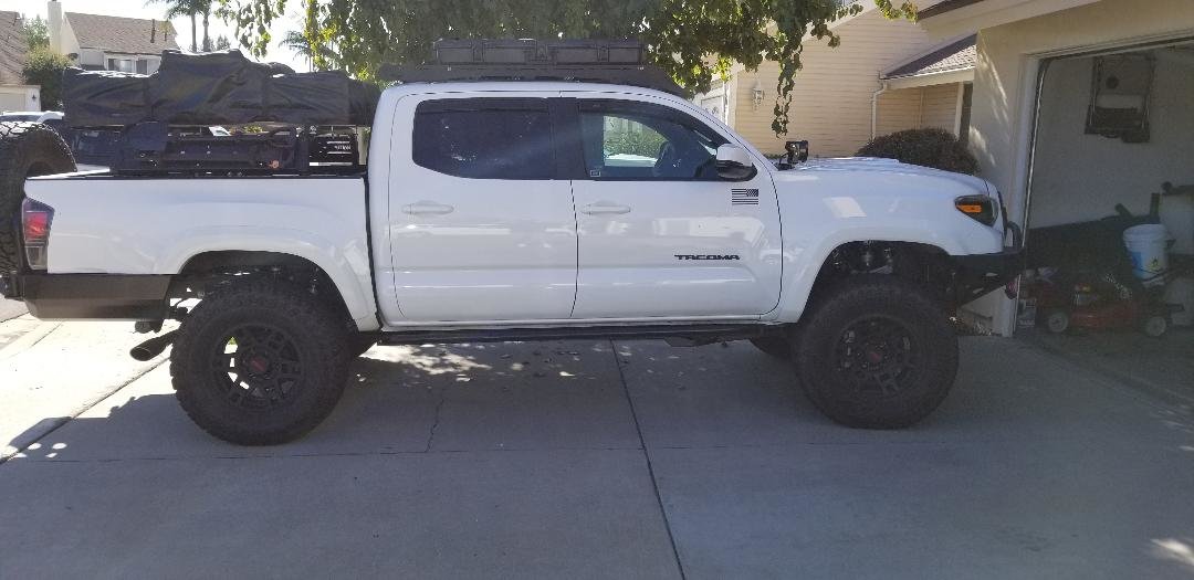

    Get re-geared , add OVTune. This next one is the toughest slow down! Dont accelerate with a heavy foot from a stop! dont go over 2000RPM on the highways, yes that means slow lane no more then 60MPH ever! You will get all the MPG's back that you lost and maybe a little more! I have a lift with 34's front rear after market bumpers , steal skids all the way back including fuel tank, RTT i can get 20 MPG's driving 60MPH that way but its so hard to do it! If i go 65 it drops to 17MPG's and anything above 65 it really starts to drop a lot! No way around the the loss once you add lift and bigger tires!
