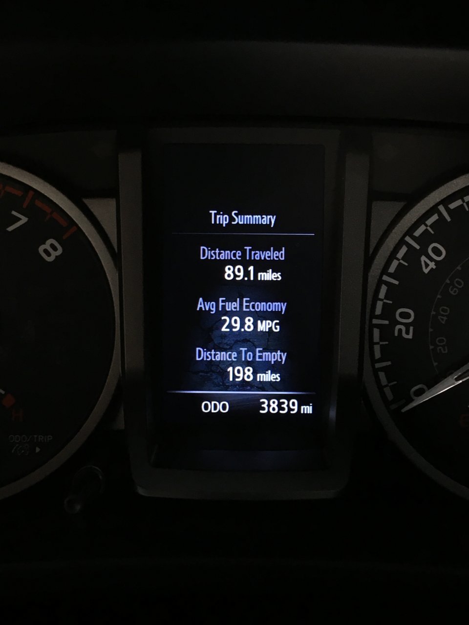

    199 through the redwoods in Nor-cal

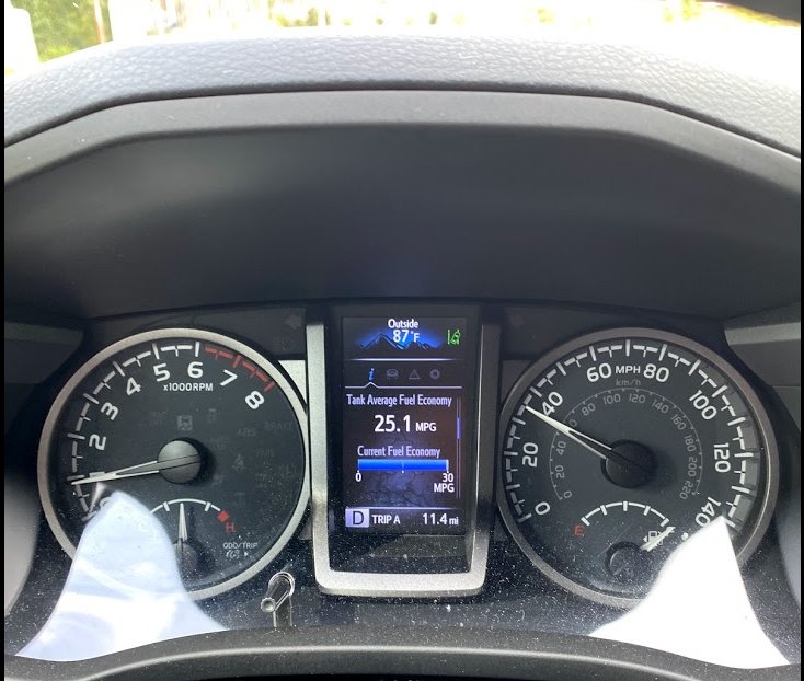

    11 miles on the trip computer LOL
