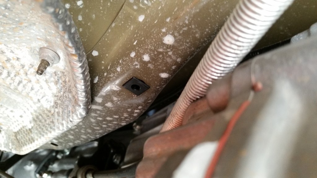

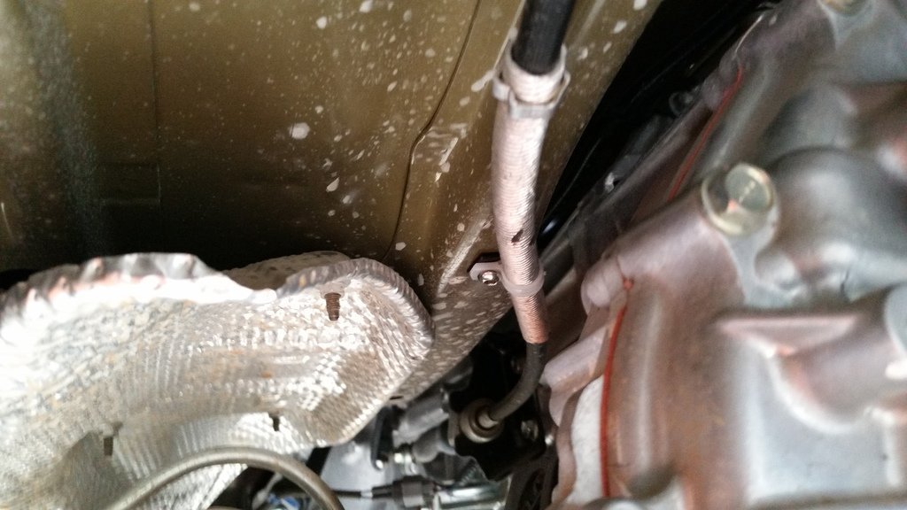

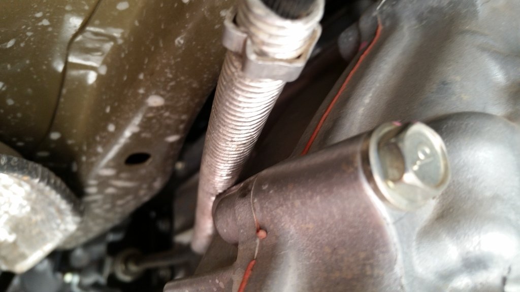

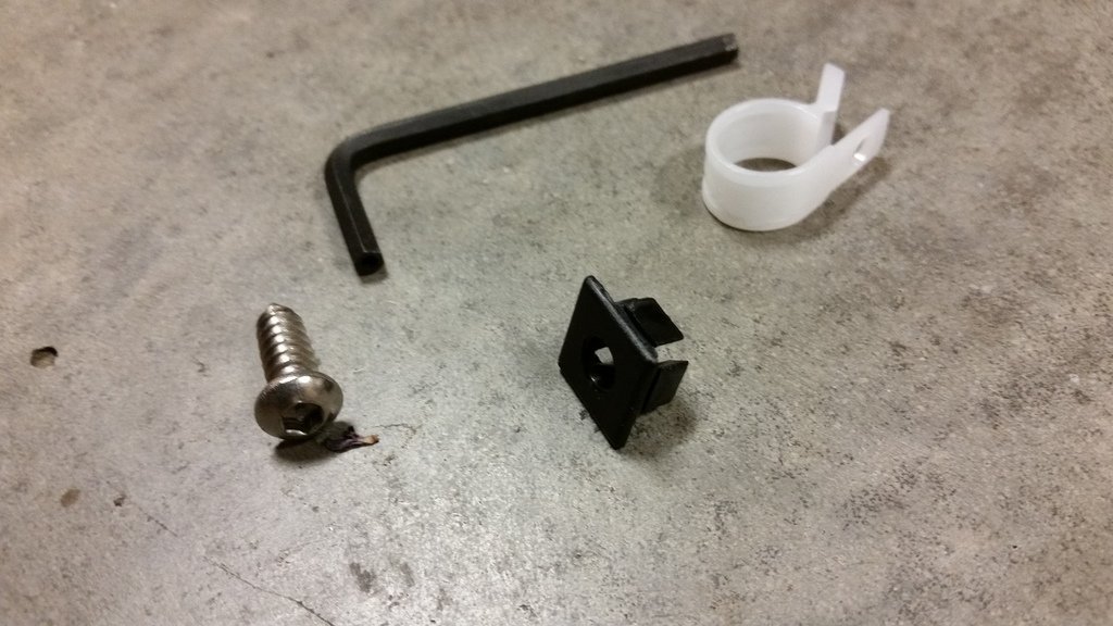

    Just fixed mine.
    I didn't have any vibes; curios to see if I do notice any difference.
    I just used a license plate retainer/screw and 1/2" cable clamp.
