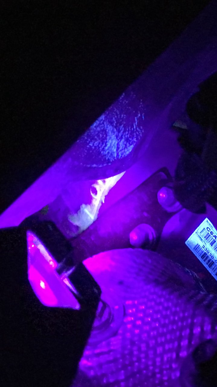

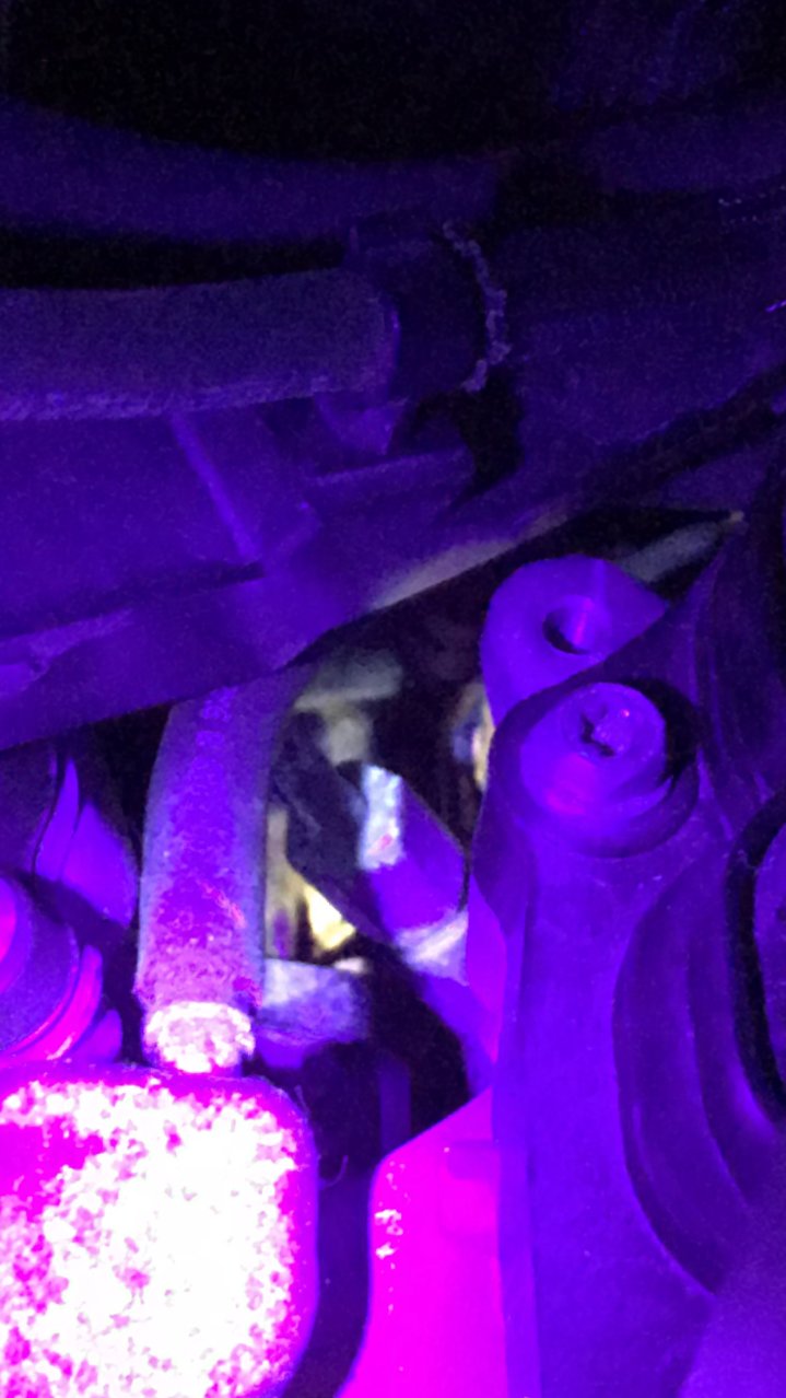

    It appears SavageTRD17 was correct... I put some UV dye in the fuel tank and drove around for 20 or so miles, checked all over and some fuel lines near the back of the engine in the valley (I assume the high pressure fuel pump) were lit up like a Christmas tree and a there was a dye running down the bellhousing.
    The dye is green in the pics. There’s some other colors in there, primarily orange, that were not related. It’s amazing how many common automotive lubricants and items are fluorescent on their own.

    Good grief, I’m glad you found the leak, that’s not safe!

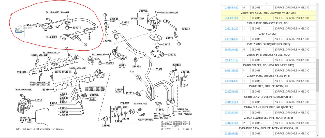

    I dropped the truck off Thursday, they confirmed the leak, and kept the truck. They called Friday morning to say they ordered the part but its on back order.
    They called again today, I should have the truck back Thursday this week.
    The part they ordered is 23800-0P020, which according to the knock off Russian Toyota Parts website (ilcats.ru) I found online seems to be the low pressure port injection fuel rail.
