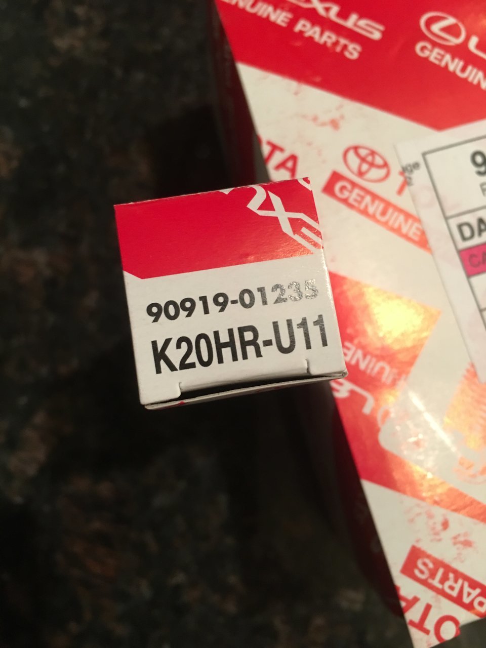

    You can try disconnecting the battery to reset. I was at Toyota today to pick up spark plugs, and they told me that Denso will have the least issues. Apparently Toyota engines are picky about their plugs. About the pre gap, definitely a good idea to check them before installing. It’s common for them to be off.
    The Densos are cheap too, less than $5 a piece.
