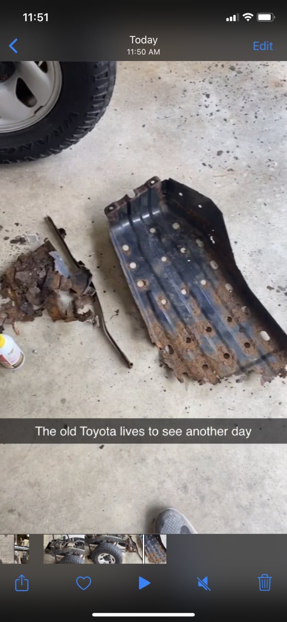

    Yeah I was at the gas station filling up and I heard a clunk, didn’t think much of it (I’m in NJ so I was inside the truck didn’t sound that loud). Drove to the grocery store, when I left I heard some really terrible sounds so I pulled over. The rear of the tank was about 6” off the ground lol. Strap broke in half right by the front leaf spring hanger and was hitting against the driveshaft as I drove so that’s what the noise was. Threw a ratchet strap around it and was able to secure it a bit better. Then I bent the strap out of the way so it wasn’t hitting the drive shaft, and had a veryyyy slow drive home.
    Sadly I don’t have any pics cause it was pouring rain and I was crawling around on the side of the road. I do have a couple Snapchat videos I took while I was fixing it though. Here’s a screenshot of the carnage.
    That pile of rust is everything that was left of the skid plate and strap. Thankfully the front tabs of the tank seemed to be in okay shape but only time will tell. This truck had a frame replacement around 2010 so all of the items they didn’t replace are slowly falling apart and I’m taking care of them as the arise. Kind of a pain in the ass and costly, but still cheaper than a new car/truck
