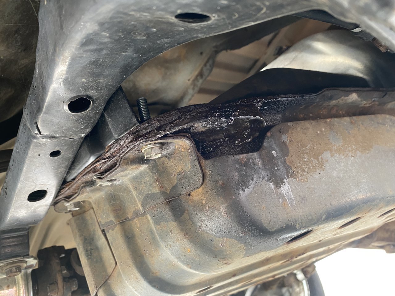

    thanks. I filled my tank up for the First time in the 4wd and it’s leaking in the front

    Gonna replace back strap, tank, and fuel pump anything else I need to order?

    I’ve been slowly fixing the truck for the past while. Got it legal, and Driving and working sound. I’d always just put 10 bucks so fuel wouldn’t sit
    filled it today and then this happened
    I’m going to JB weld steel stick it until I can order a tank soon.
    Im unsure of what exact tank to get because I have an 04 with the evap in the back

    167 dollar shipping, vs free shipping. Score. only 2 left in stock, You couldn't live in Hawaii without Amazon prime.

    @Tour991 shipping as you know in our many conversations is fucking deadly to hawaii, But I cross referenced the part number with the dorman website. It will fit.
