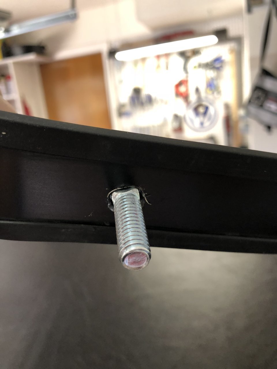

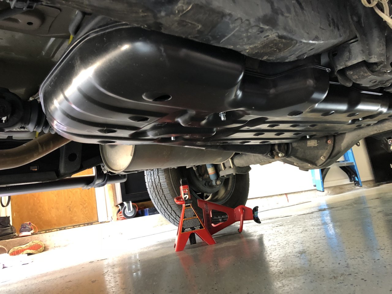

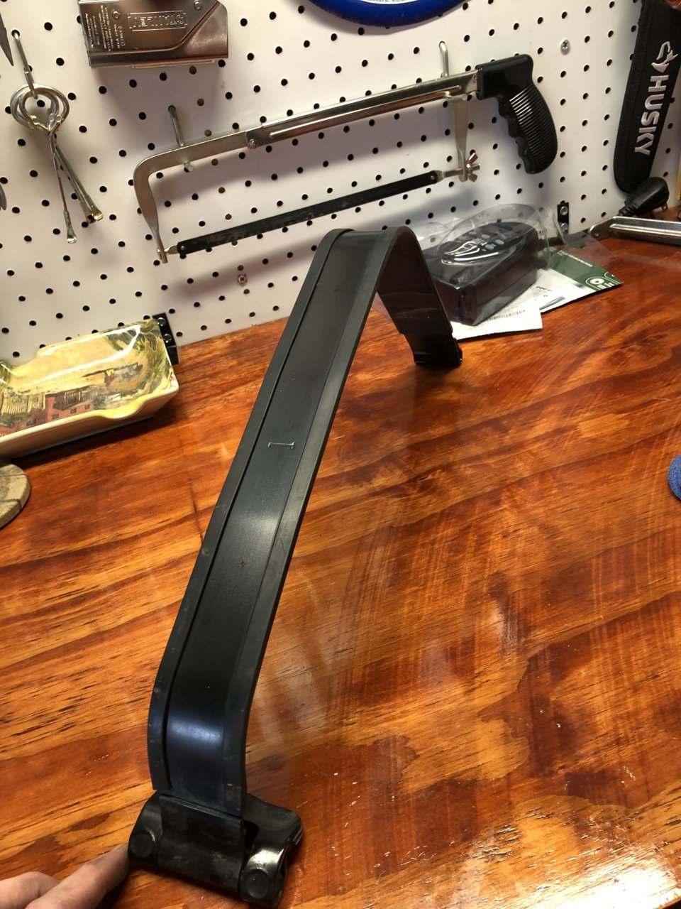

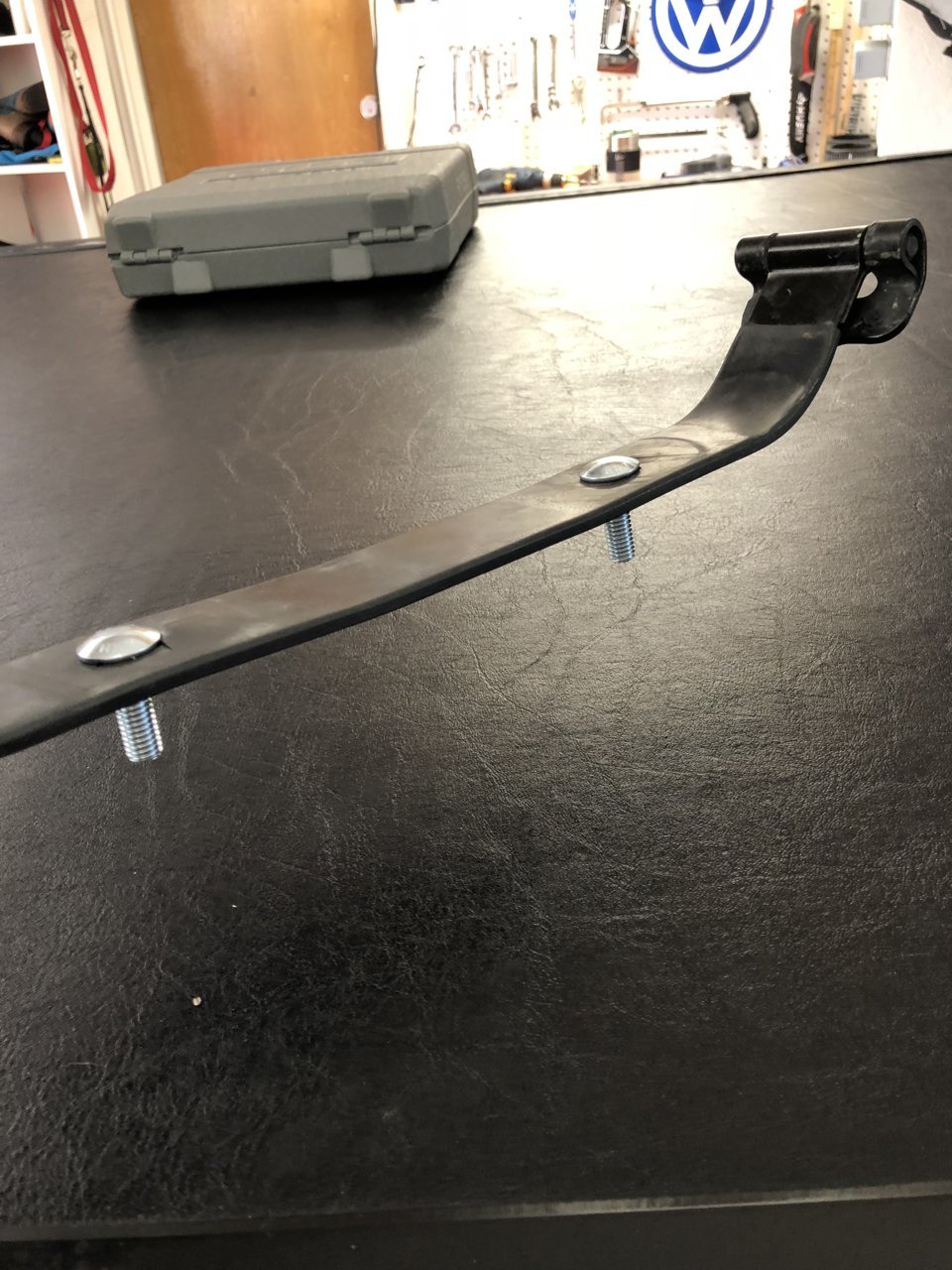

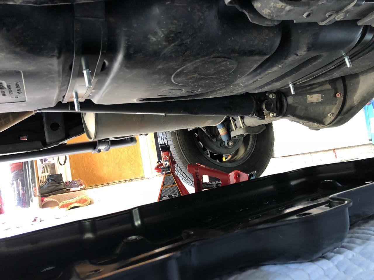

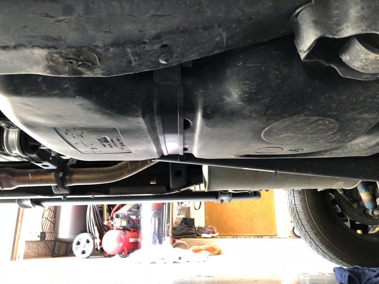

    Sports don’t have the straps with bolts like the off road versions do. You can either buy them from Toyota($150ish), except that as of this post they are not available for sale, go third party, or make your own for $3.20 in hardware. Now the off road protector will work on my sport.
