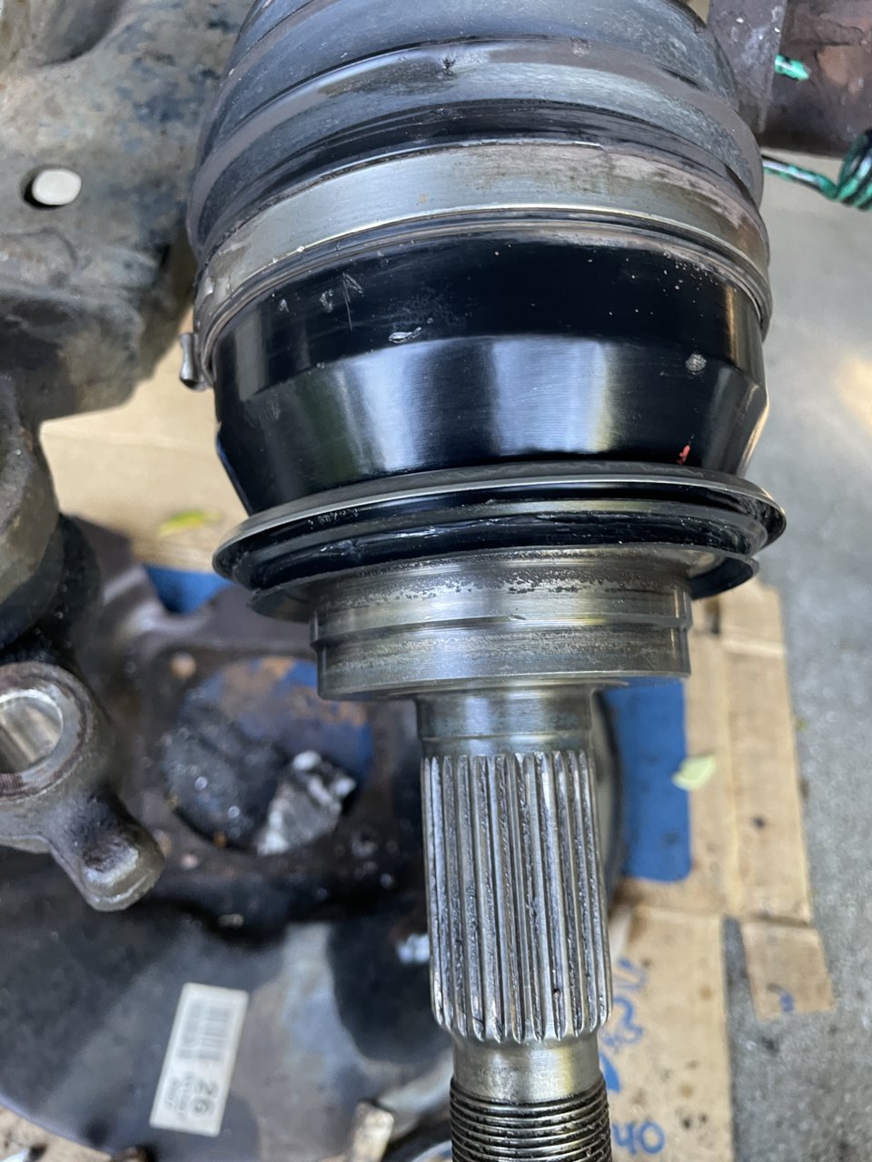

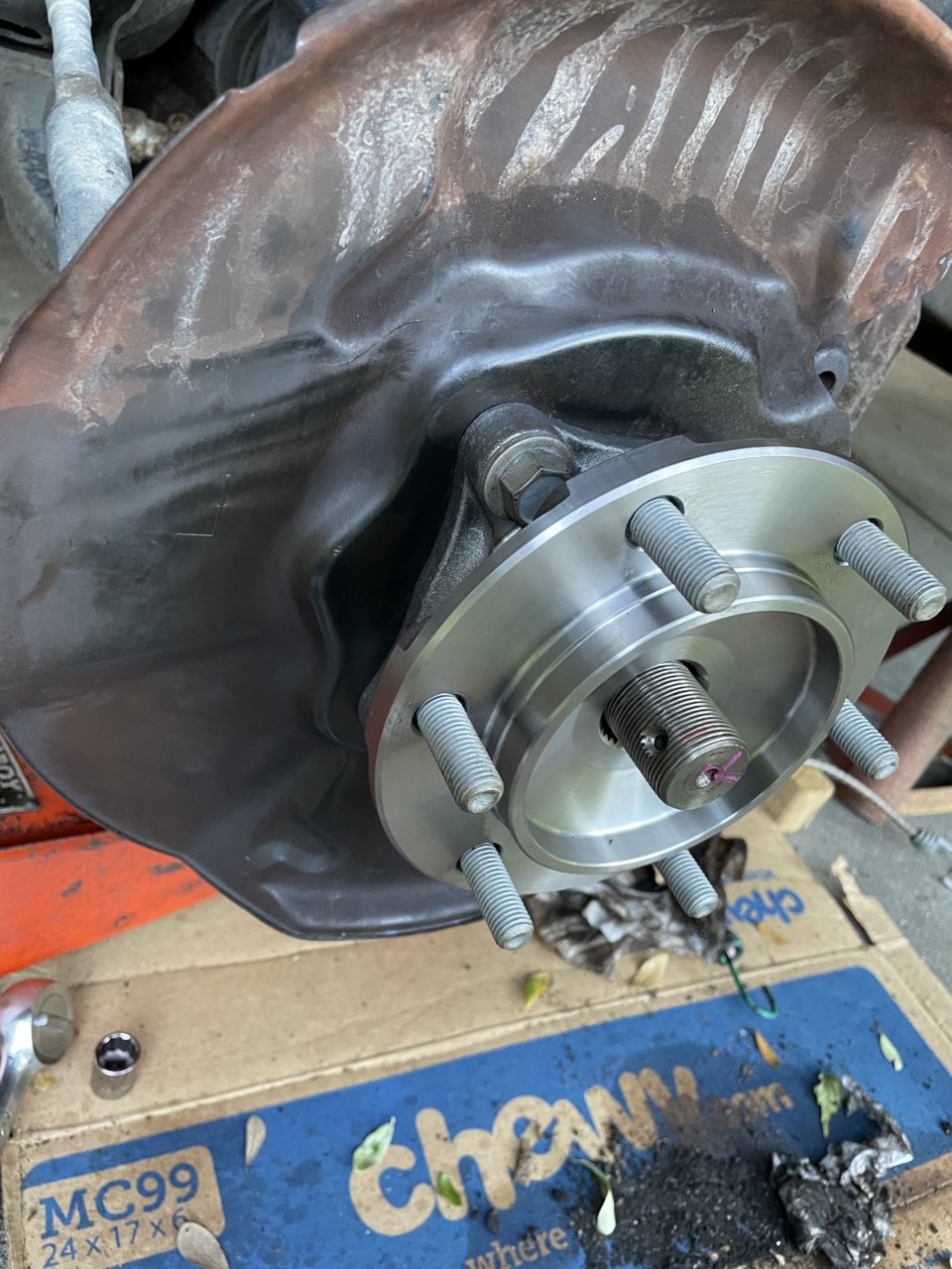

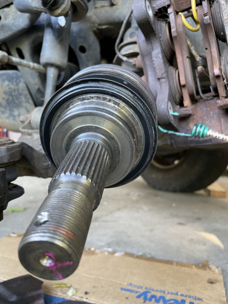

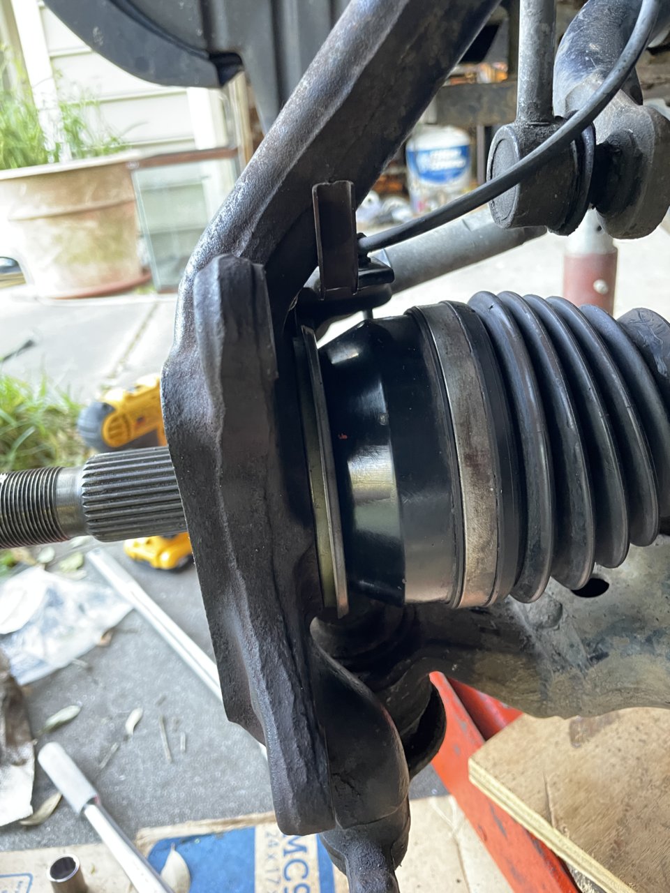

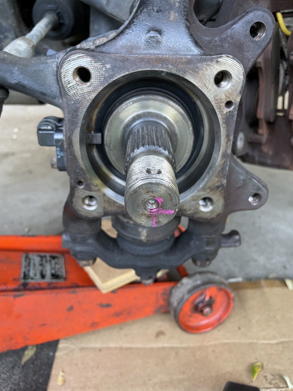

    Just an update, I got the CV dust seal (90304-A0001) from the local Toyota dealership today. With that, I was able to get everything installed.
    The CV dust seal installed.
    Then I got the inner wheel seal (710573) installed and two seated.
    Then got the hub assembly installed.
    Got the wheel back on, took it for a spin, and everything seems great. Thanks @TnShooter and @Wandering302 for all the assistance!!
