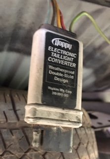

    Here is a picture of the connector on the truck. Hope this helps.

    Ok that is aftermarket not a factory thing I'm just trying to find an answer for your rather strange problem. The little box is full of diodes that can produce some strange effects under certain conditions if that thing is connected to one that is already in place it can send voltage backwards. I do not know if the Toyota came with a light converter with a factory package in 97 or not my old 97 had a hitch but had no converter, I have no ideal weather it was factory or not. The converters do go bad but usually cause issues with things like stop lights and signals. The Toy (and others) having separate brake light and turn signal bulbs and has to use a converter to allow the lights on a trailer to work as they only use one bulb, inside the little box is the electronics that allow this. So here is my guess there is an issue with the converter feeding back into the trucks wiring when the trailer is connected. The converters are a common device and even WalMart sells them. However don't call me bad names if that does not fix it! If it were mine I would try one the logic kind of points to that.

    Ok, thank you so much. I have ordered a light tester and it will be here this Friday I hope. I will try the tester and then if that doesn't tell me anything, I will replace the converter and see what happens.

    Yes that is aftermarket...had the same one and it didn't work...bought a new plug and play harness on Amazon and everything was good to go

    Sorry it took me a while to get back to you guys. It was the converter box on the truck harness that was bad. I replace it and now no problem when I put the truck in drive.
