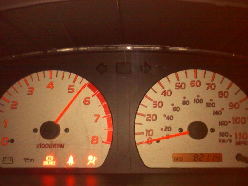

  13. Jan 11, 2012 at 4:17 PM
    DougL
    DougL [OP] Member
    Dec 30, 2011
    #69631
    11
    Doug
    Jacksboro TN
    '03 3rz
    here's a pic of them (mostly) installed. i've ran about 300 miles sense the swap, everything works perfectly and the odometer DOES NOT show my actual mileage. i'm very happy with it overall.
