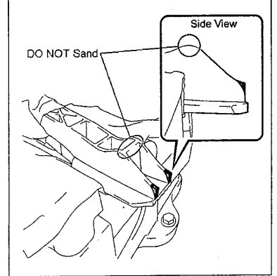

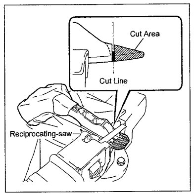

    The ribs on the back of the pedal have a raised point, intended to contact the floor as a travel stop at WOT for strength reasons. Toyota's 2010 pedal entrapment recall instructions specifically said not to trim away the raised point:
    It may be easier to bolt two sheets of 3/8" UHMW (for 3/4" total thickness) to the pedal face.
