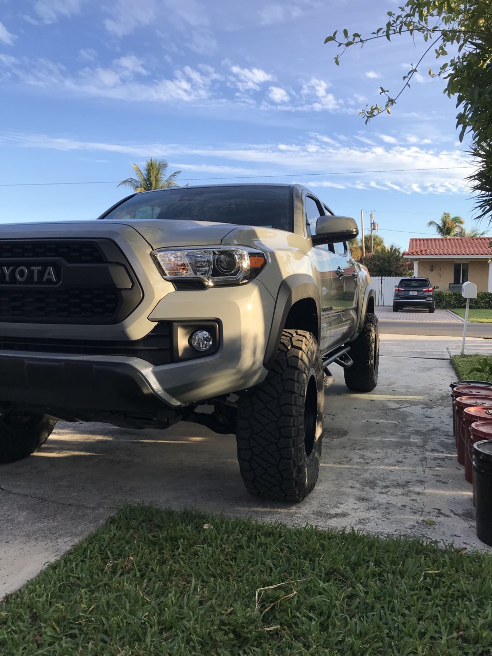

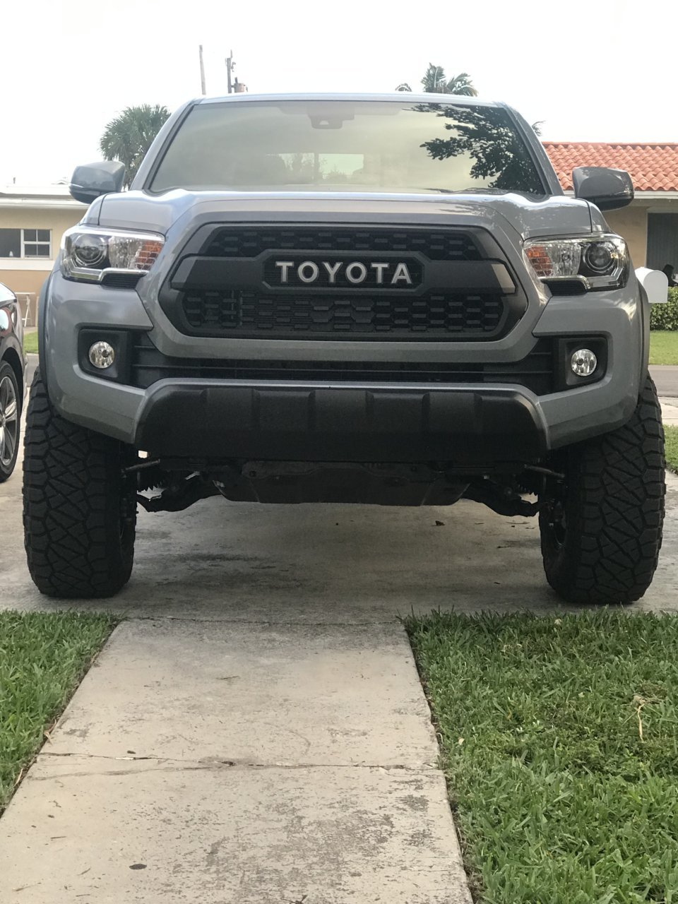

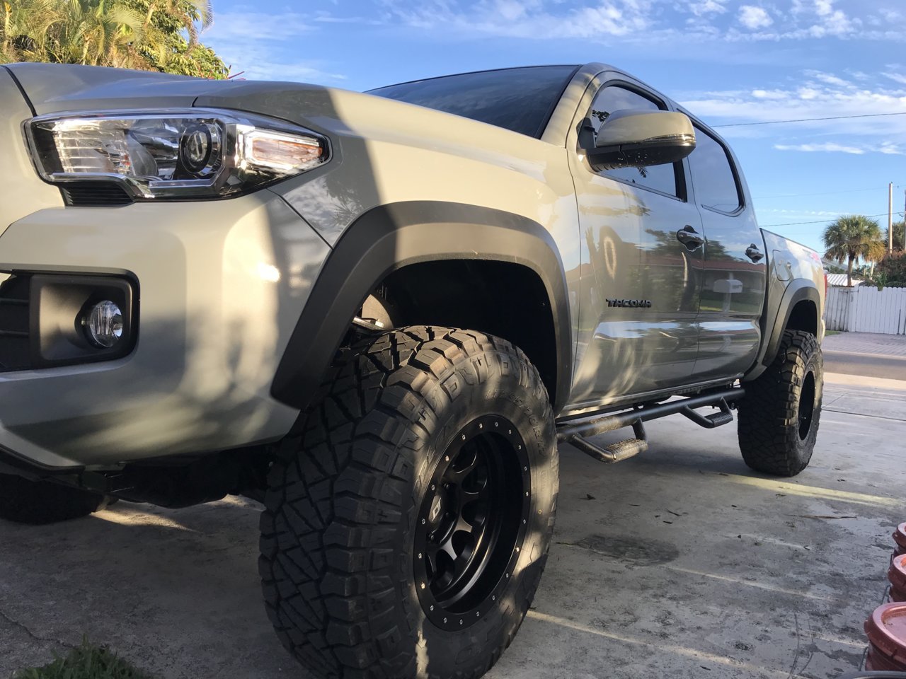

    F85A78F8-3EF7-404F-AB01-9F3D148F84BF.jpg Well here are a few more pics of clearance with a 295.. i still have to get a proper alignment and VSC reset B75A03B7-16EC-4A4B-B41B-E76E0CE8AA25.jpg4C3C3A60-383F-4F0F-B201-5F2AFD26DF7B.jpg

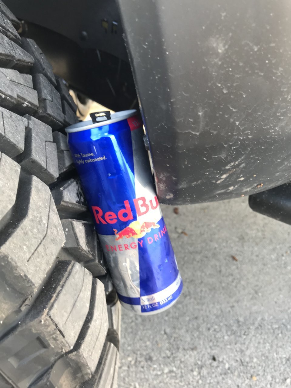

    Here’s passenger wheel to rear fender: 12oz Red Bull for perspective:
    (Wheel is straight)

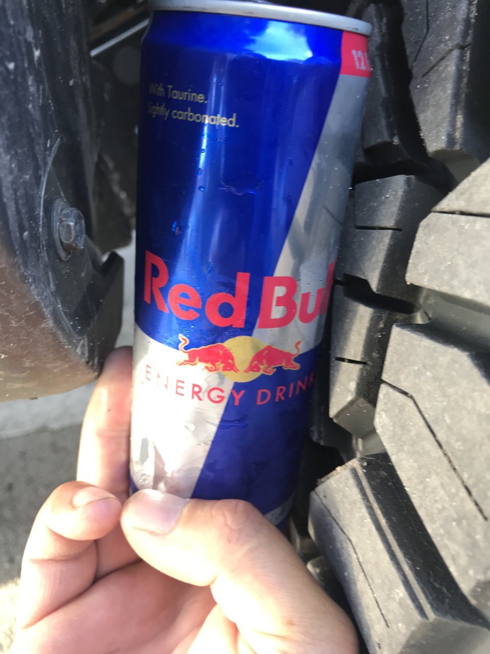

    Here is driver: (can is crushed and wheel in same position)
    Anyway, off for a proper alignment next week almost an inch difference!! any opinions or conjectures on alignment are welcome

    @Hookedup as far as alignment goes, that looks about right actually. The difference in caster is there to compensate for road crown so the passenger side wheel should be very slightly forward of the driver’s side one.

    Yes Cross caster. But almost an inch of it?

    That might have gotten thrown off a bit by the weight of those tires slightly affecting the camber, perhaps? I’d be interested to see what your specs are when you align it since I could use some refreshers on alignments and I’m curious how far off spec your setup is. Great looking truck, by the way! :)
