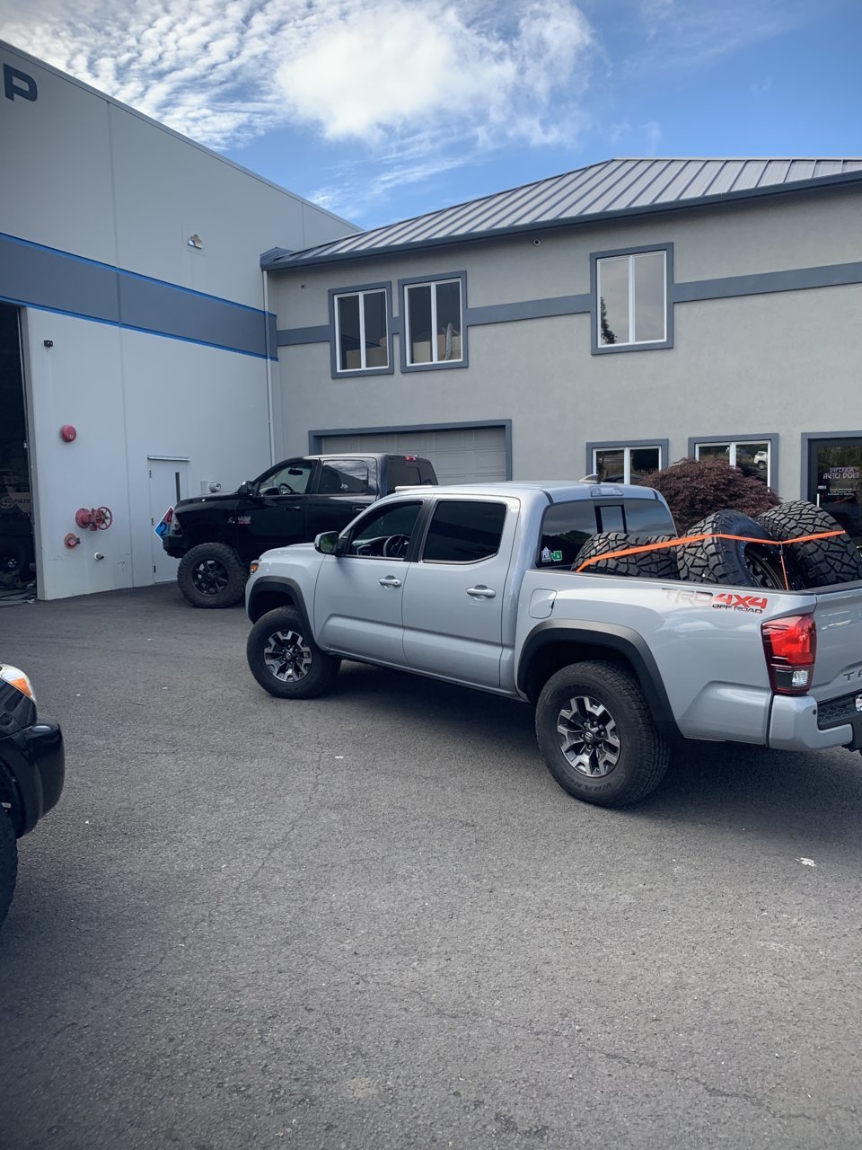

    As we are speaking now I’m getting aggressive cmc done with 34s will keep update. Also getting pinch weld smack down and spc arms
    Just pulled in about 1.5hours ago

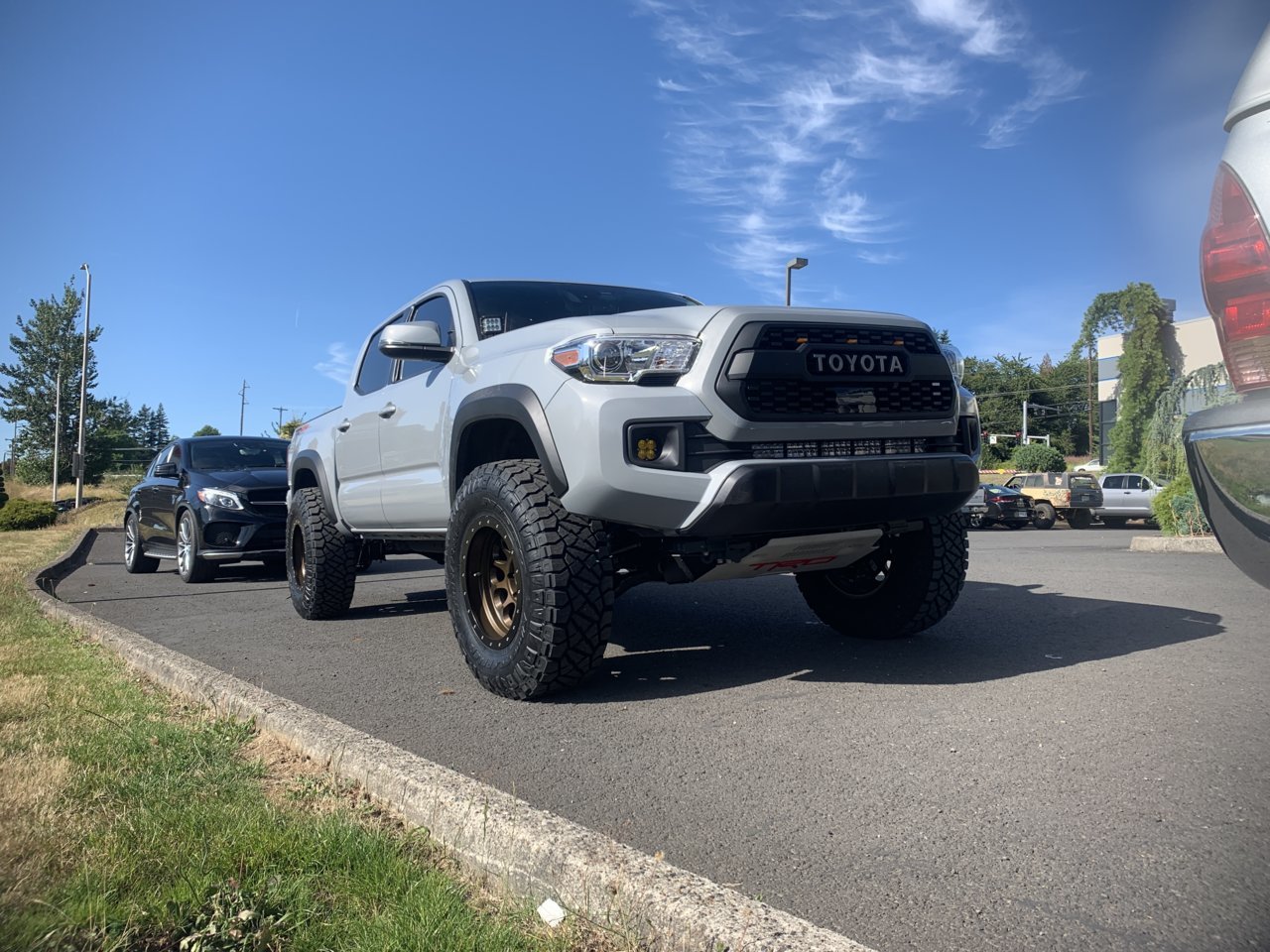

    Just installed! But m8? I’m on 6112/5160. Lmk what m8 is. But overall the comfort ride. Stiffer but better than stock!

    love the ride, I have a 2nd gen Im about to install some kings and I was wondering if youre still rubbing and of so where at? Did you do the pinch weld mod as well or just the cmc? Would a cmc relocation have helped at all?

    I’m not rubbing at all anymore. I have a cmc and pinch weld smash. But the main thing that helped out was playing with the SPC UCA’s top plate. The key is to decrease caster at the top and max out caster on your lowers. This pushes the wheel forward. I don’t even rub off-roading at the moment, which is weird because I used to with my 17x8.5. UCA science

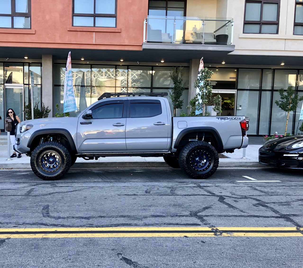

    285/70/17?

    Looks like Westchester area or Del Aire

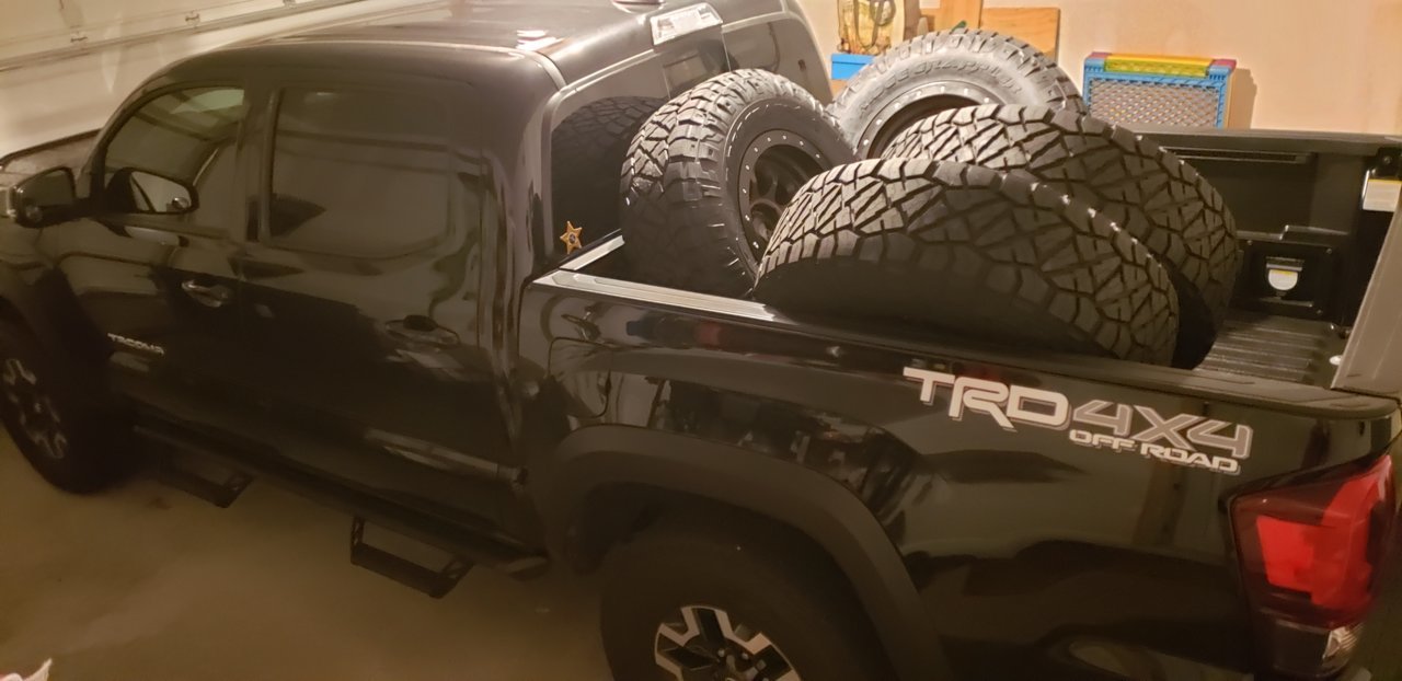

    Install tomorrow! Bilstein 5100, HS 3 leaf AAL and of course ray 10s. I'll post pics after I get everything on

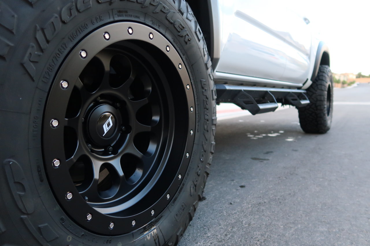

    what size ridge grapplers are those?

    285/70
