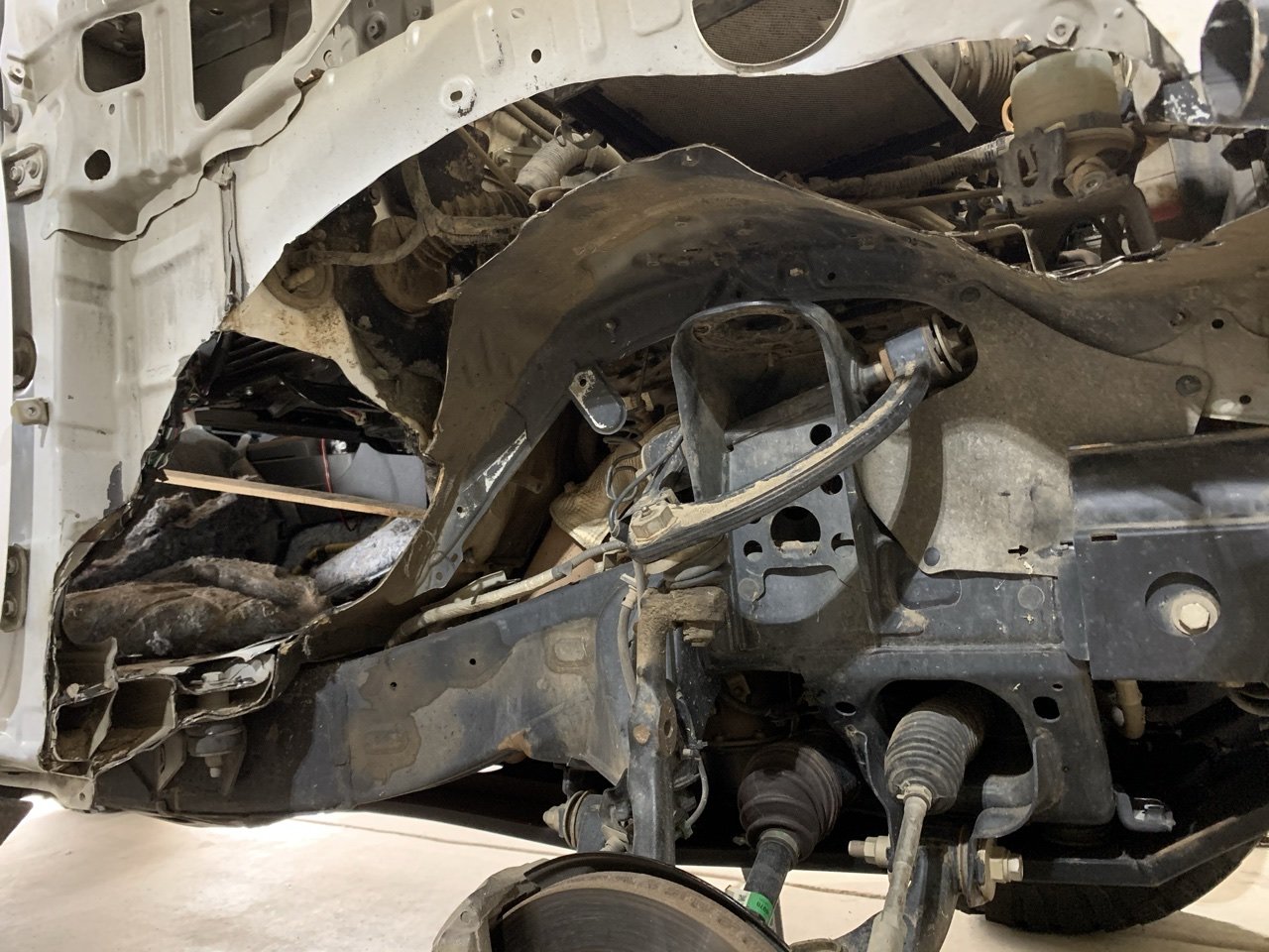

    Here’s the hole you’ll have to cut to run 37x12.5r17s on these wheels

    Oh, that’s it? Lol

    Nah I still rub a little so really you have to cut more haha

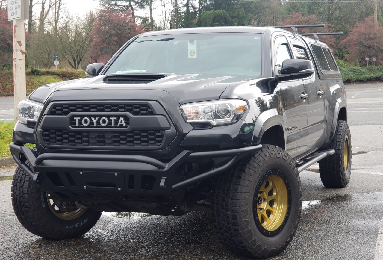

    It has finally come together. It took a long long time considering I bought the wheels last October but I'm happy with final results.
    Nothing to add here more than the usual fitment work:
    Cab mount, pinch weld, cutting plastic and some metal.
    Tires: 285/70/17 Cooper Discoverer XLT
    Full Dobinsons Suspension (including the leaf pack)
    2.5" front and 3" rear
    UCA is still stock. No rubbing yet during a service road trip last weekend to go hiking.

    Your truck looks awesome! I just ordered a dobinsons suspension w uca. How bad was the wheel and tire set up rubbing ? I like the bumper too what is it ? Sorry for all the questions lol. I ordered my 17x9 ray 10 back in May and I wasn’t gonna put them on until I had my suspension and all the parts/tools I needed to put them on also.

    Thank you. It wasn't an option to drive away without CMC. I actually had to take it back to RE-do the passenger side. With -38 Offset and 285/70/17 tires; It will rub. I wasn't going to have my brand new tires rub against the metal of Cab mount or the pinch weld. :)
    I bent the pinch weld myself. nothing to it (Didn't even use a hammer).
    Needless to say that i'm still with Stock UCA. I can not comment what you can get away with if you have an adjustable UCA.
    Front bumper is from Lil b's fabrication out of Colorado.
    Yeah take your time and research before you do. There is a lot of informative stuff on this forum and members are helpful.

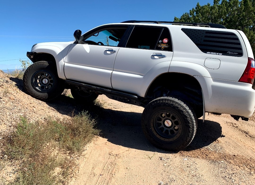

    Don't know if I posted the 4runner here yet. Here she is. 17x9 and 285/70 Wildpeaks.
