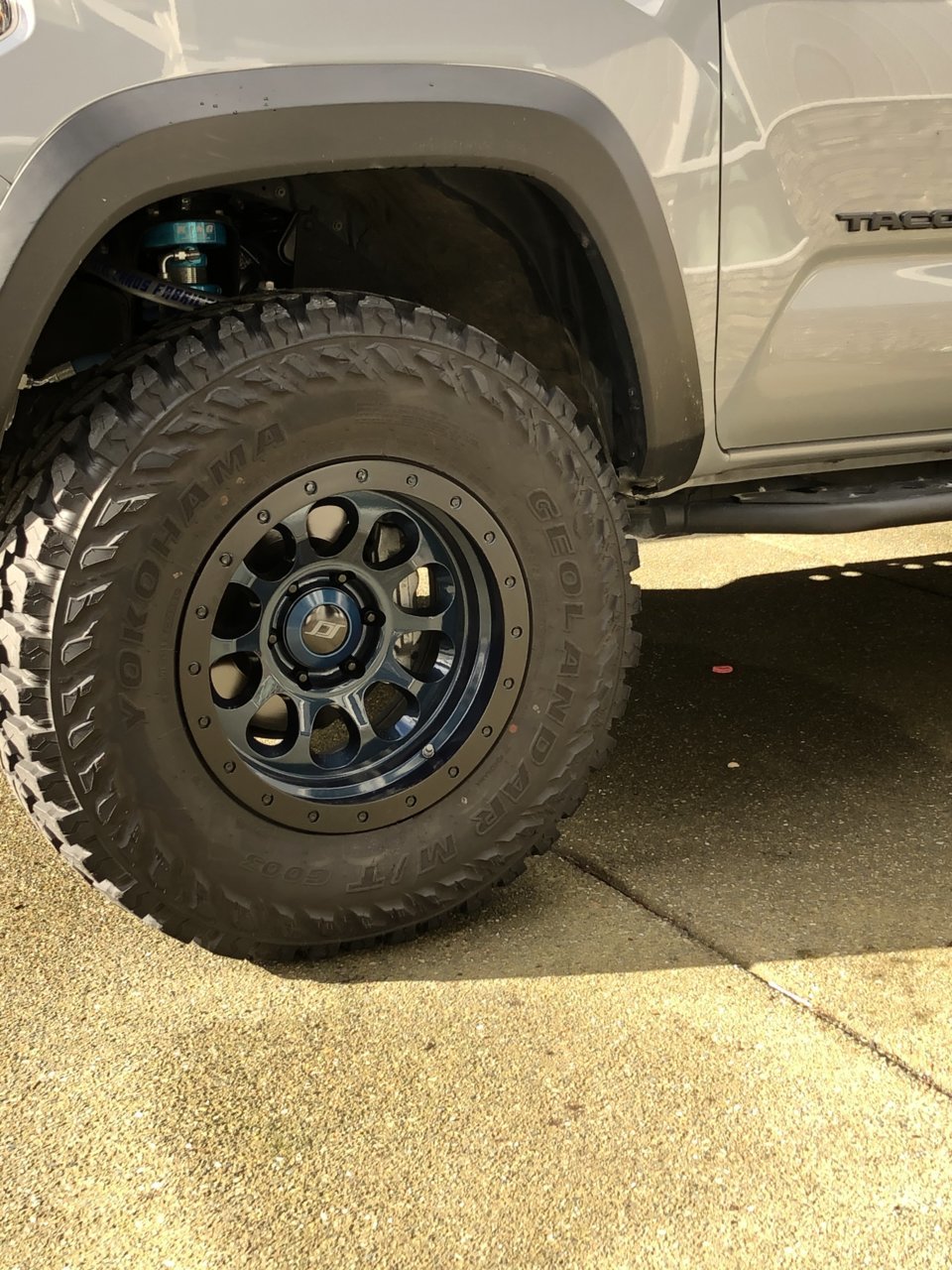

    285/75/17 or 290/70/17 seem to be a good choice. You could run even a true 35” but idk if you are committed for that much cutting.
    I’ve got 285/75/17 and think they look perfect for my usage
    Edit pic for reference

    Just so peeps know, 285/75/17 will rub and I would suggest cutting your fenders and flares 2” for off-roading. Also an aggressive cmc will still probably rub locking, unless you can get the cut angled back.

    yeah it’ll def rub, but fender trimming might be a bit excessive. You’ll def need an aggressive cmc, pinch welds, and a good amount of plastic cutting
