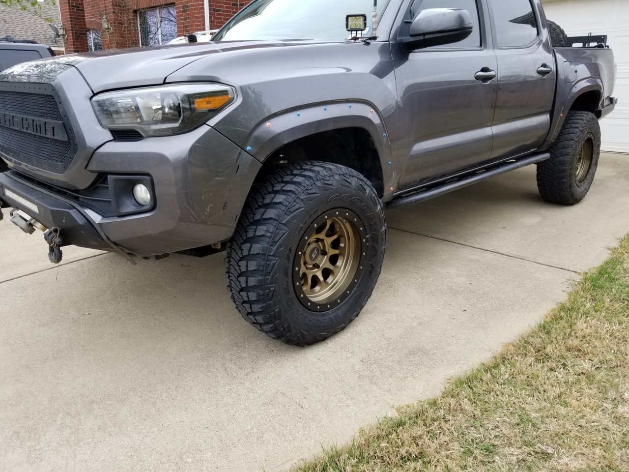

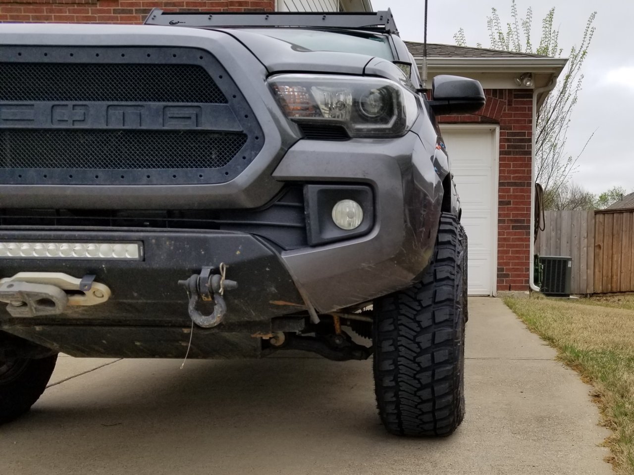

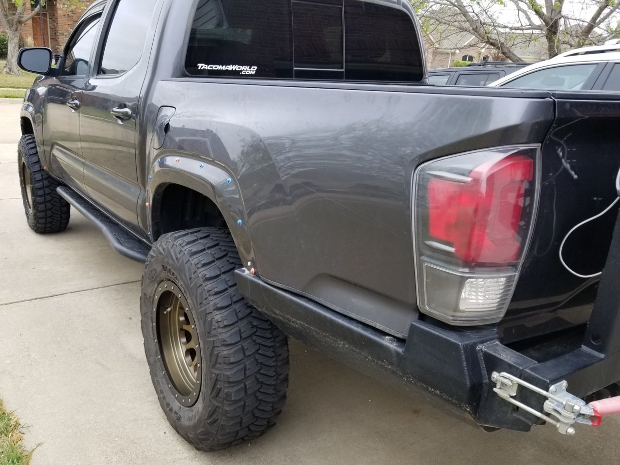

    2C7AC4D8-41E4-481B-83F0-A8FD9DA65FEC.jpg 2924BF30-9FF5-49B7-A813-560674AE1D8D.jpg E347A404-1B08-4E04-8745-FCD4E0015243.jpg
    Love the look!

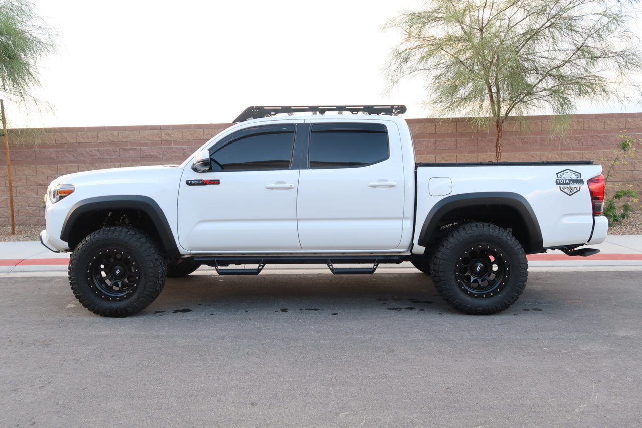

    Golddddddddddddd!!!!!!!
    Had them mounted for about a month now. Rubbed like crazy for a bit, even after first alignment. Got with a different alignment spot that was willing to mess with my SPC top plate and talk over what I researched on here and the SPC website.
    Also had to throw a bead on the cam tabs, because either previous alignment or off-roading smashed them flat. With some team work we were able to get 6 caster and the toe and camber within spec. Could be placebo affect but my steering feels a hell of a lot lighter. Not sure what that’s about.
    No rubbing at full lock, I have a cmc and before new alignment it would rub like a mofo. Of course it does rub if I compress at speed on the flare, once I get a snorkel I’ll chop that up anyway. On to the pics. Kinda shitty but it’s the first time I’ve had a chance to take some. 285/70/17’s btw.
    C5CB0EC8-03BB-4580-B892-3D1D34CD995E.jpg C0958FD7-C829-4B76-9EA4-B9B773500A0A.jpg

    oh man those falkens look amazing and so do the wheels, obviously!
    I still haven't mounted tires on mine yet and was leaning toward Nitto RGs but i may wait till those Jeep Gladiator owners sell their new 'take-off' Falken at3w C LOADS since i like how theyre mounted on yours.
    what method did you go with to black out your bolts? powder? paint?

    Had them powdered via Vins recommendation.

    Do you have spacers? I wonder why mine doesn’t poke like this?

    No spacers. Just that deep dishness. Maybe 2nd and 3ed gen differences...?
