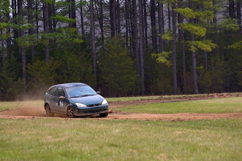

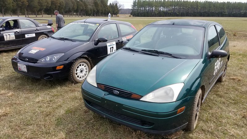

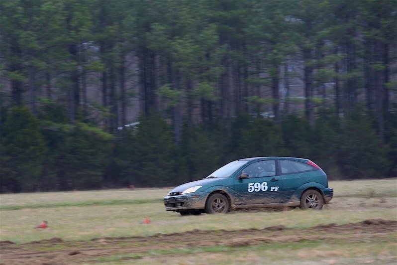

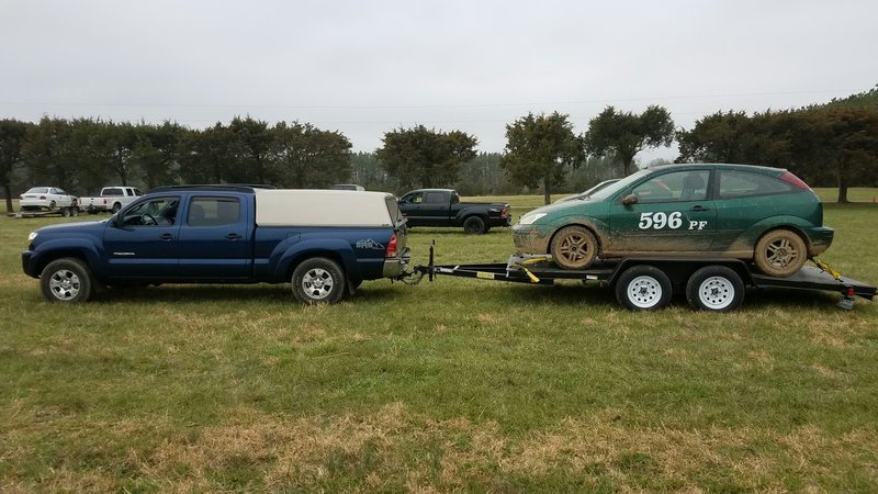

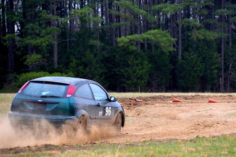

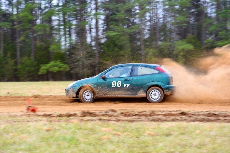

    Okay, since im terrible with updating build threads, heres another update that should have been posted months ago.
    Our season kicked off with the first event in march, a Test 'N Tune on Saturday followed by the first points event on Sunday. Car ran okay on Saturday, i realized the rear brakes didnt work at all after a few runs so i (Attempted) to pull the drums to diagnose with no luck, ended up running all weekend with no rear brakes or Ebrake, made for a slow weekend. Sunday, i brought my co driver down, we started the morning off with some decent runs, the lowering struts on the car made for a real handful, getting railroaded all over the place since we didn't have the suspension travel to keep out of the ruts. it was also super muddy, and as a result the snow tires packed up with mud really fast and turned into slicks, making for even less traction. In the afternoon, the only other focus driver there lent us his spare set of gravel rally tires and wheels (which cost more than i paid for the car and parts combined) since he broke a CV axle on the last run of the AM session. Holy Balls, the traction those tires provided made for some lighting fast runs, even with the other issues the car had. It was like we were driving on pavement. Unfortunately, on my co-driver's second PM run, between the rough course, the blown out lowering struts not able to control the extra weight of the rally tires, and us really pushing the car, we blew out the passenger side CV axle and ended our day there as we didn't have a spare, and the other focus guy has an SVT so his axles are different than ours. I also found out that, at some point during the day, i broke the rear trans/engine mount, this probably is what caused the CV to fail. And now for the pictures, the first are the carnage pics, then the AM runs, then the PM runs (since everybody loves carnage pics) and ive also updated the build plan again, since it keeps changing as I learn what i really need and what can wait.

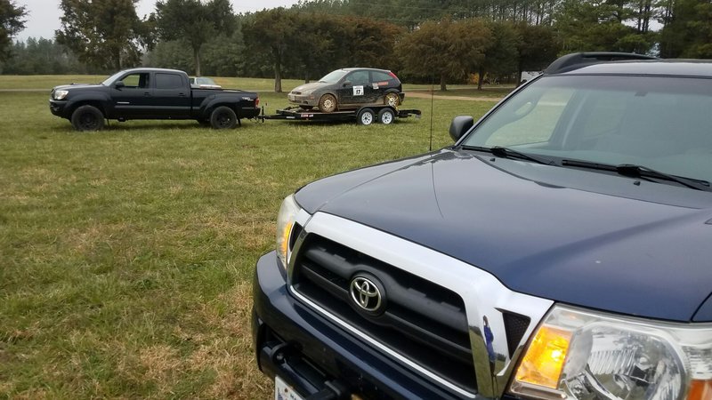

    Heres a pic of my Focus next to the other Focus SVT that comes out
    And both Foci loaded up to go home, we have similar tastes in tow vehicles as well
