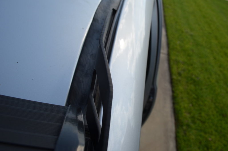

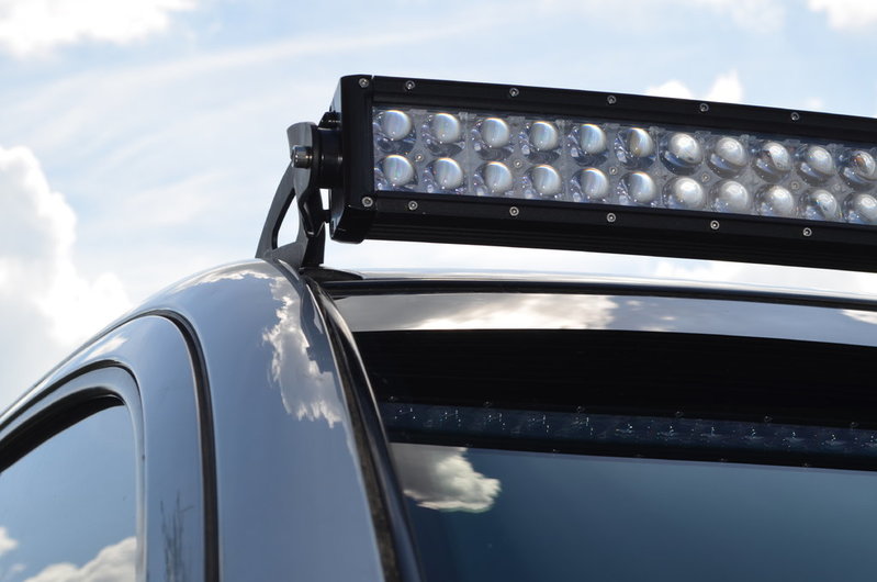

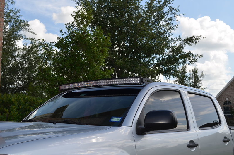

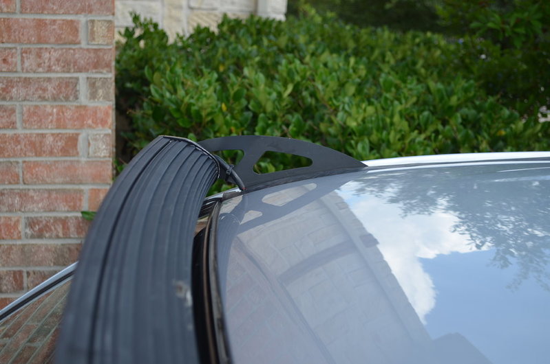

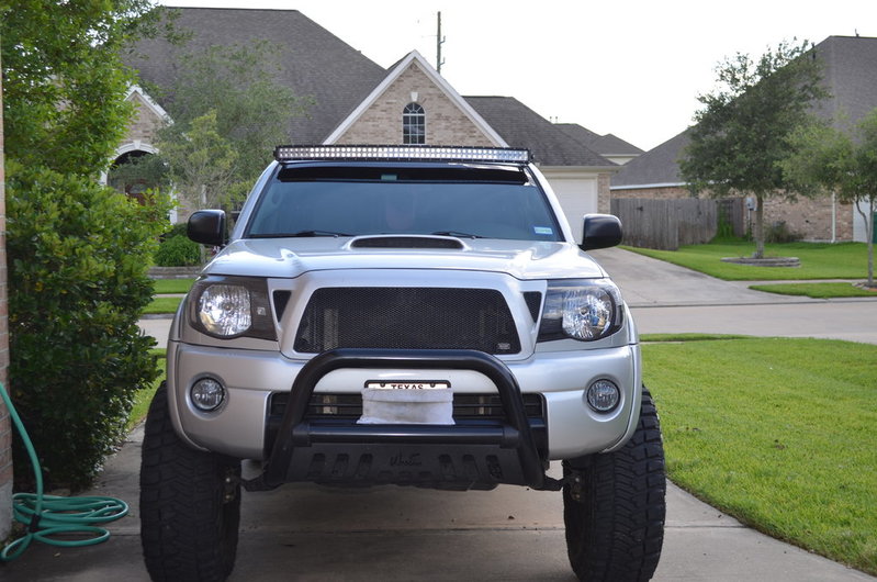

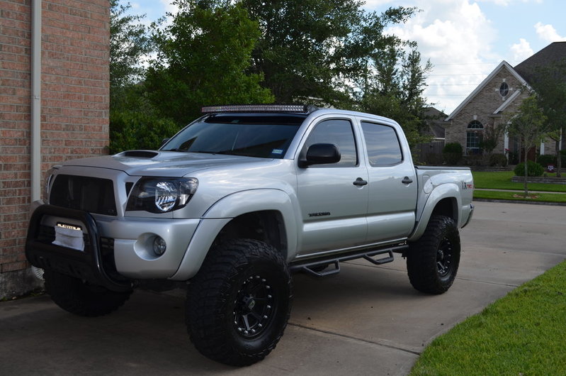

    Got it mounted. Will get pics up soon
  15. Jun 27, 2015 at 3:14 PM
    #195
    TXAggieTRD
    TXAggieTRD Well-Known Member
    Apr 19, 2013
    #102381
    1,063
    Andrew
    TX
    '11 Pre-Runner V6 TX TRD Package

    Ran it down the side of the windshield

    Set mine up the same way. Chopped only the needed part of the roof strip, and wired down the windshield weather stripping. Ran a small amount of RTV silicone between the weather stripping andthe wire, so it stays nice and tight where I want it
