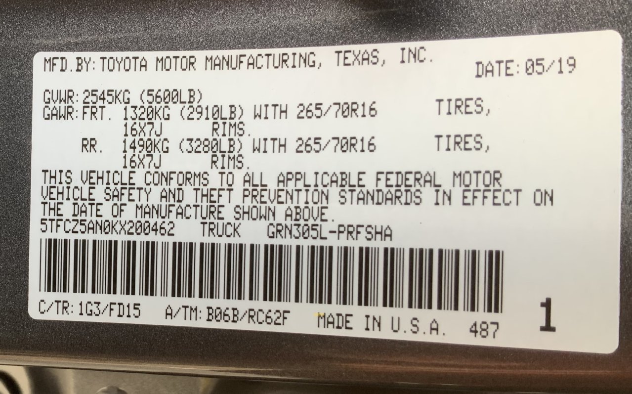

  20. Feb 25, 2020 at 5:11 PM
    #40
    Rick111
    Rick111 Well-Known Member
    Jan 12, 2020
    #315880
    122
    Rick
    2019 DCSB TRD OR 6M
    ARE Z series cap w/Bedrug
    Understand this is an old post but my Texas made TRD OR with manual transmission shows B06B. The axle is a BD22AN Hino 8.75” rear differential with an internal eLocker and 4.3:1 ratio.
