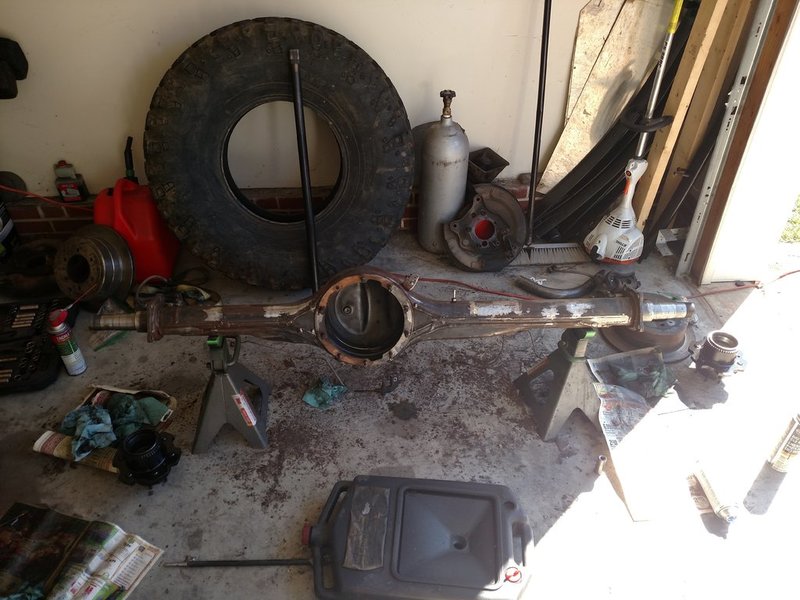

    3 hours of grinding later....

    Pro tip: leave the hub nuts or backing plate on to protect the spindle threads. Mine fell off the jackstand and I dented and cracked the threads for the spindle nut. Luckly I got it to work.

    Yeah I've dropped it a few times but luckily it was in the grass. Its a lot more manageable now that it's just a bare housing

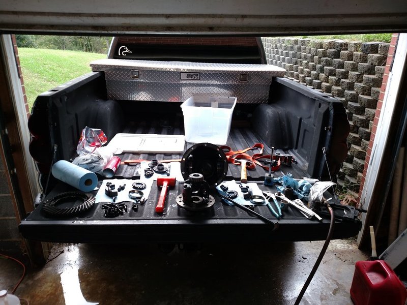

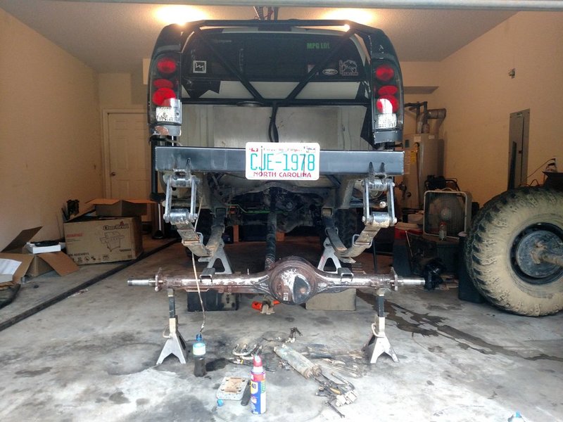

    Still chugging along on this axle swap. Figured out roughly where the perches need to go but u bolts are going to be tough to get to work with the pinion angle I want since there's a square truss on the bottom of the axle. I could notch the truss but I'm more intrigued by doing a u bolt eliminator so I'll probably go that route. Also tore the third apart today. Got the solid spacer on and preload set and it's ready to assemble and run a pattern, just ran out of time.

    I was just getting ready to post that you can just gun the ubolts down and you will be fine, the I realized you inboarded your springs... Bet you wish you didn't do that lol j/k.
    What locker did you get?
    Gear Head[OP] likes this.

    Ha yeah it would be much easier if I hadn't but it will be worth it in the end. Plus I like to do things outside the norm. I didn't get a locker, going to weld it up.
