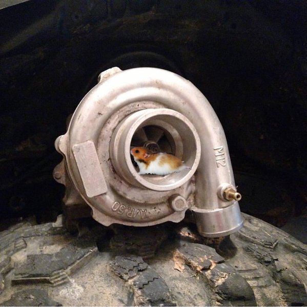

    Back to turbo, did you just find a EBay chinurbo, or that kit you posted, or what?

    Found a knockoff t3/t4 on craigslist for cheap so I snagged it. Going to use it to build and place everything then run it till it blows and replace it with a better one. This is the perfect size though

    You building your manifold?

    Haven't decided yet. Going to see what's out there but if I can't find something that places the turbo where I want it I'll just go the old log style setup
