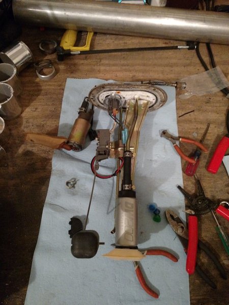

    Knocked the fuel pump out tonight. Going to leave it out of the cell for now and hope I can get in contact with the guy who was going to fix a crack in it

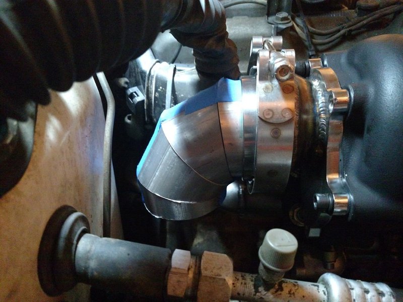

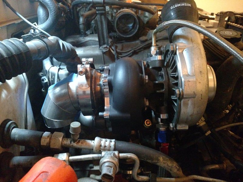

    Made some progress on the exhaust today.
    Also cut 2 45* bends for the 3" pipe and 2 90* bends for the 1.75" wastegate pipe

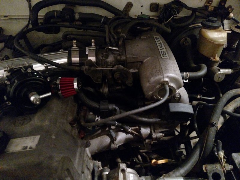

    Charge pipe is done, came out pretty sweet. The hose for air to bypass the throttle body is too short so I'll have to pick up another. Also got the check in the fuel cell repaired while we were at it

    You will be happier if you plug the fpr line into the intake manifold instead of the throttle body.

    @MadTaco461 that better? I'll have to get a "t" since that's where I was planning to hook the bov up as well

    Exactly. My bov, fpr, map sensor, and boost gauge reference from that area. You get really clean readings right there. Throttle body does some weird stuff because it gives a venturi effect.

    Nice so I'll just t off that line for the bov and the boost gauge as well

    That clogged port next to it is a 1/8 npt thread. I used that for my boost gauge and map sensor

    My aem boost sensor is 1/8 npt so I'll just thread it right in and I'll have one less vacuum line to run
