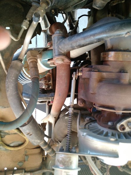

    Picture means a 1000 words. This is looking down the passenger side. You can see my wideband and upstream sensor.

    Here's what I've come up with for the downpipe. I recirculated the wastegate because I don't want to essentially have an open header at wide open throttle
