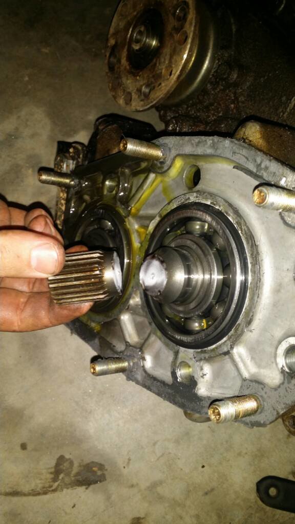

  10. Jan 18, 2016 at 3:55 PM
    #990
    Gear Head
    Gear Head [OP] Well-Known Member
    Oct 27, 2012
    #89921
    4,630
    Jacob
    Winston Salem, NC
    96 Tacoma
    fj60 front, fj80 rear, full hydro, 5.29's, welded, twin sticked 2.28/4.70 duals, 39.5's, inboarded 63's
    Surprised it last night this long..
    Mothman and Redneck92 like this.
  11. Jan 18, 2016 at 4:46 PM
    #991
    Mothman
    Mothman Well-Known Member
    Nov 9, 2013
    #116254
    3,035
    Advance
    single cab
    Low and slow.. chopped up on 35s
    df2e82aa1ff0f9ab8a1ce00e2e00da14_23b9d63c7bb105797d98428151e237d3ce19c1ff.jpg:cool:
  12. Jan 18, 2016 at 5:12 PM
    #992
    slander
    slander Honorary Crawl Boi
    May 10, 2013
    #103909
    8,964
    Hickory, NC
    02 Tacoma, fixed with curse words.
    Weld it back up and run it
    :D
    Gear Head[OP] likes this.
