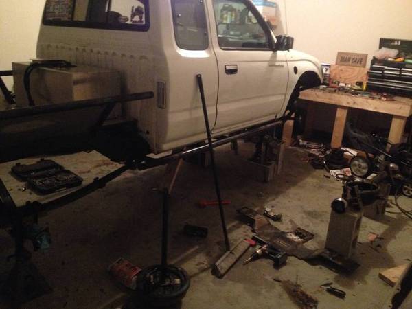

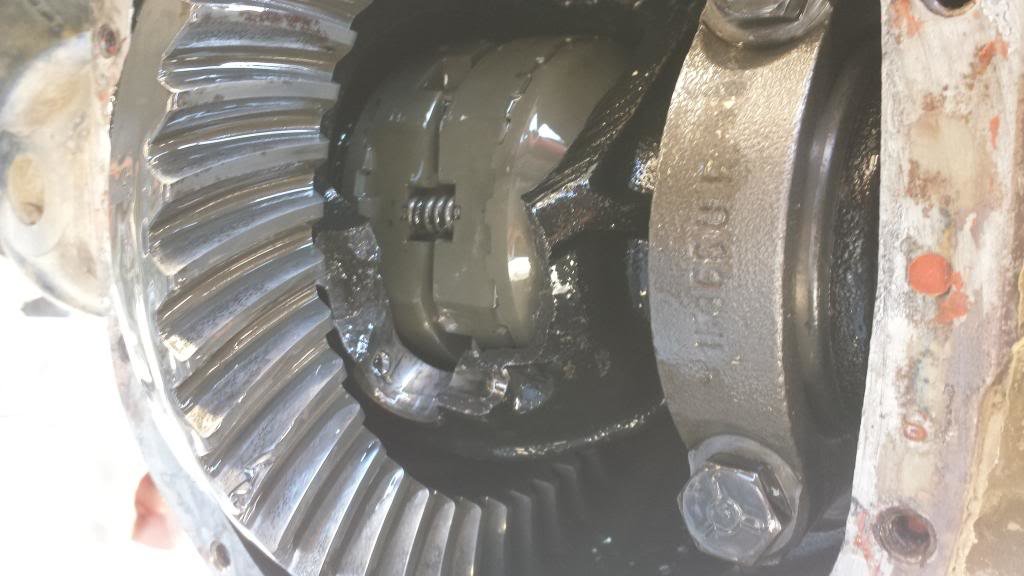

    So me being me I tore the truck down 6 days before a wheeling trip haha. I have both axles apart and both driveshafts are at Oliver's. I was told the rear was locked but the PO didn't know how so since it was on jackstands and the driveshaft was already out I pulled the shafts and third and it's a damn lunchbox locker that I'll probably blow first trip out.

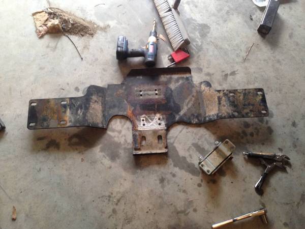

    Then I took the crossmember to my dad's to try out the plasma he just bought. Cut a "u" out of the passenger side to clear the driveshaft since this is meant to be a driver drop x member.

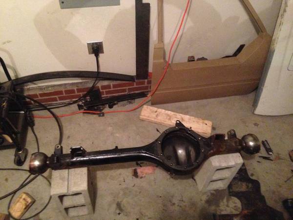

    Front axle stripped. I've got knuckleball gussets coming and I'm going to weld a nut in the steering stops and box them in. Also since nobody makes diff armor for the 9.5" I'm going to pick up some 1/4" and copy the TG armor.

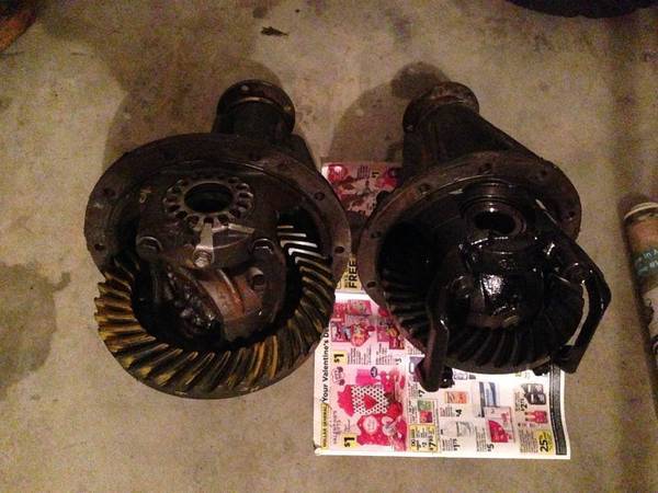

    Land Cruiser 9.5" next to the taco 8.4"
    And here's where I left off for the night. Wheeling in less than a week! :goingcrazy:

    What kind of locker you gonna go with in the rear 8.4?

    Gonna run whatever this is till it breaks. Then I'll probably go with a spool if they make one for it

    Locker looks like a powertrax locker... I had the same ones and guess what?

    Oh I'm fully aware of what's going to happen, not much I can do about it at this point besides keeping off the gas. I just hope it doesn't take out the gears when it goes. Do they make spools for the 8.4?

    Mine took the gears and the carrier. Cost me about $1000. Now it has a spool and I "shouldnt" need to worry haha.
